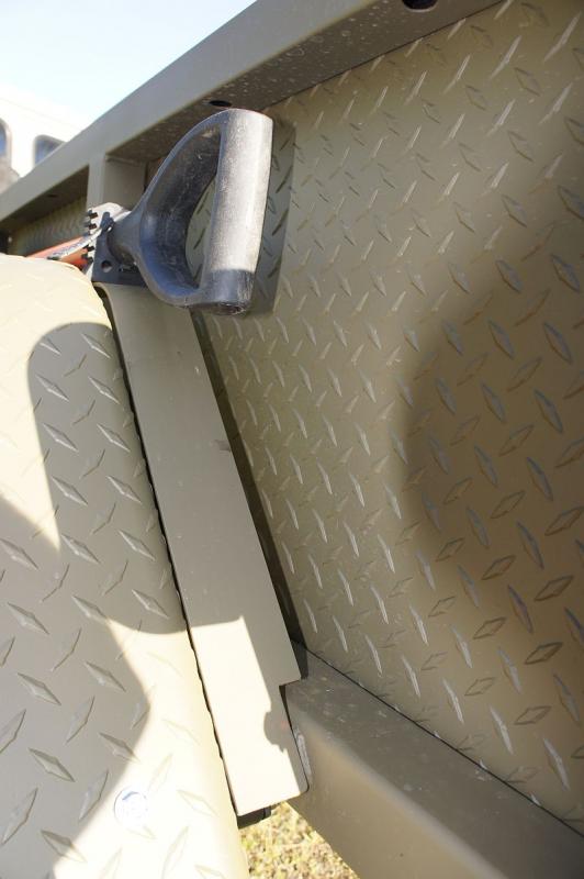

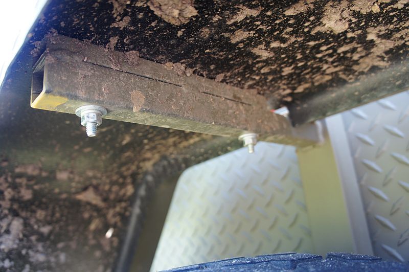

Very sharp, excellent work. I'm planning on building two trailers over the winter and will very likely plagiarizer yours, Wildyoats, and BoxRocket's builds for ideas. Do you have more pics of your fenders and how you mounted them?
I got the fenders from etrailer.com. Pretty flimsy really.. I just stubbed some 1 inch tubing off the trailer frame with some spacers added and they firmed up ok. I could put my weight on them now and not worry too much. I used 2 1/2" flat bar to help fill the gap between the fenders and trailer.
