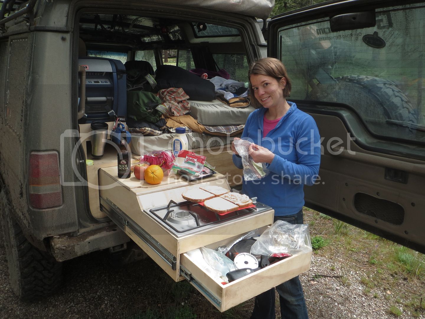

Everything but the kitchen sink

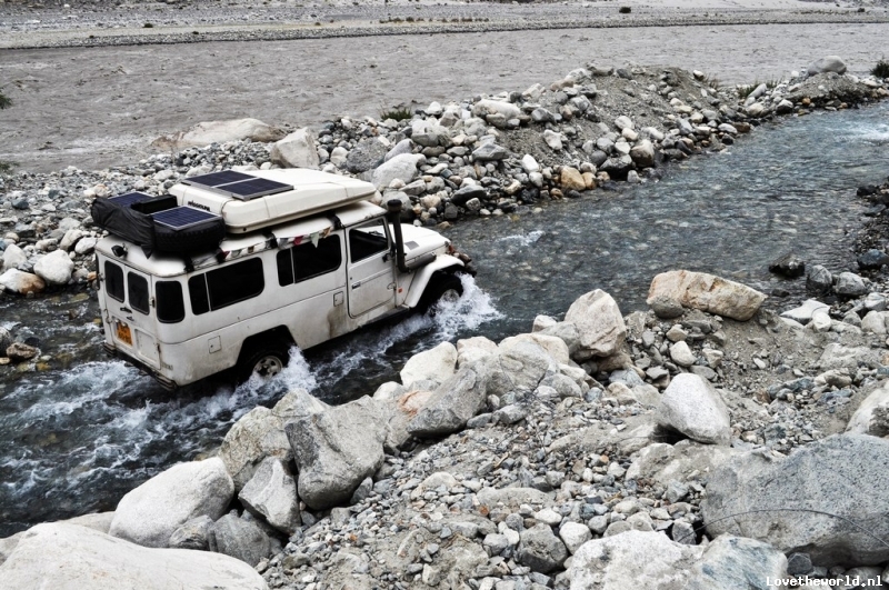

Well we did a huge roadtrip (50.000km through Asia) in a BJ45, so yes, soundproofing is an issue :D
I think you need to take care of both sides of the metal.
There is also the issue that the construction of the front window and front doors isn't that great. It works and it is easy to fold it down and turn it into a convertible. But the downside is that after aging and use, it never really closes that nicely. So you can hear the wind while driving.
Also you shouldn't put any roofrack on the roof where the front window and front doors are. Only on the back where it is straight, otherwise you will (slowly) destroy the front part. Unless of course you made some kind of tubing connected to the chassis.
Just for inspiration, we travelled like this on a 45 with a rooftent, and still no weight on the front part of the roof. (which was the case for the old roofrack when we got it, and we removed that)
But the 45 is actually like 120" wheelbase I think, so it is 20" longer.
