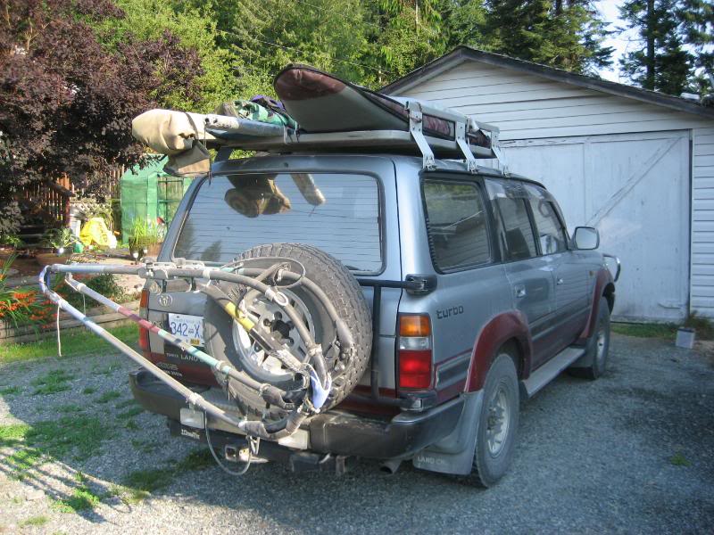

Anyways back to regular programming,:p first road trip to nitinat went rather well...nice being able to do 60 on those roads and still carry on a conversation..
Course it was absolutely crazy busy at the lake, ( seriously , no parking anywhere...reminds me why I tended to avoid that place in august..)and not windy, so we just carried on up to china creek, port alberni, and back home.
First modification to the 80? Hack the front and rear parts of the "basket" rack off so the thing doens't howl like a banshee, and boards etc can sit on the flat deck, makes them fit on there a bit better...
And funny, I was going to get rid of the Bike Rack on the back, but turns out it's actually usefull...And just cuz I was already outside taking pics of s*** ....at least it's dusty now, and got it's first dose of black and white dog hair...:lol:
