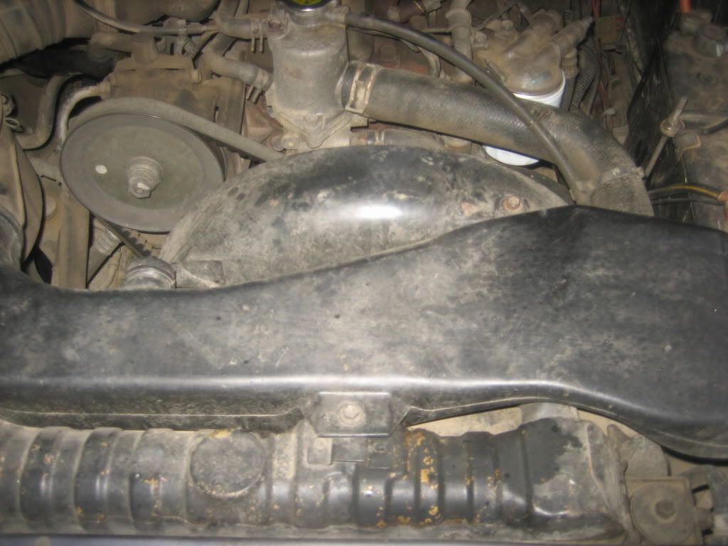

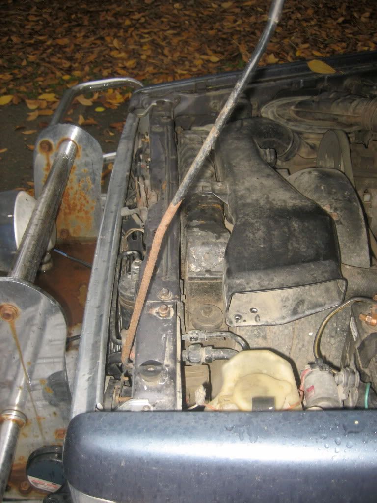

I was looking at the rad on the 74 yesterday and I notice the fan shroud is a mile long, how hard would it be to just relocate the stock rad back 10cm and then fit everything else back in behind the grill, so that nothing has to protrude out front? Mind you I still have my huge s***ty stock bumper, I'm sure i could install an air-air out in front of the grill:hillbilly:, but it would look nasty, and would probably make the winch harder to use...
i just ran out and had another look, I can see why it might be hard to move the radiator back. The fan is off center from the rad and the shroud has a specific shape (to direct airflow to the fan), if you move back the rad, you'd have to make a custom shroud, or center the rad on the fan (move the rad towards the passenger side (RHD)).
I took some photos.
http://i1223.photobucket.com/albums/dd502/melano540/IMG_0144.jpg
http://i1223.photobucket.com/albums/dd502/melano540/IMG_0145.jpg

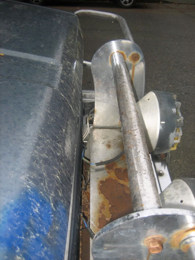

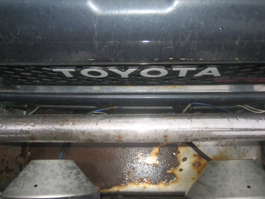

There definitely is potential for an "out of grill" inter-cooler placement, wouldn't obstruct winch use, but would be useless in slow moving conditions because there would be no air pull from the fan and would rely on forward motion to get air flow (great for highway travel).
http://i1223.photobucket.com/albums/dd502/melano540/IMG_0141.jpg
http://i1223.photobucket.com/albums/dd502/melano540/IMG_0140.jpg
