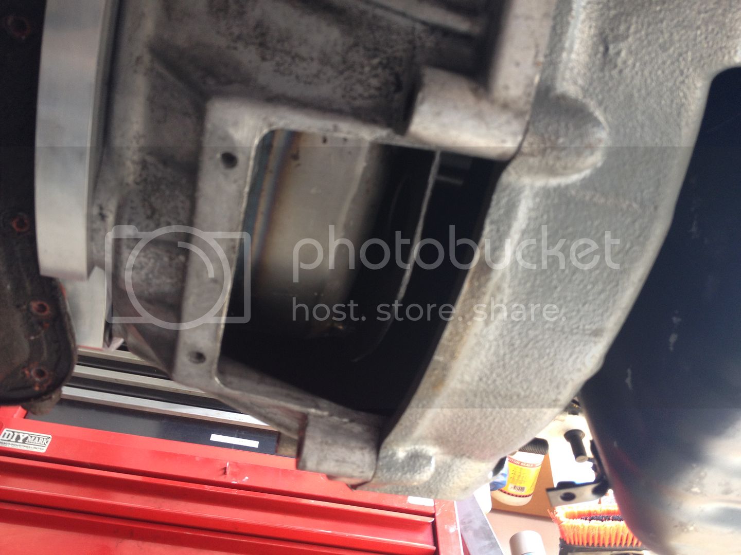

Ok so the adapter is done for the most part. Just some final adjustments of some depths. Today we bolted it together though and it seemed to go together well. The hole for the converter pilot needs to be opened just a touch and the holes for the socket head bolts opened slightly.
Tomorrow AM we will test fit again with the changes made. From there if its all good I can get a move on and get this thing going. I have 3 weeks to get it mobile so I can get it out of my dads shop since he needs the hoist. I also leave in 3 weeks before a month working out of province. So would like to get it going before I go.
More updates with pictures tomorrow.
...via IH8MUD app

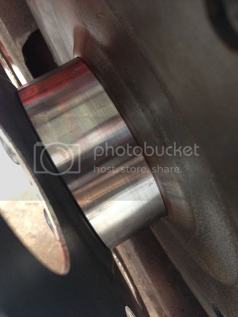

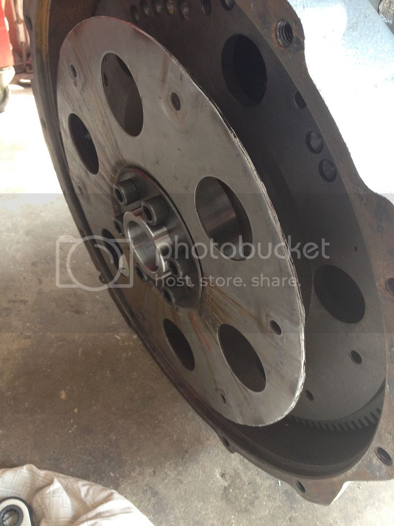

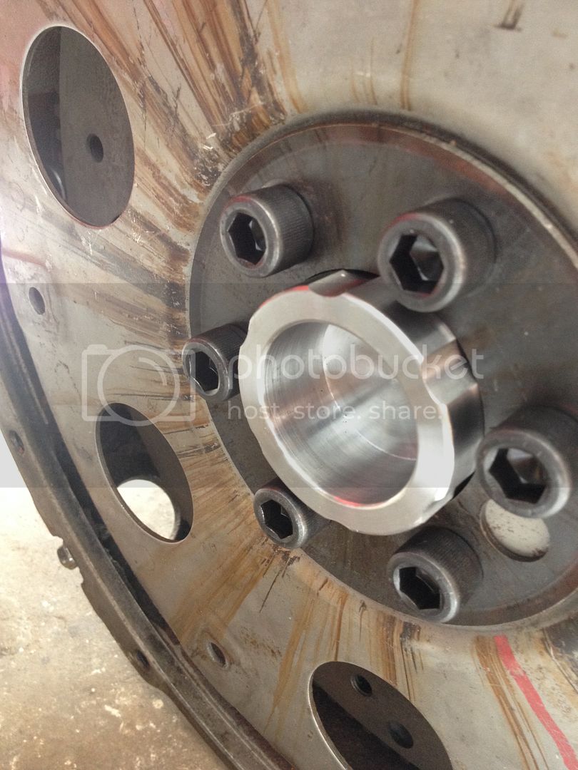

Adapter has had its final test fit and it seems to fit very well now. We made a few last min changes but it fits much better. Everything slides together with ease but precision no slop anywhere. Im waiting on one more crank bolt I should have tomorrow then Ill be hopefully bolting it all together for final time.
Converter bolted to modified flex plate.
Adapter hub bolted to Isuzu flywheel/crank.

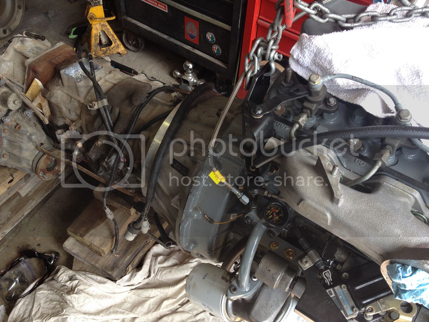

Hope to get the rear main seal swapped out tomorrow night and the converter input seal on the trans swapped too. Once thats done I plan to fill and install the modified converter. Then bolt the two together.

The Viscus transfer case has been removed and drained from my A343 transmission and is ready to have the EBI 3:1 low range gears put in then bolted to the A440, nice thing with using the newer Tcase with a440 is my stock driveshafts will be used.
Think should move fairly fast now, 95% of the fab work is done just a few small details left to work out. Mainly trans cooler lines, bypass filter and cooler mounting. Last will be exhaust.

Awesome! So happy to see this! I'm right behind ya :-) My flex plate adapter looks just like yours. How precisely did you cut off the ring gear? I was planning to do it in a lathe or on a rotary table but a bandsaw sure would be quicker :-)

Cutting off that gear was a pain in the ass. I actually want to get another one and see if there is a better way of doing it. As it sits it will work but it chattered like mad on the laithe and resulted in a poor quality cut.

My engine is out of an automatic NPR this is the flywheel they have. Have a feeling there diffrent thicknesses looking at your pictures.
Yes they must be more different than I thought. Looks like accessing the torque converter bolts on yours should all be fine.
I'm wondering if bolting the flex plate to a rotary table and cutting it might work. I'm worried about the rigidity of that when trying to cut it. I also wondered about bolting it up to the torque converter and mounting the whole mess in the lathe to cut it.

Will be interesting to see if the de-ringeared flex plate will take the torque without distorting... I would have thought the ringear would add some rigidity, tho it may not be critical...

Yeah Im actually trying to get a stock flex plate to see if I can make it work with that. If not Ill see how this trimmed one goes.
