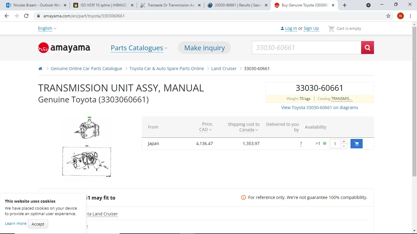

Looks like Japan still has 'em; but certainly not cheap! Rebuild might be the best option, as these are so sought after and folks that have spares usually aren't willing to let them go. Or look around for a rusted out cheap HJ60 to yank one from? Good luck with this; what a drag.

Ya it's about 5 to 6g for a a new one. 4500 with parts and rebuild.

.!?!? Try about $2500 US from Cruiser outfitters or Valley Hybrids
Shipping probably makes up the rest. It's brutal from those guys lately.
There's no universe where it should cost less to send a 10 lb lump all the way from australia than it does from utah.
