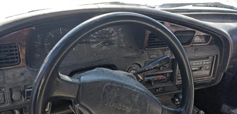

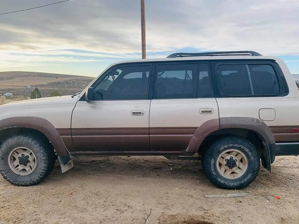

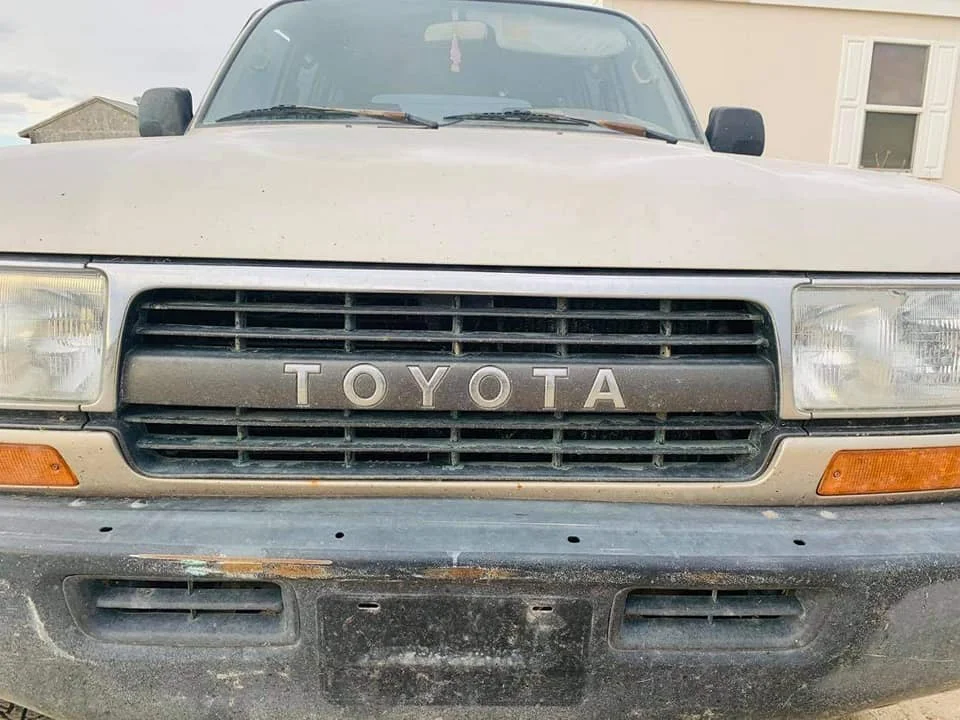

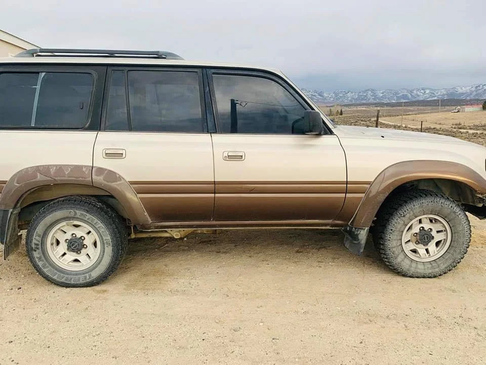

Hey guys, I started lurking here because I've been thinking of getting into an 80 series. My previous experience has been with FJ40s, but I've always like the 80 series. So I don't know much about these but how hard can it be right? :cautious:
This one is a 1991 FJ80. It's somewhat near me and cheapest I can get to dip my toes into the 80 series. I know it's not the later more desirable FZJ80s but they're still pretty good I think.
Price is $1000 because of all the work it needs.
From owner, I know it needs:

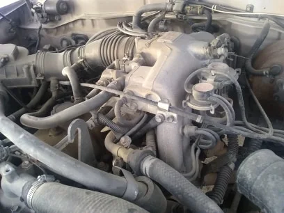

  • it does need engine work (possibly full rebuild)...
  • oil dipstick suggests bad head gasket...
  • was told front differential needs work as it has back lash,
  • gauge fuse keeps blowing was told it caused by a bad oil pressure switch (have new one, just haven't put it in)...
  • it needs quite a bit of work to make it driveable but the body is solid, only rust I've seen is on the bumper...
  • needs new catalytic converter, water pump and windshield...

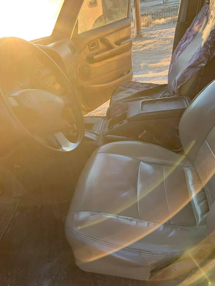

  • cosmetic work like reupholster seats and paint...
  • bracket one of the back seats needs replaced
  • brakeline near passenger rear wheel has a leak...
Is this too much and going to cost me too much in repairs to make it feasible? I know these things are getting up there in cost and not going down anytime soon, but should I still be ok after putting in the work to get it baselined? Or am I letting my heart think I can still get into this vehicle?

You’ll get good feedback.
It’s been well used. It is what it is and you seem to understand that. A rust free body outta be worth that all day long. If you’re capable of doing most of the work yourself, you should be able to get out of it what you put into it starting at that price. For $10K you could have a pretty nice rig and a good value. Also, need to consider how you plan to use it and what kind of vision you have for it. Good luck and welcome to the 80 forum from an 80 newbie. The wealth of knowledge and experience is off the charts here....
Minor point, but that “bad bracket” on the third row seat might just be the extension lever (which folds out the bracket that latches to the floor) unclipped. Fold the seat up to the side and see if it is hanging loose. My first lc had that issue when I bought it from a dealer - was a 10 sec fix

Unless you can live with it like it is long term the largest repair/cost that I see (in time and/or $) is the paint work. After that in terms of spend will be the cumulative maintenance items and relatively smallrepairs that will be needed it you want it to be back to 100% in terms of operation and reliability. As mentioned these quickly add up to thousands of bucks even for DIY and relatively tight 80s. Finally, the engine costs could be major but it also sounds like you may be able to wait and hunt for a replacement engine that you possibly just reseal/tune and install to save $. I don't know what they go for but assume that it isn't more than a few k for a replacement engine if you have time to shop. You should cruise the classifieds here to see if you can find any examples and possibly call your local parts yards to see if you can find one if it's a big factor in your buying decision.

I have a 40 series ’73 frame, ‘78 axles, and a ‘78 donor 2F (in negotiations) sitting in my garage right now with $1000 invested. They will sit until a body appears from the cruiser Gods. If I haven’t been clear, $1000 is chump change if the frame is straight and it’s rust free. Carpet looks to use a good pressure washing and a junk yard V8 would keep you under budget for fun If the 3FE isn’t up to speed.
If you haven't owned a 3F-E powered truck, you may find that it's still a real dog when you're done with it. To me, that truck looks 'used up' rather than 'used'. I would part it, or avoid it. How many miles are on it? If you want a trail truck, as mentioned, maybe this is it, but I don't see trying to bring this one back to its original glory.
