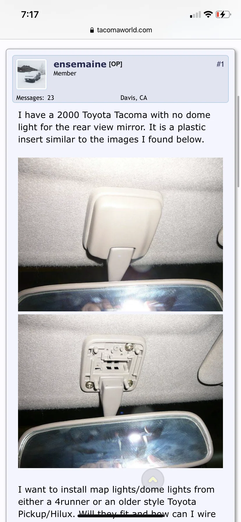

Is this as simple as I think it could be?
Aug 25, 2015
80
1,385
Northern Virginia
1st gen mirror (mine)
2000 Tacoma mirror

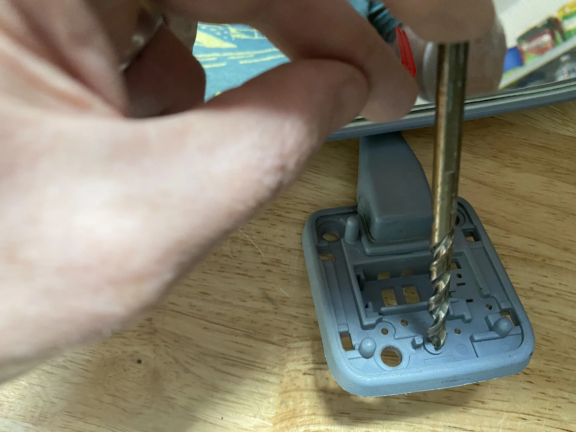

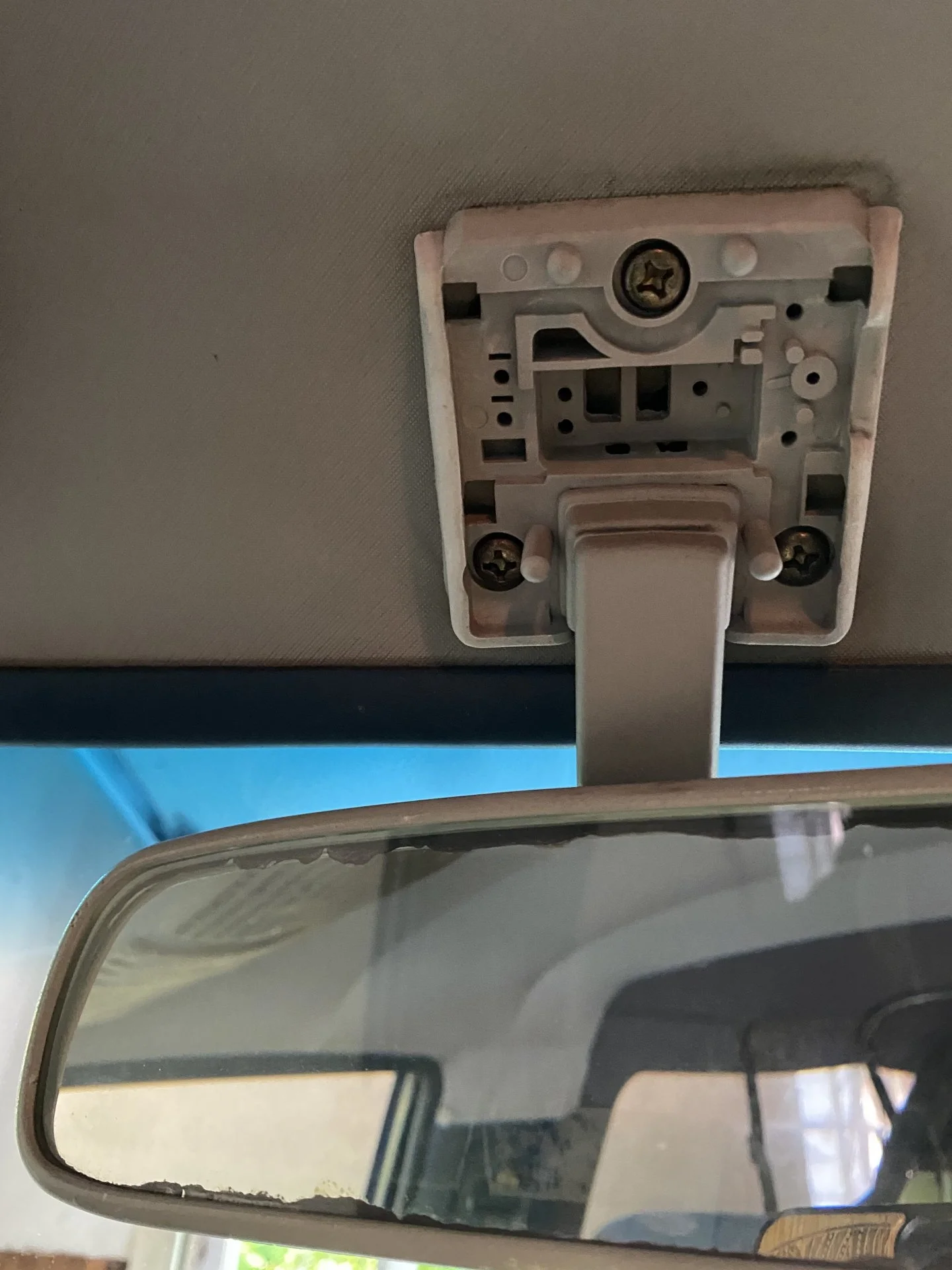

Is it as simple as drilling a middle hole and Shazam ?
I suspect you are sailing uncharted waters. Let us know if it works.
98 4Runner Rear View write up:

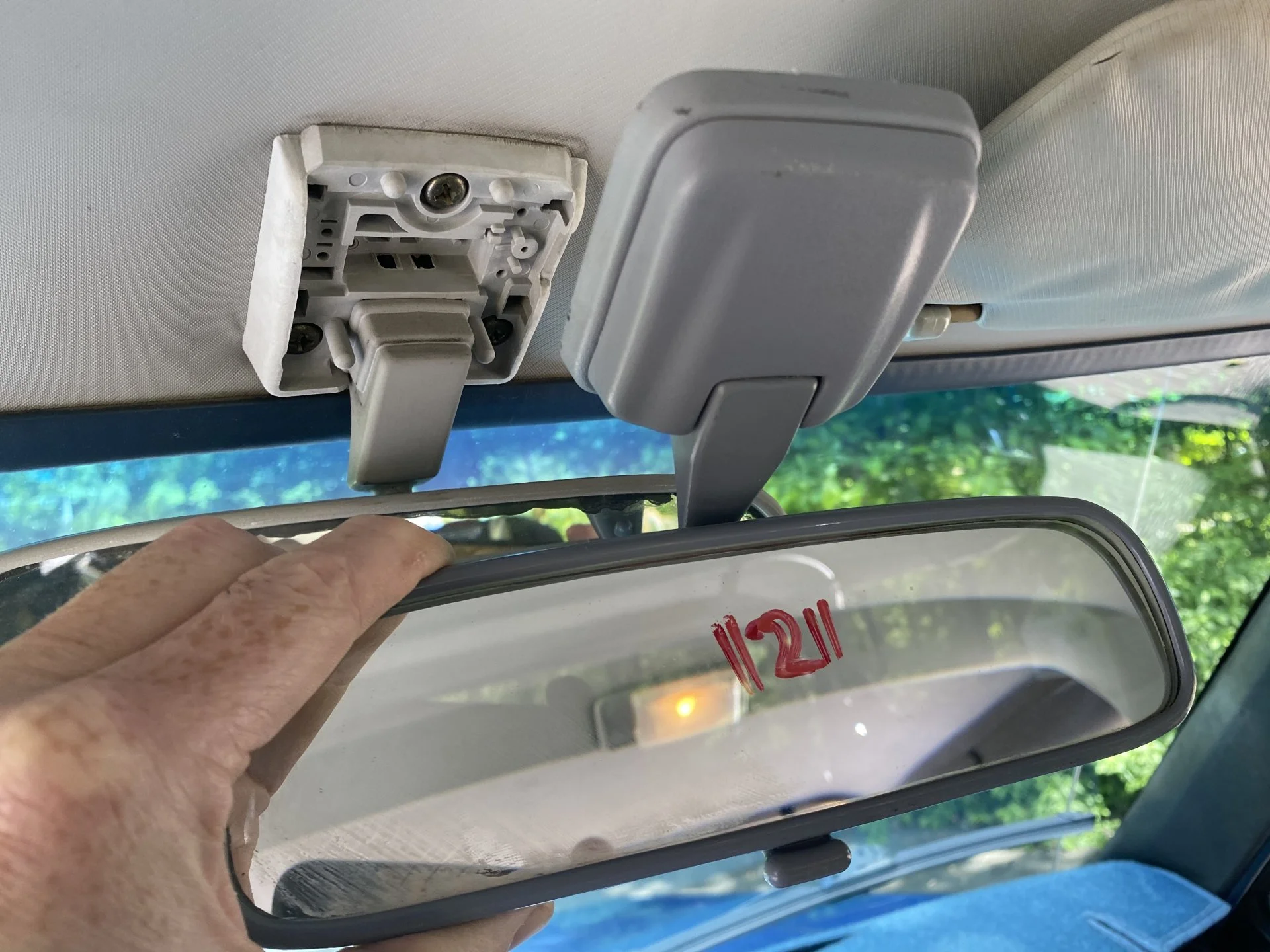

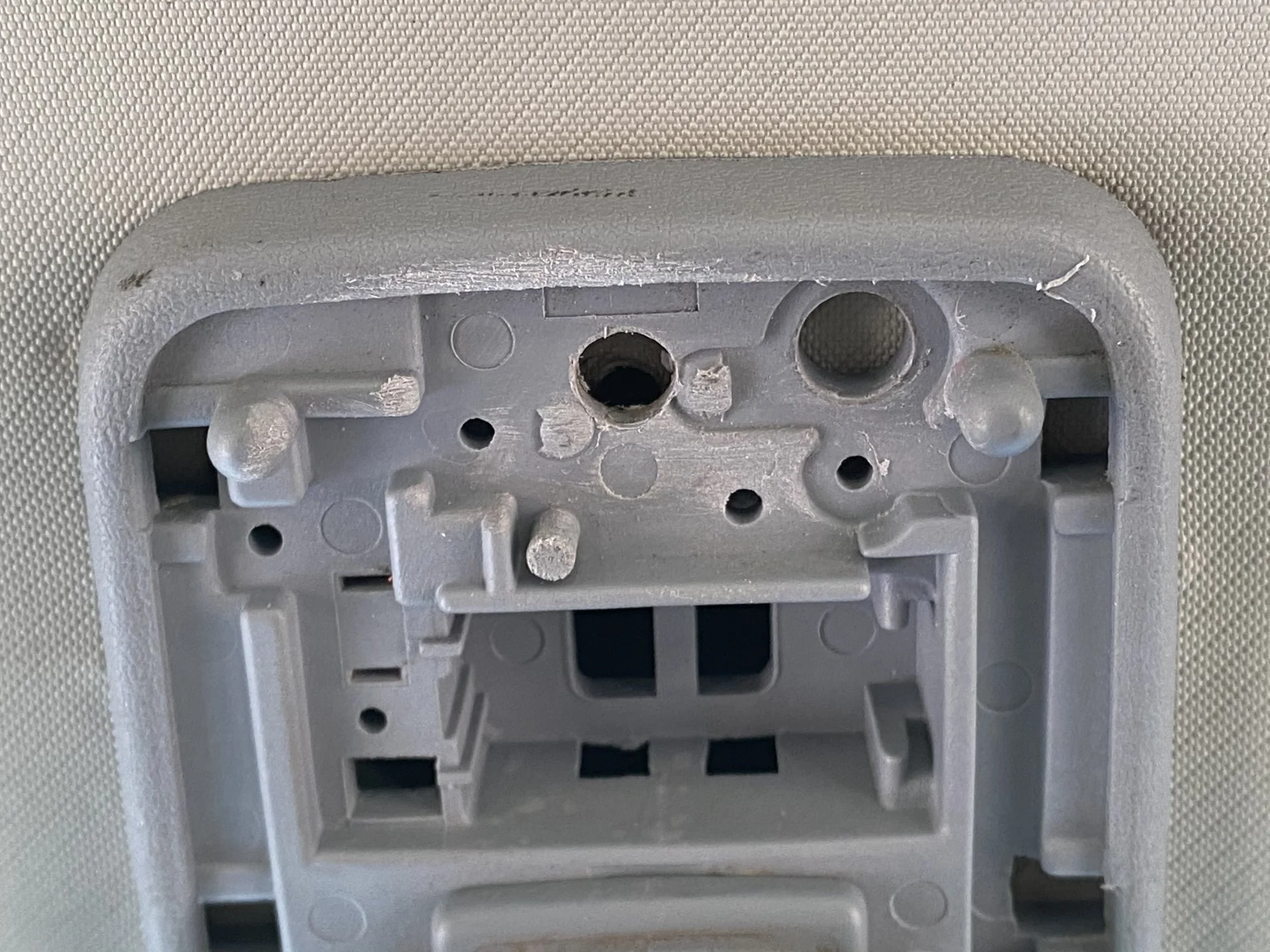

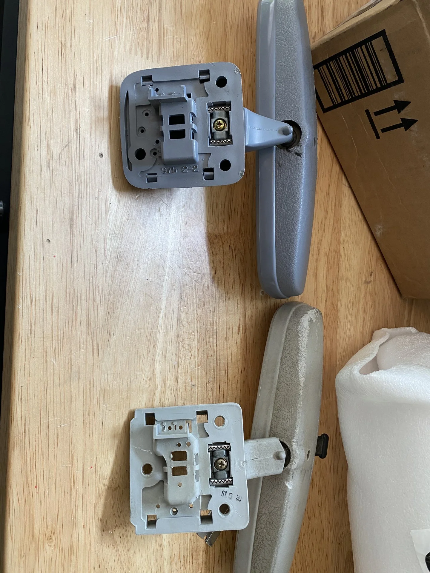

As suspected ... this works pretty well.

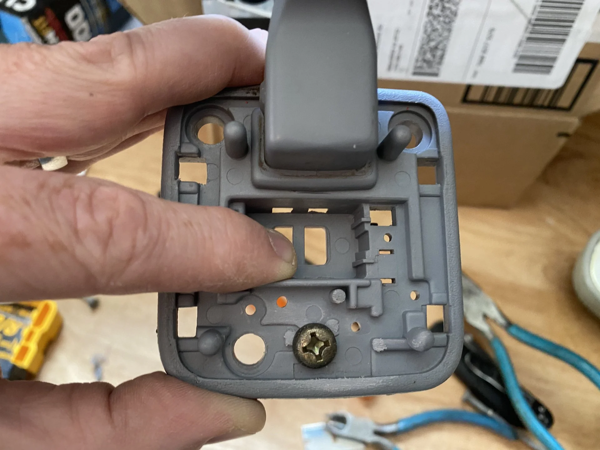

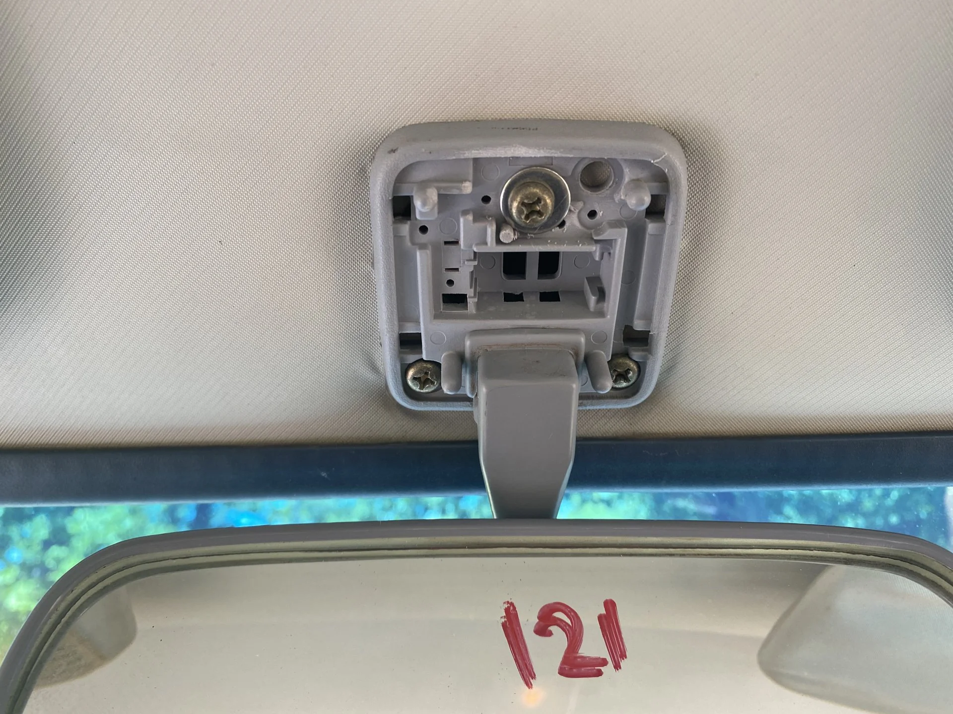

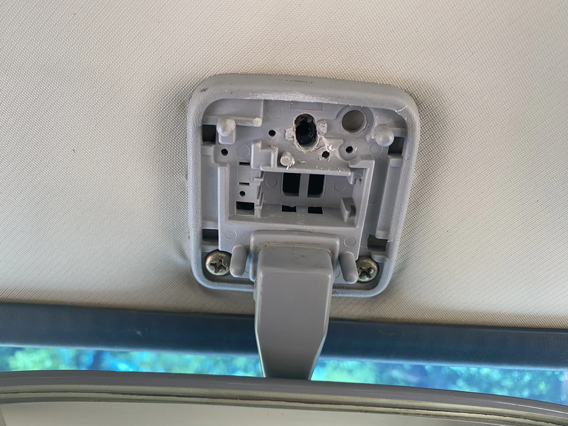

The screw holes are pretty close... 2” on center. The front screw hole is not centered on newer mount. It is off to side. The mount cover IS NOT a direct fit. Close, but no cigar.

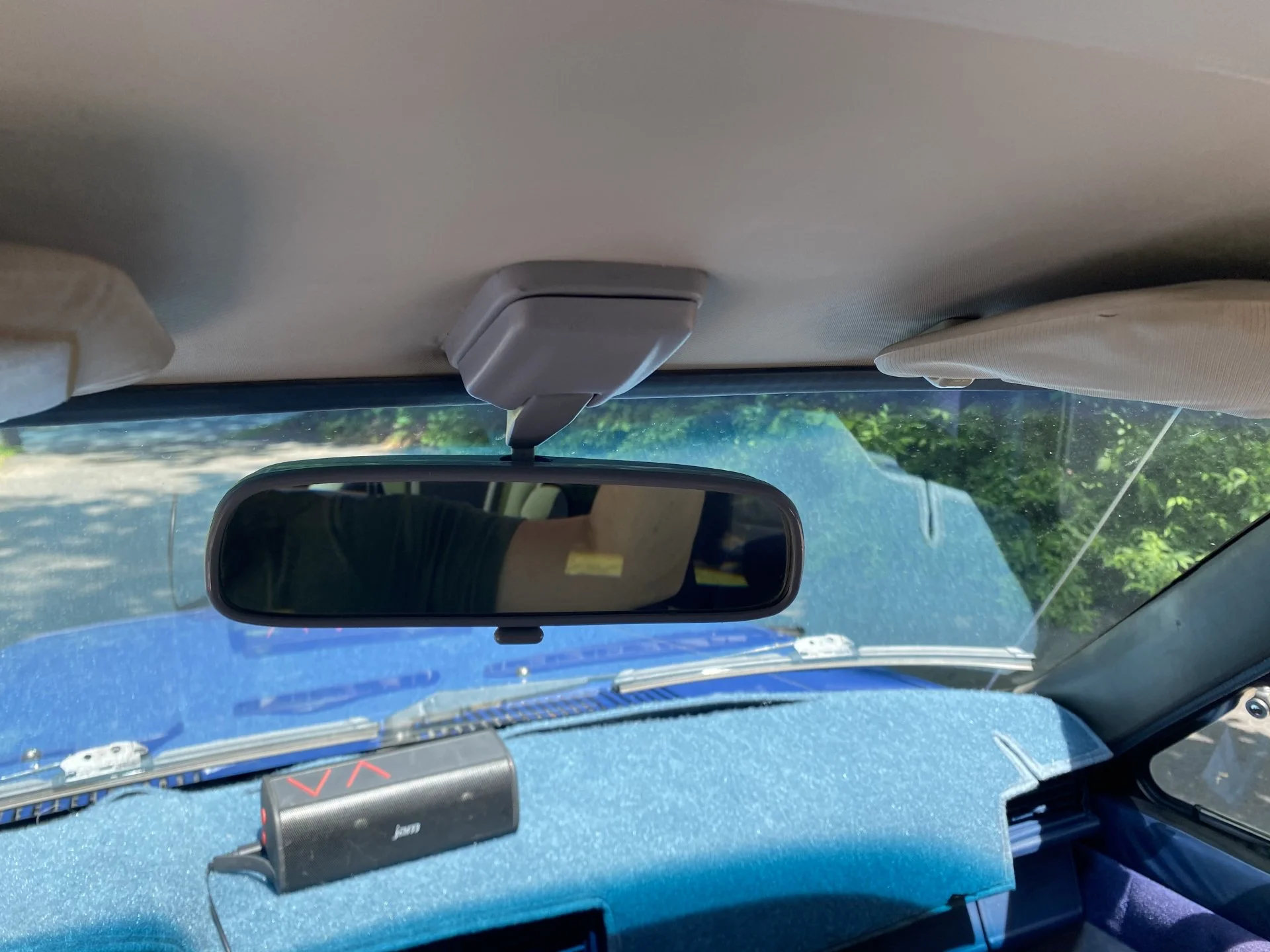

I just fixed it by widening the hole a smidge and adding a washer. Cleaned it up. Looks and works great.
The color is not grey but a light blue. Looks fine for now but I may correct that down the road. It looks better than my old dying mirror though.
