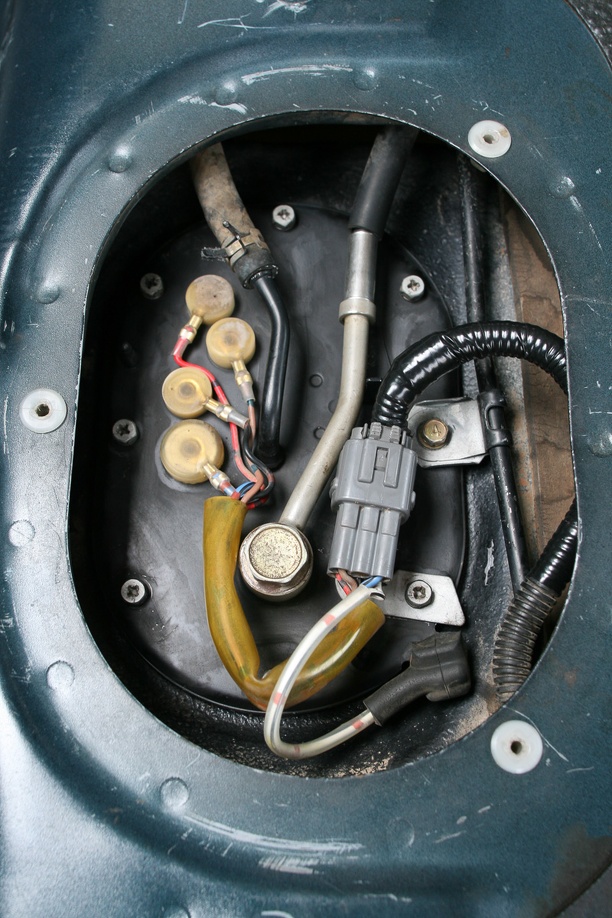

Is this an original fuel pump?
Apr 14, 2016
41
2,448
Oregon
I'm curious if this is likely to be an original fuel pump. It's the one I pulled from my '94 with 254k miles. I can't tell what the stylized logo says.
I'm guessing the pump may have been changed at some point, since the bolt heads are pretty deformed:
Screw, w/washer, 90159-50219
I had to replace all (8) of mine because someone (likely related to your mechanic) insisted on using a Phillips screwdriver instead of a JIS+, or an 8-mm socket.
I wish mine was that clean, before I removed everything.
Yeah, I don't know what the story is with those screws. I don't know the vehicle's history before March of this year. The pump seems to be likely an original, yet the screw heads are pretty marred up. Plus, one of them is a standard bolt head, no JIS cross-head on it. Weird.
Oh, and it was completely coated in dust when I first opened it. That was after using the shop vac, a paint brush (to dislodge dirt), and lots of compressed air!
