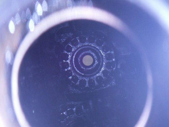

Third, my inner birfs look fine I guess, but after cleaning I noticed there is a burnt looking circle about every inch around the outside of the ball. I didn't see this in any of the photos in the FAQ or elsewhere. The marks did not come off by soaking in cleaner (fuel equivelent, but less flammable). Should I try to remove these marks? If so, how? I can't feel them, I can just see them. If it matters, my birf soup was not as bad as some photos I've seen here on mud, but it was pretty soupy. First pic below is the PS, but the DS was about the same. The burnt looking marks are on both Birfs and look identical - almost factory
