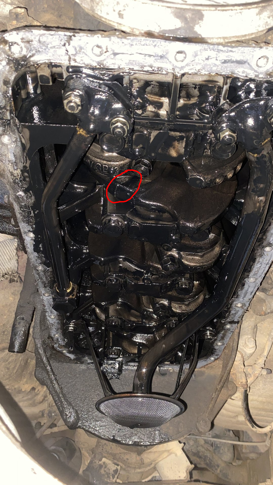

Can you hear it more in this video? It's very noticeable in person. I've pulled the pan, will look more into it all tomorrow.
Very bad timing with my plans for a trip to Montana, glad it happened now vs on the trip
With the pan off, can you feel any abnormal play? See anything odd in the engine or in the pan?
It is unlikely that there was anything in the oil either? [other than expected high level of carbon]

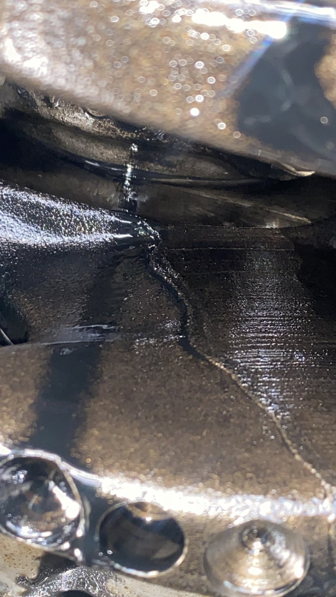

I’m so shocked. I have no idea how that would crack that bad. Not impressed.
This is one of many 3B's with turbos added that have broken cranks on this forum. There is a theory that folks should be retarding the injection timing a bit to reduce stress at the crank. Turbo heat/pressure means diesel ignites faster after injection I think? Sort of like pre-ignition in a gas engine. Very hard on everything when pressures are too high too early.
My computer controlled 2LTE pulls a ton of timing when the air intake temps get hot. When cold, it pulls hard though. Toyota clearly recognizes this is an issue. 3B would have had timing specs based on normally aspirated function, not turbo.
If I had a turbo 3B, I'd pull timing back a bit just in case.
I did, about 11 degrees if I recall. Probably helped but I guess not enough... Good information though for anyone who might be wanting to turbo a 3B in the future
Wow, interesting. I wonder if the cranks just can't take the power, or maybe timing needs to be pulled even more (ideally just at high loads).
