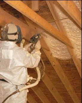

To me that means vapor is an issue with closed cell foam. In the climate hear in Wyoming and N. Colorado, water vapor is not an issue if you have some sort of roof vent.
I have become sold on closed cell foam insulation. I used it in my cabin, which is at about 10,000 feet and has about 12 feet of snow around it now. I have 2 vents on the eaves only and I have never had a problem with vapor. It stays nice and toasty and dry in there for the 5 years it's been up.

If you use a permeable insulation that is true. With 2" of closed cell, there is no permeance so you want no air flow.
I forgot to mention before that there is "paint" that can be applied to the underside of the foam that acts as a fire barrier.

I've been drinking but I'll give it a shot. Roofs are never completely water tight especially when comp shingles and felt are used, this is not an issue when adequate ventilation is provided as the evaporative effects compensate for any any leaks, interior sources or solar driven moisture occur. Hot roofs or conditioned attics are less likely to fail when vapor impermeable underlayments and waterproofing practices are used but the practice still relies on complete faith on the roofing contractor.
Moisture moves from hot to cold.... always. Insulation on the warm side of the sheathing keeps it within the dew point for greater time periods of the year without opportunities to dry to the inside. You will need to pay special attention to complete air sealing which is difficult as air is a huge transportation method for moisture.
I have seen tons of flat roofs fail as well as vaulted ceilings with vapor barriers, as long as temperature levels from inside to outside have the capacity to be warmer and cooler than their counterparts throughout the year moisture will will transfer from both sides. The goal is to prevent impermeable surfaces within the assembly for vapor to condense, closed cell spray foam is not preferable in this application.

Before I conditioned my attic, I talked several times with the iso spray group because I was going to use foam boards under the sheathing along with spray to complete the seal.
I believe the people when they said you could never get a complete enough seal.
Unless you are facing an inspection for R value, the effective insulation is higher than the thickness of the foam.
I went down in calculated insulation but my heat bill was up to a $100 less a month than last year when it was a lot milder winter.
The conclusion is that yes, closed cell spray foam can be used on the backside of roof sheathing in cold climates as long as you have dark colored roofing material, a completely watertight roofing membrane and you complete air sealing from the interior to attic space.
Too many variables and potential failures IMO, especially in a retrofit scenario.
who's conclusion?
It was very easy to seal. The foam does the sealing.
I used eps to stuff the eaves. the ridge had screening. As long as you spray so no wood shows from the roof, you are sealed. Far more sealed than the batting covering the ceiling and truss lower member

Who are you arguing with? I said that it's probably ok to use closed cell foam in cold climates as long as you control every single variable, sounds like you're quite sure you did. I only added that I personally did not feel comfortable with it but that's just me and my 15 years of industry experience plus SBA, LEED and RESNET energy modeling accreditation. There's better ways to air seal and insulate a home's roof, I certainly wouldn't advocate for batts.
Foam is great when used in the right spots. You can't just trust the foam guy btw, he sells the foam.
