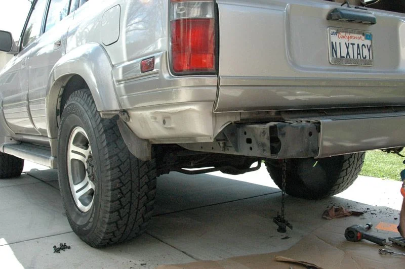

I then need to give HUUUUUUUGE props to SPIKE STRIP for letting me use his tools and his driveway to help me install this thing. With his help we had the old bumper and tire carrier off and the new bumper and tire carrier on in less than 90 minutes!!!!

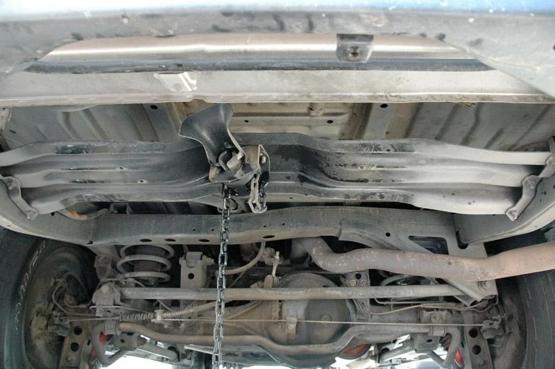

The tear-down was pretty easy especially since we used air tools. Just figuring out which bolts to remove and then just disassembling the rear bumper and then removing the tire carrier cross-member. I was REALLY surprised at how little there really was to the bumper.
OH! and just so you guys know..... THIS is what a well maintained CALIF truck looks like under the chassis :flipoff2:

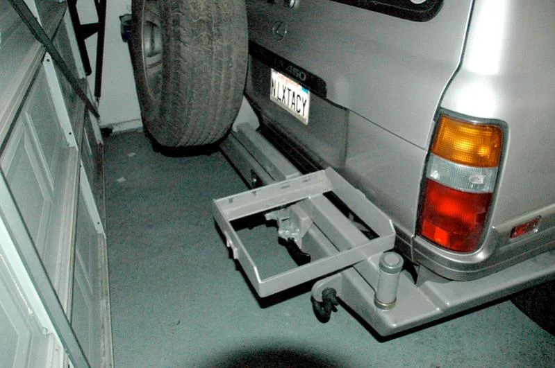

So this is how it sits in my garage. BARELY clearing the garage door. Tire sits a nice distance from the tailgate and the overall fit and finish is really top notch. IPOR kicks ass :cheers:

Third question, where the bumper meets the frame there are two threaded bolts into the frame. Well there is a 1/4" space in there that when we were installing it, that space was acting as a void and was making the metal of the bumper start to twist to fill that gap as the bolts were tightened. Is there supposed to be a spacer in there? What did you use?
There is supposed to be a washer between the frame and bumper there to level out the gap.

I was actually going to use washers but wasn't sure if maybe there was a special plate that is supposed to go in there. Do you know off hand what size washers so I don't have to go down and measure?

Our hardware kit is supposed to include several washers that are used to level the wings as well as back the frame mount at this gap. The bumpers are laser cut, CNC bent and assembled in a jig, but very minor variations at the frame mount can be 1/4" gaps at the end of the wing - thus the spacers.
