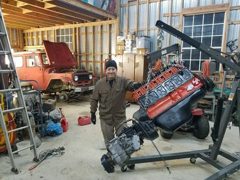

Some updates... I bought a second one last summer, a guy's frame-off restoration project he had to sell. The price was right, and engine, trans, xfer, & axles had all been rebuilt already, and it came with a lot of boxes of parts, restored/recovered seats, new soft top, new rims, new tires, spare doors, etc, etc...

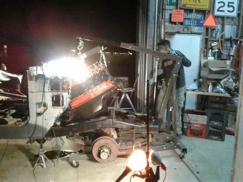

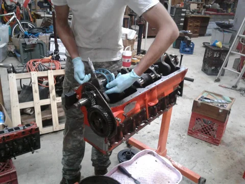

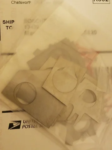

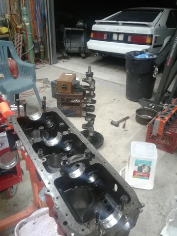

The seller said there was an issue with the wrong spacers under the crank main bearing caps, and the engine felt nearly seized, so my friend and I disassembled it to check all the specs, cranks journals, tope end, everything. It's just about perfect, but it looks like axle grease was used instead of assembly grease and indeed the crank main caps need thicker shims. Those things are hard to find (only F had them, 2F didn't)... Toyota has them listed as parts, but they've been discontinued for probably 10 yrs. Fortunately, SOR has reproductions of them, and I received them yesterday, along with a gasket kit, so it's almost time to put the power mill back together. Then on to the body, I plan to do a complete frame off and paint job in the original Freeborn red (adiós patina). So it's coming right along...

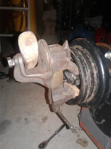

That 46 mm crank nut was interesting, I didn't know that the FJ40 could be started with a hand crank :-D (I've since bought a 46mm socket in preparation for reassembly http://smile.amazon.com/dp/B01N0NP5TV/?tag=ihco-20

Crank main bearing shims. If these reproductions weren't available, I'd be sanding down the bearings!

If only Toyota had them :-;
