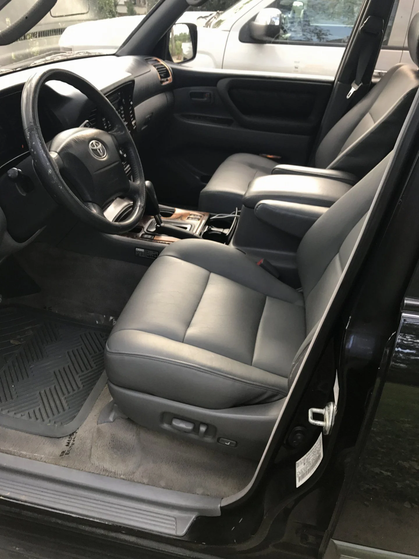

This week I finally got my first Land Cruiser. After looking for several weeks, I discovered a 2001 Land cruiser with 188k miles. It is a southern SUV so the frame was in good condition with no rust. The vehicle drives very well and solid and look forward to many excursions with the family. The interior is in very good condition with some of the best leather seats I have seen on one of this age. It made me wonder if the grey leather holds up better than the tan leather that I saw in most of the ones I looked at. Exterior is in decent condition for its age with main issue being some hail damage and minor scratches. Was able to get it for $7500 which seemed like a decent price.

Nice...and someone replaced the seat covers for you.

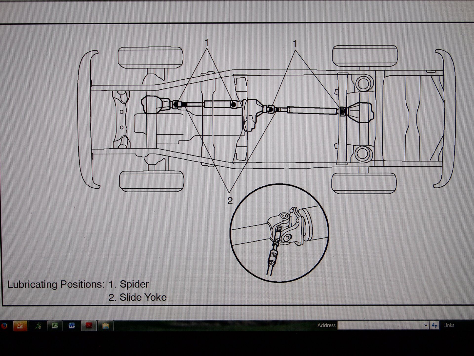

Ask them what they are talking about. Drive shafts they may be speaking of lubing the propeller shafts slip yokes and spider joints (AKA U-joints). There are 6 grease zerks in total, use caution on slip joint as pressure can really build in joint as seal may still be very tight.

The drive train and axle service probably entails greasing all the zerks and servicing/repacking the front wheel bearings.
