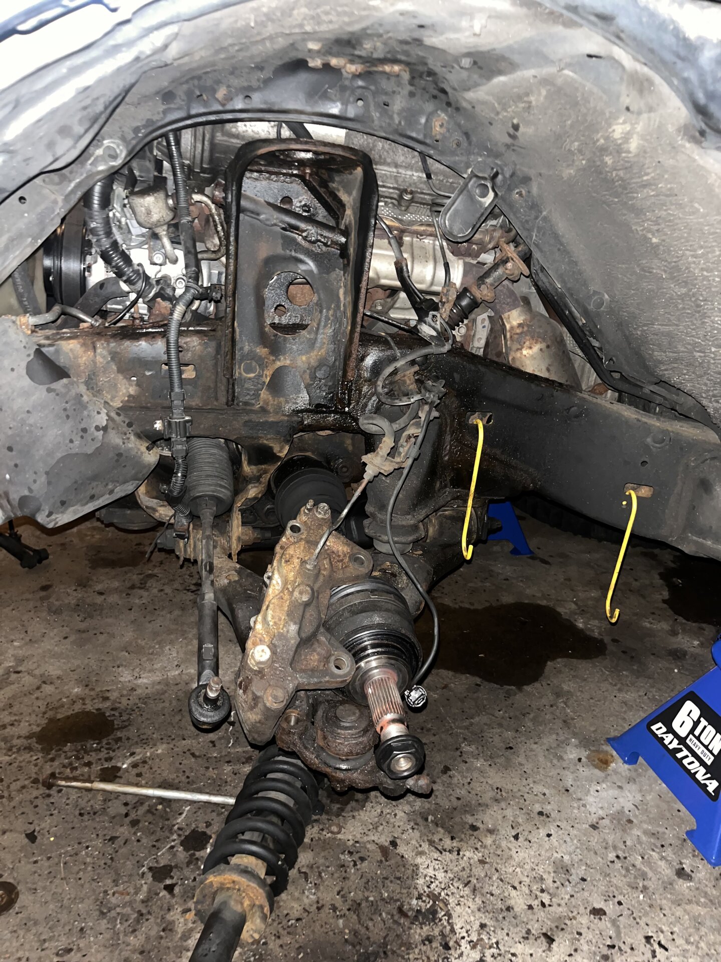

After more finagling with other "rusted welded" bolts, nuts, castle nuts on the driver side, I caved in & ordered a used steering knuckle off eBay. It was in excellent condition and came off an 04 with 227k miles with very little rust if any. Thats how I found out my wheel bearing was also on its way out. Mine felt like pushing a mountain, but the (new to me) hub bearing was a lot smoother. Definitely a lesson on how high mileage means nothing if the vehicle has been taken care of.
Soooo I ordered the passenger side steering knuckle as well! Same donor 04 with 227k miles. Also came in excellent condition.
I went ahead and removed the passenger side brakes I installed, to install the (new to me) spindle.
Then I had a bright idea... since I have to get an alignment anyway, why not just install the lift kit while I'm here. Everything is basically apart.. what's a couple more bolts???
Which brings me to my latest predicament. I spent 6-7 hours yesterday... and achieved naught but pain, agony, body aches, and mental exhaustion. I had to drive to harbor freight to buy ratcheting flex wrenches, and low profile flex ratchets with long reach handles, and a little cushion roller seat for my sore rear end. The 3 nuts on the strut top hat mount were badly seized! I got the front two with a breaker bar & jack handle extension mod. I did the hidden back nut with a flex wrench, and ratchet wrench combo for more leverage. The LCA lower bolt popped off easy with the impact. The strut is still stuck at the top. I've smacked it with a 3lbs hammer, rubber mallet, pb blaster, huge demo screwdriver, pry bars... its not budging.
I had another bright idea. Might as well take off the UCA for more space and since I'm replacing it anyway. Tried hammering it out with a screwdriver, got stuck against the power steering pump so I removed that, but now I can't get a good angle to keep hammering.
I'll try again after work. I don't have air tools nor the space for them. Instead of an air hammer, should I use a rotary hammer or hammer drill to beat the crap outta the top hat? I've got new Dorman 926-339 UCA bolts, and KYB SM5724 Top hats arriving tomorrow.

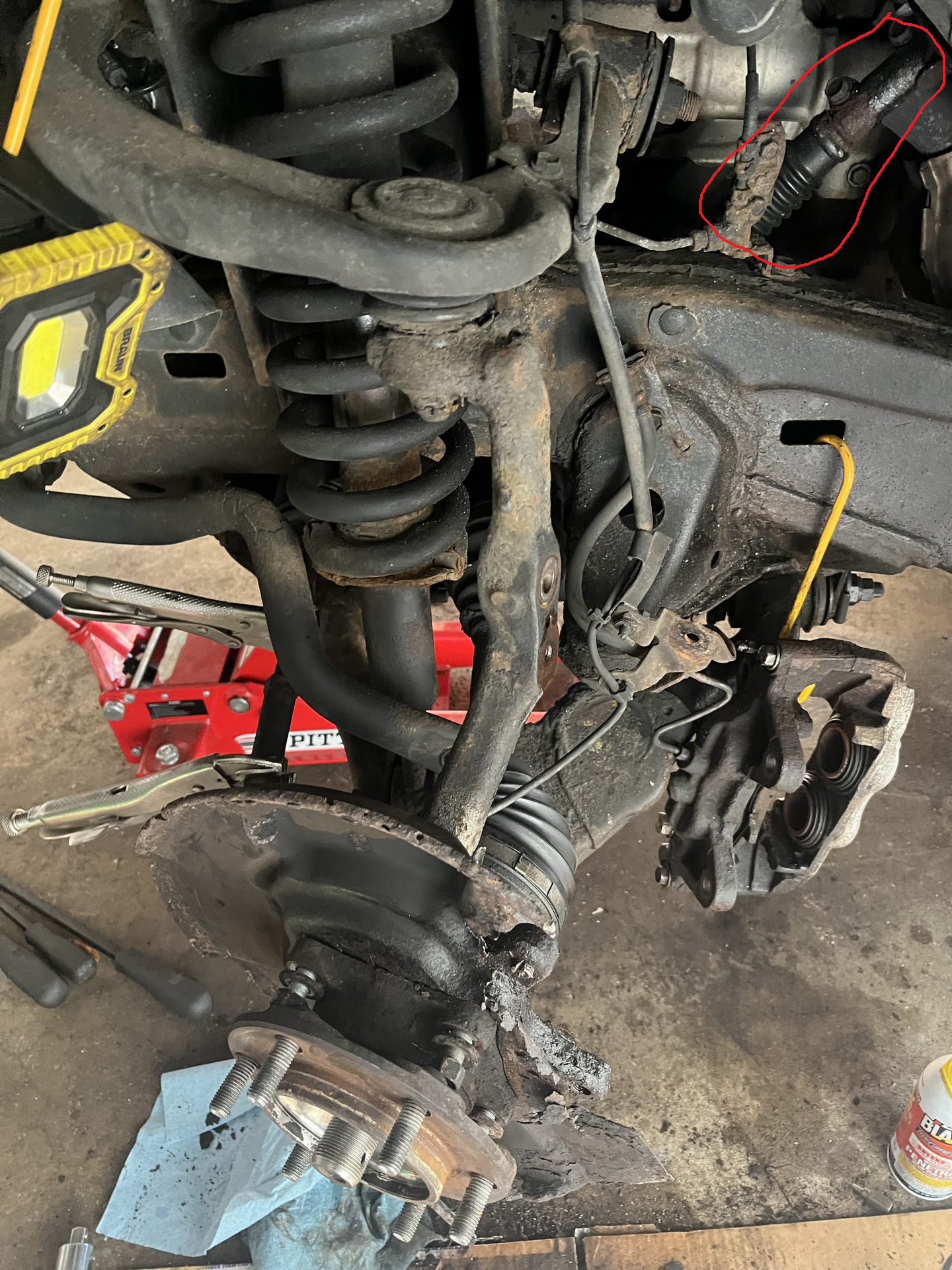

See my pic for more info. The strut removal...I typically pull on the lower portion and use the entire strut at a lever.

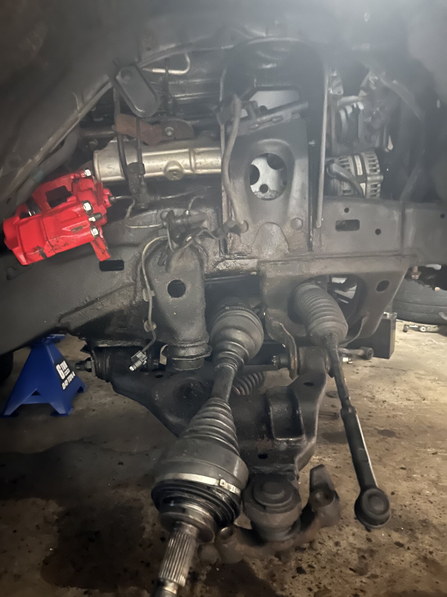

My buddy answered my SOS and we were able to whack both sides out within 3 hours!
Alas, I effed up a few things…
I need new brake lines. I cut the bracket attached to the frame with the elbow fitting, because the bolt was rounded off. Rest of the lines are rusty. Anyone knows the part numbers for the pre-bent lines? I need the line & bracket from there til caliper (minus hoses which I have the new ss hoses for)

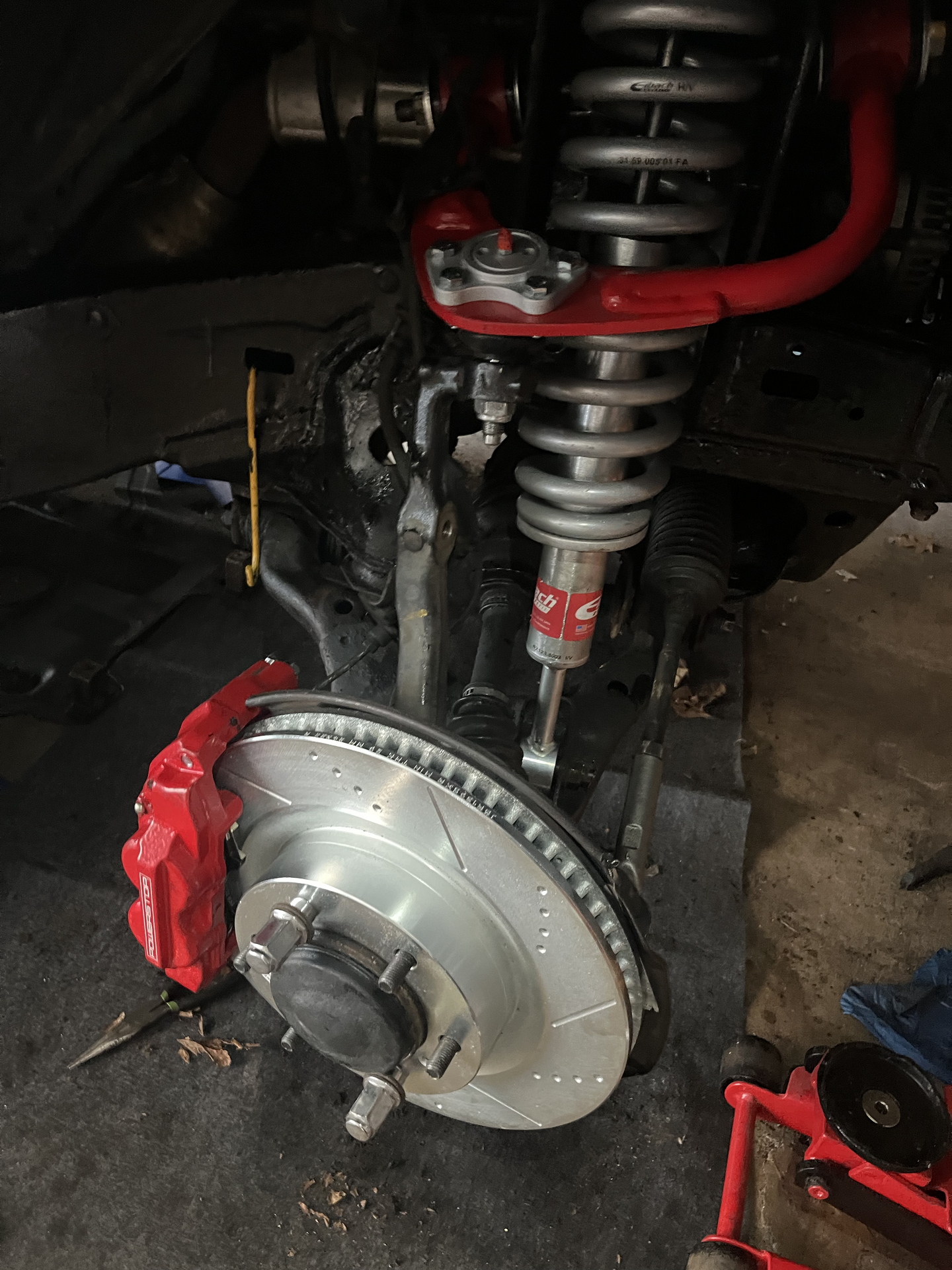

I've done quite a few things since my last update.
- I degreased, prepped, and painted the newly visible parts of the frame with por15.
- I got my eibach front strut/shocks assembled at The Custom Shop in Queens, NY. Great guys. They squeezed me for an hour despite being fully booked for 2 weeks. They also informed me the KYB top hat bushings didn't fit, so they installed 2 from some of their spares. I would've been screwed had I done it at home.
- Installed the JBA UCA's
- Replaced driver side CV Axle with Cardone 66-5235HD. OEM will be rebooted later
- Installed new steering knuckle, Tie Rod End, ABS Sensor, & reinstalled brakes on passenger side.
I'll finish up the driver side tomorrow.
I misplaced the little bolt that attaches the ABS bracket to the UCA, so I used a zip tie for now. I'm absolutely dreading the brake line fiasco. Le'sigh..
Ta-da!!!
