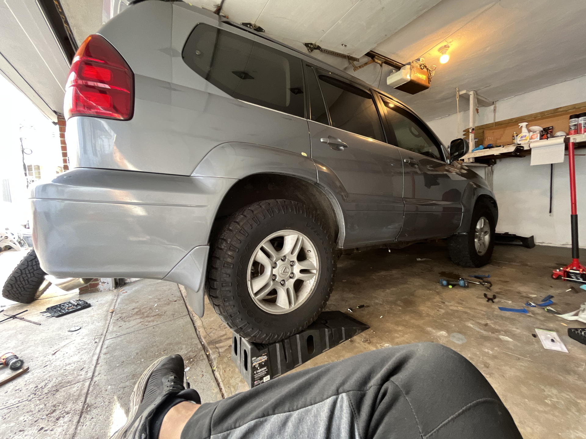

Not the best picture, but it's the most recent one :)
In that picture, above that rear wheel at about 11am and 10am, could you take a picture? You might be able to prevent the rust holes before they start.

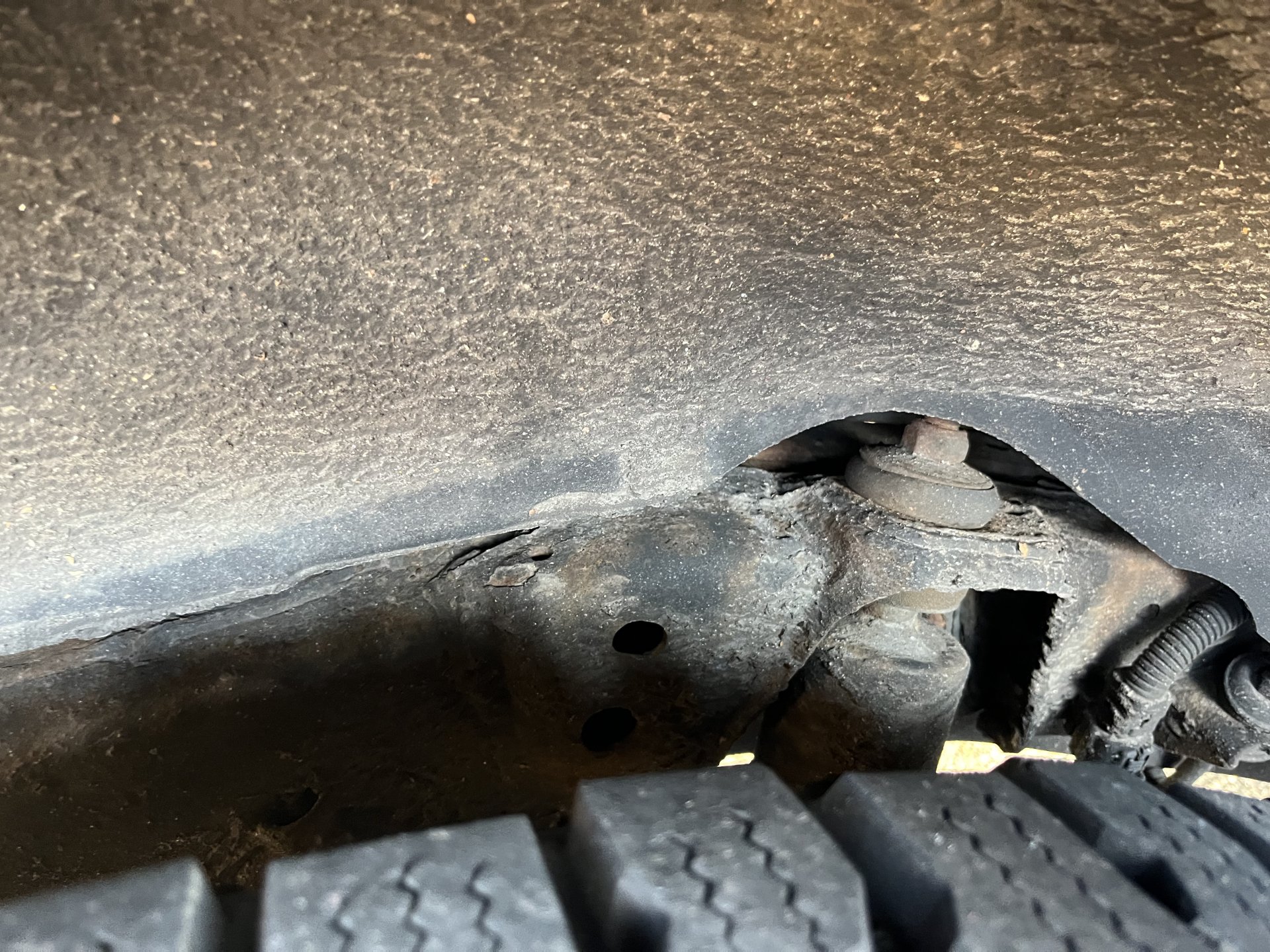

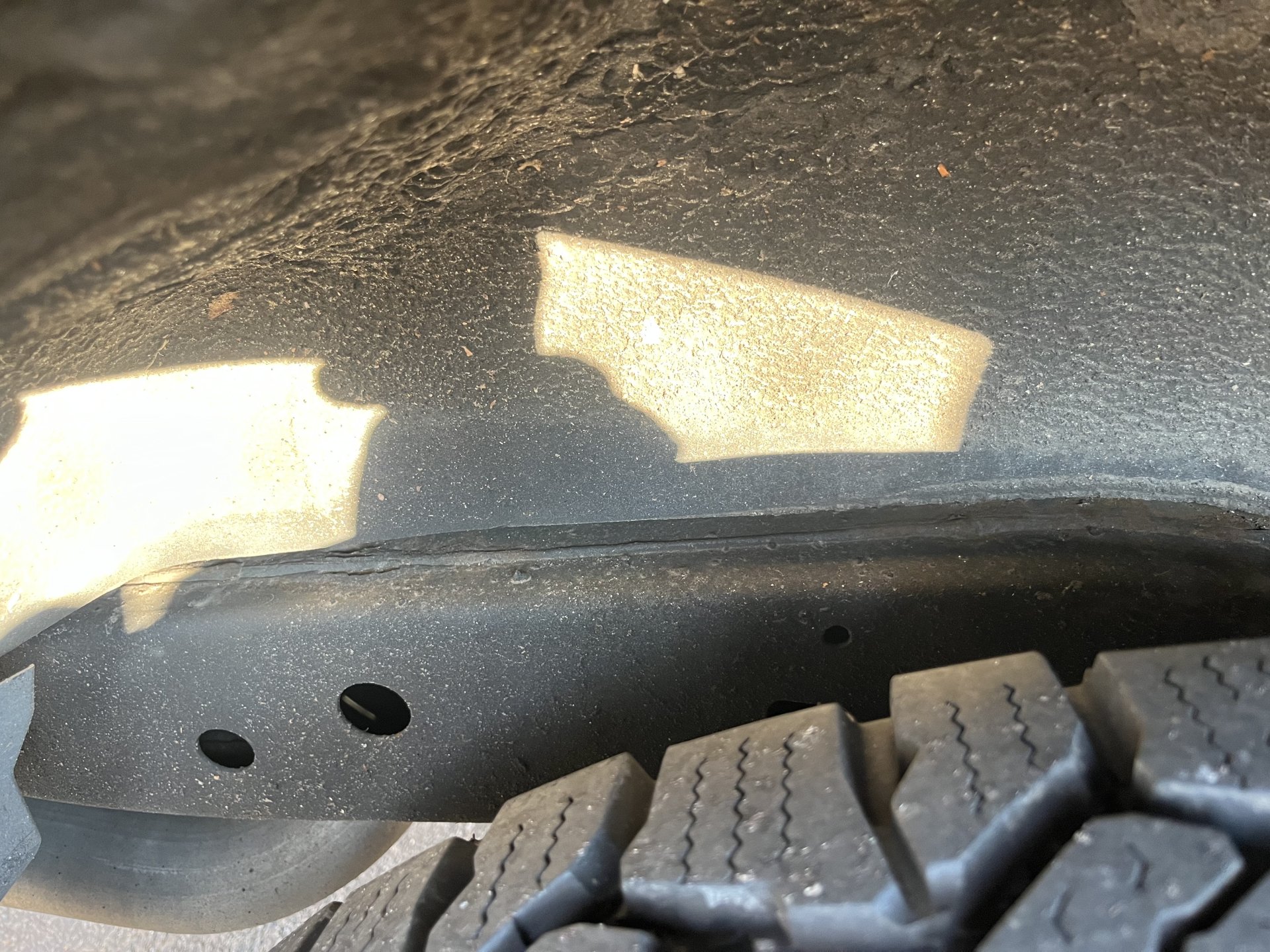

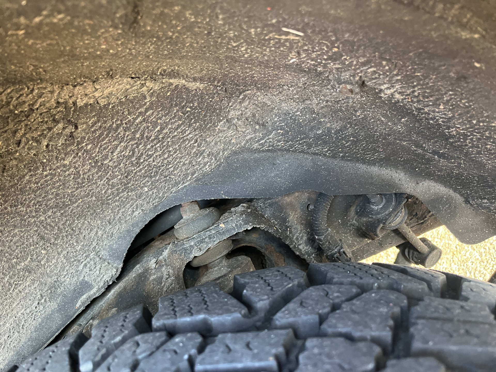

I took a few pictures ranging from 10 - 2 going clockwise around the rear wheel. Bless me with the knowledge please :)
It's hard to tell if yours has started rotting. If you look at your second picture right above the sunlight shinning there's that little square shape, which is where the seat mount is located. Every GX I've looked at in the salt belt around me has started rotting right there. I will post a few pictures of mine, I've fixed mine but it was close to too late. Yours might be good, like I said it's really hard to tell. One thing you can do to make sure it's not rotting is yank off the panel inside the truck over that wheel well and see if there's any rust poking through. It's really easy to pull that panel.
And while you're in there you can see if the foam around your subwoofer is still good.

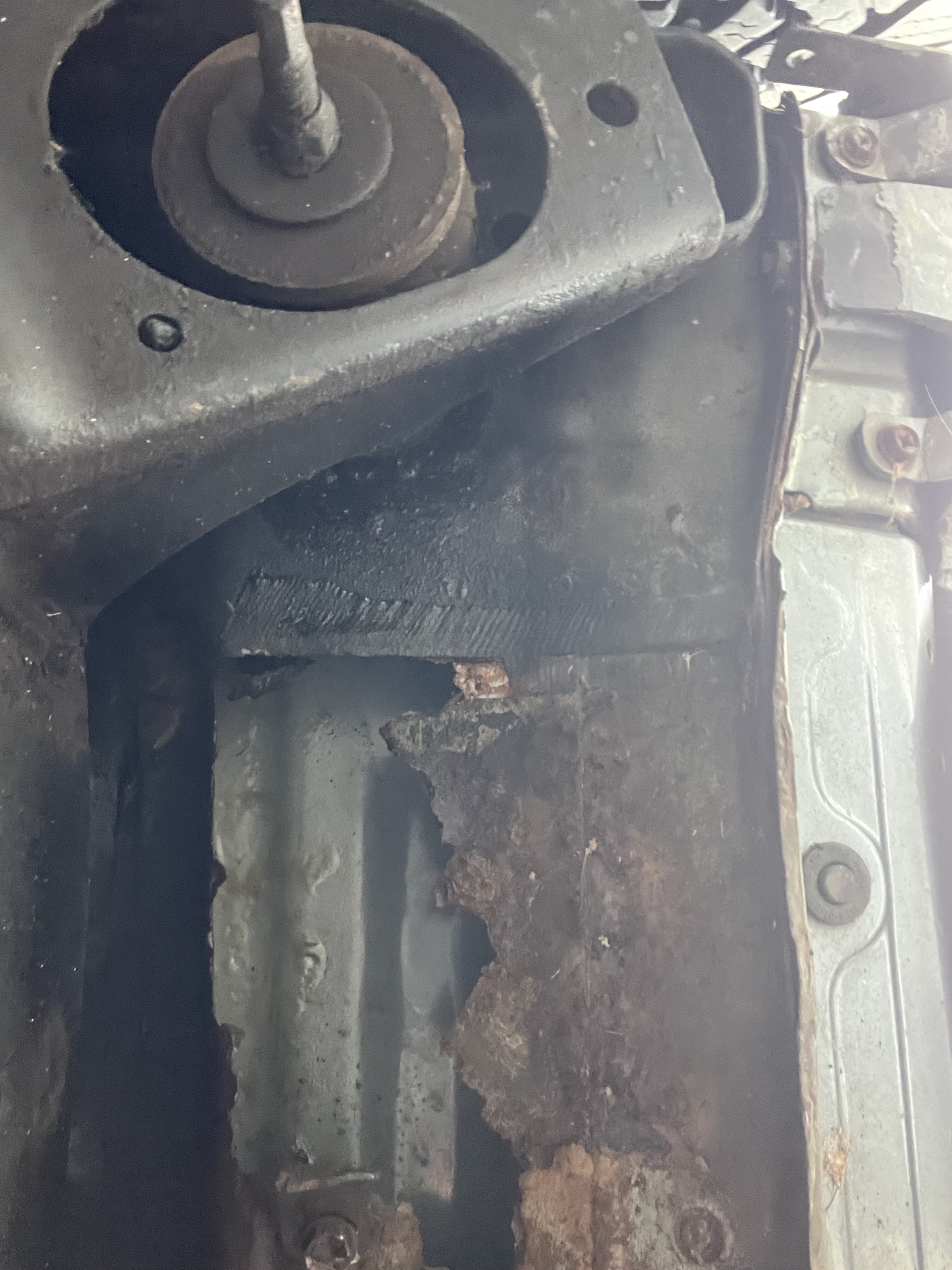

Speaking of bad rust, I did find it in 2 places. When I removed the running boards, I had to cut off the last bolt with an angle grinder (right behind the front driver side wheel). I read that the passenger side is prone to rust, but mine was in great condition!
The second place would be the rear crossmember. There isn't any rot, but it definitely isn't pretty. Photos are BEFORE I wire wheeled & applied fluid film.
The best you can do is slow it down as much as you can. I personally think the paint on POR-15 is the best option, it's quite expensive but it works so well.
Amazon product ASIN B00H2VVQNU
That stuff is the real deal. For your holes you could temporarily seal them up with some hand cut pieces of your choice metal, and use copious amounts of seam sealer to stick it on and seal it to the existing metal. Before and afterwards I would apply 2-3 coats of POR. That should last long enough for the rest of the truck to start rotting away, there's just no way to avoid it unless you did a frame off dip and started with a frame that has very light surface rust or no rust at all. Even then, the salt will find something else to rot away.
Correction, use panel bond to attach it to the existing metal and seal it with seam sealer. Here's a video about how well POR-15 works against others.

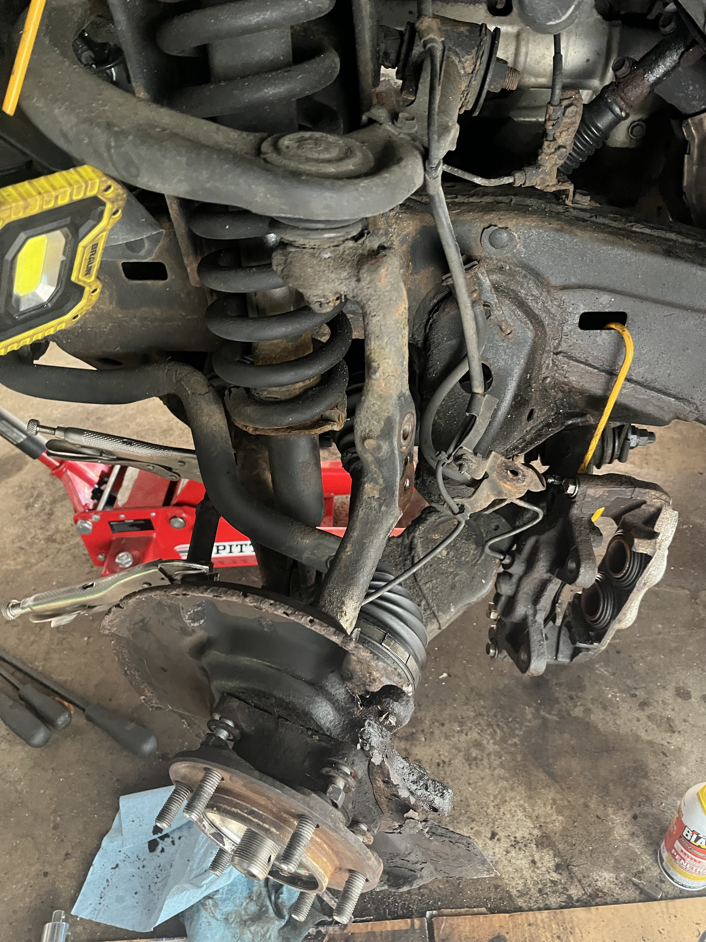

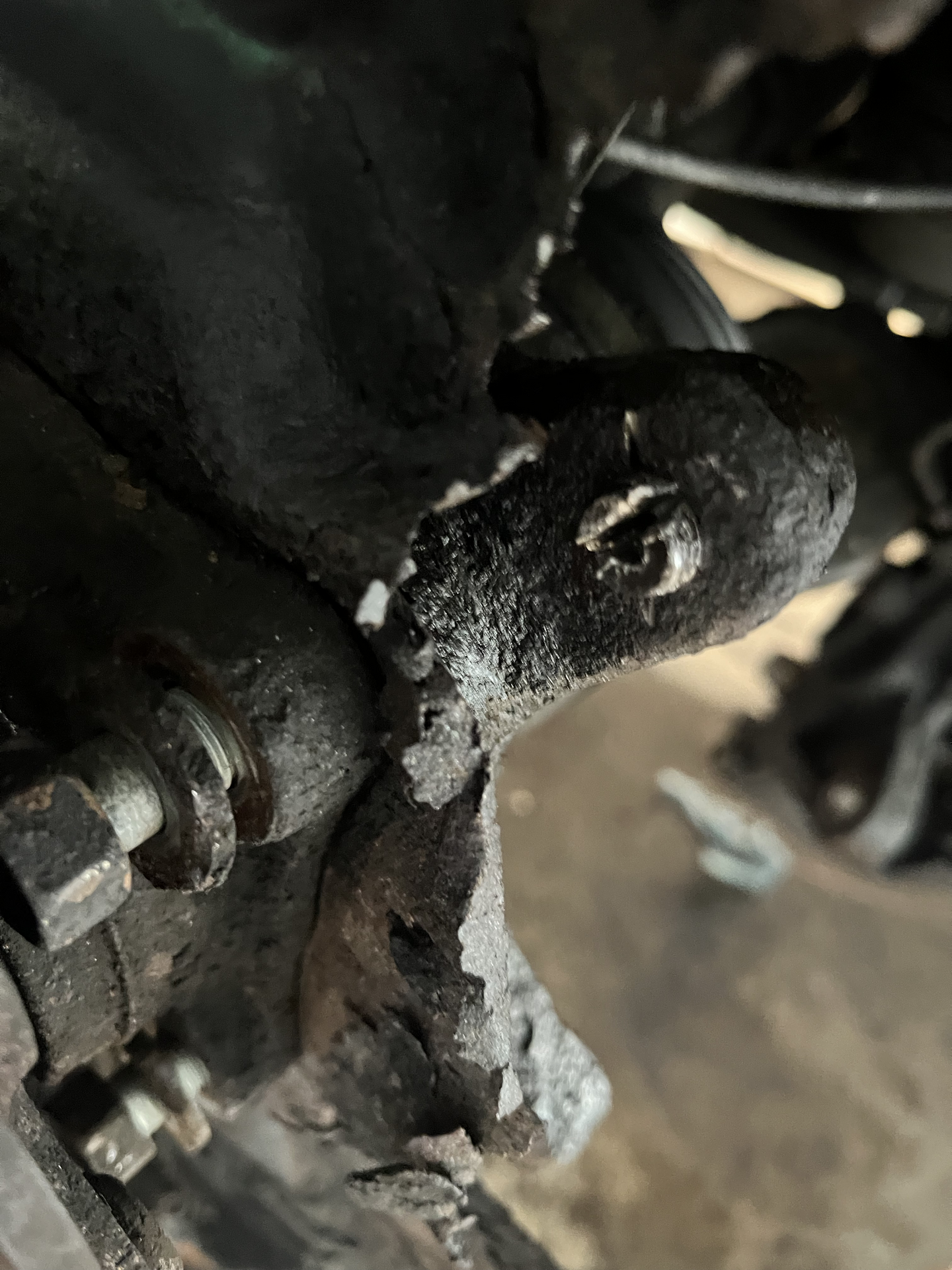

I'd like to preface this by saying I am NOT mechanically inclined, but I do love mechanical engineering. What started as a simple front brake upgrade has turned into a full blown suspension rebuild... my truck has been on jack stands for nearly a month as I reevaluate my life choices, and try to manage with the little free time I have.
Passenger side brakes were done in an hour!
Driver side was a nightmare. One of the caliper mounting bolts snapped whilst turning it. I tried everything... left handed drill bits, extractors, pb blaster, mapp torch, screwdriver & a hammer. Ok so I ordered 2 new mounting bolts from Toyota.
