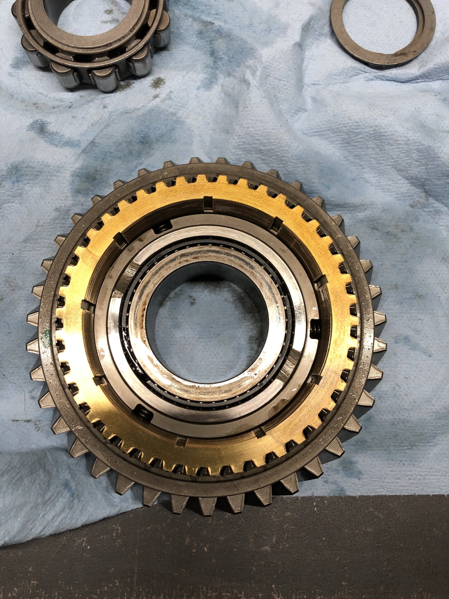

Hello all, super happy to finally be part of this group, I'm a longtime lurker. Always been a 4runner fan, but out of the US now and just bought a new-to-me 1990 FJ80 5-speed manual (pics for love), and am having some trouble with shifting into 2nd gear. Going up from 1st isn't an issue, but coming down from 3rd into 2nd, it just won't go into gear. Not grinding, just won't go. Any pointers on an existing thread that could help, or other insight? Thank so much, I'm excited to tap into all this collective knowledge!

I've never seen a manual 80, but this sounds a lot like a bad synchro. On other manual transmissions, I've replaced the synchronizer parts and this has resolved the issue. I've done the work myself, but unless you are very mechanically inclined and have a full shop, I'd leave it to a professional.
