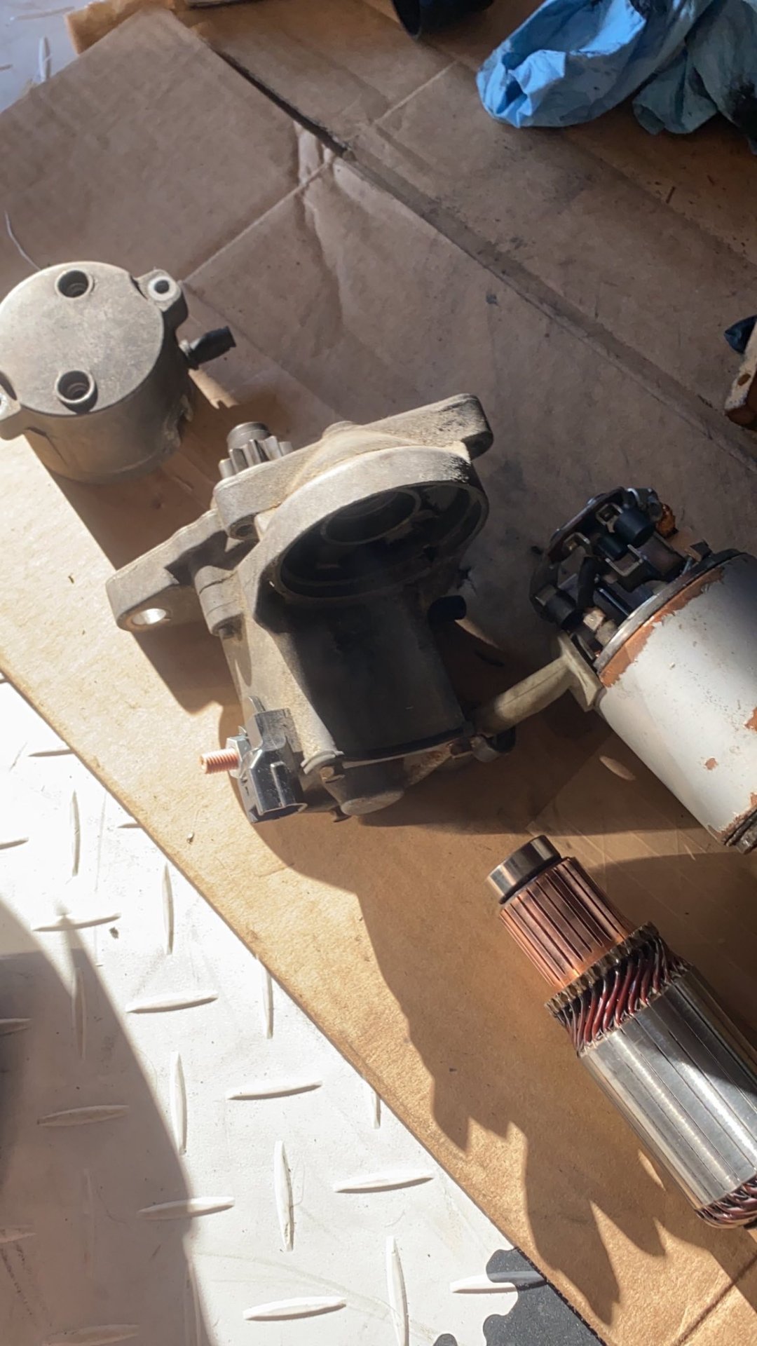

I have two starters. I'm on my second rebuild. Haven't installed the newly rebuilt one. But this time, I pulled the starter apart, checked the bearings, greased them and cleaned the comutator or whatever its called (the copper thingy) and the 4 contacts. I'll report back after I install it and 2 years have passed. Because I have zero confidence this will fix anything.
The innerards. 2 screws, two bolts. Bit of a pain to get the the 4 contacts back over the copper thingy. Used a socket to give me an extra pair of hands.

I believe that the contacts in my rebuilt Denso weren't pressed down according to the FSM when they were installed, because they were worn very unevenly. Additionally, the lip around the plunger that bridges the contacts was *extremely* thin compared to a brand new Toyota plunger, which seemed like unlikely wear for a fairly new starter. Edit: I mixed up the timeline. It was around a year between installing the reman Denso starter and the first time I had a no-start condition. It was very intermittent and was fixed every time with a light smack on the end of the starter housing with a hammer. The frequency of no-start events increased and I finally replaced the contacts around March 2021 with a Dorman kit I had laying. I got around to installing a new Toyota plunger around February 2022. So, the plunger wear wasn't excessive, but I still think that the contacts weren't seated according to the FSM when it was remanufactured.
