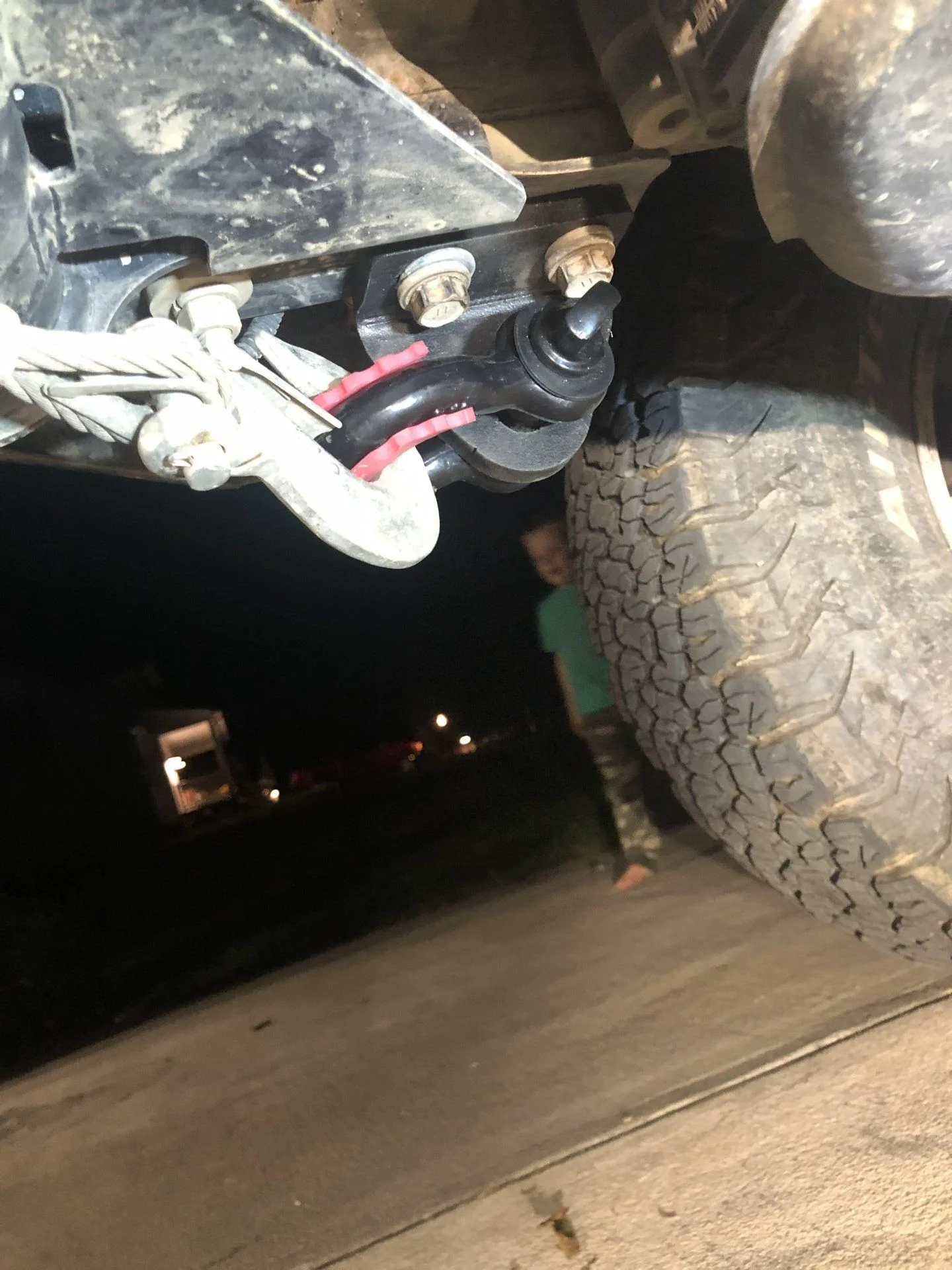

Got them installed last night. The factory ones had gotten me unstuck 3x winching out of a mud pit but they were actually too small for my D-ring so I had to just put the hook off the winch on them. Not sure why the ARB bumper doesnt have integrated recovery points in the front, seems easier to get. Every time I've had to use the winch on those points I've had muddy water up to the grille had to stick my whole arm/head under and feel around for it. I didnt need a spacer probably because this is the older ARB bumper and this area seems to be different. 3yr old photo bombed and now he looks like a zombie...
