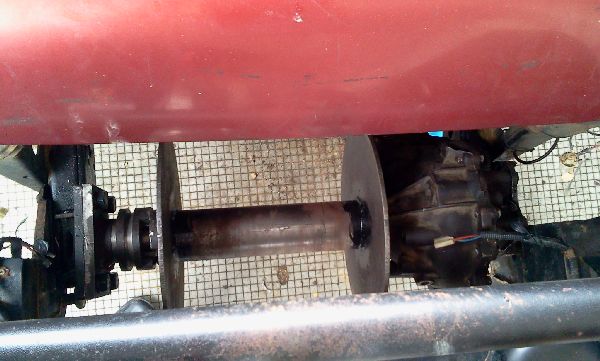

At some point before RED got blacklisted I smashed the aisin winch into a rock. I know the day and the trip. Result when I slipped on oil I did not expect and saw the split -0oops. Cannot replace or repair . so with the 24 volt / 12 volts transformer playing up and leaving me no air cond , no electric windows and no stereo I Was offered a god winch for a discount from an order not taken.
1 second later YES
Monday they pulled out old winch and intercooler
Tuesday give permission to cut cross member to allow the god winch shaft to fit
Wednesday theey realise intercooler too big for god winch has to go top mount
Friday the new god winch being fitted to new brackets
God winch is replacing pto shaft with prado diff ratio 4.88:1 aand custom shaft and drum and for mine approx 200' of 11mm steel cable
God comes ftom the speed as you cannot outrun one to get outtta the way. They are fast!!!!!! Video later when its finished . No need to use the drive axlr gears just use the engine and xfer case in neutral low range select 1,2,3,4th or 5th and go for it
Pics later tonite
