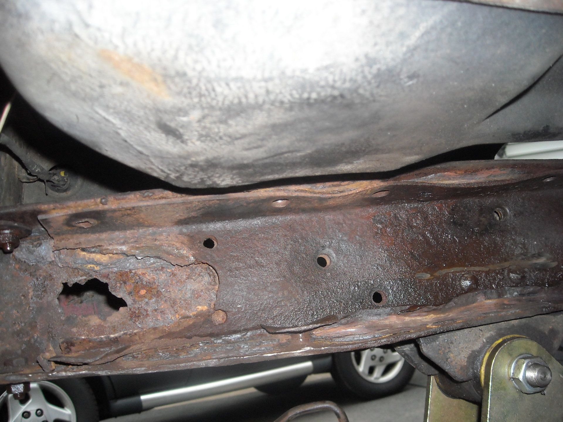

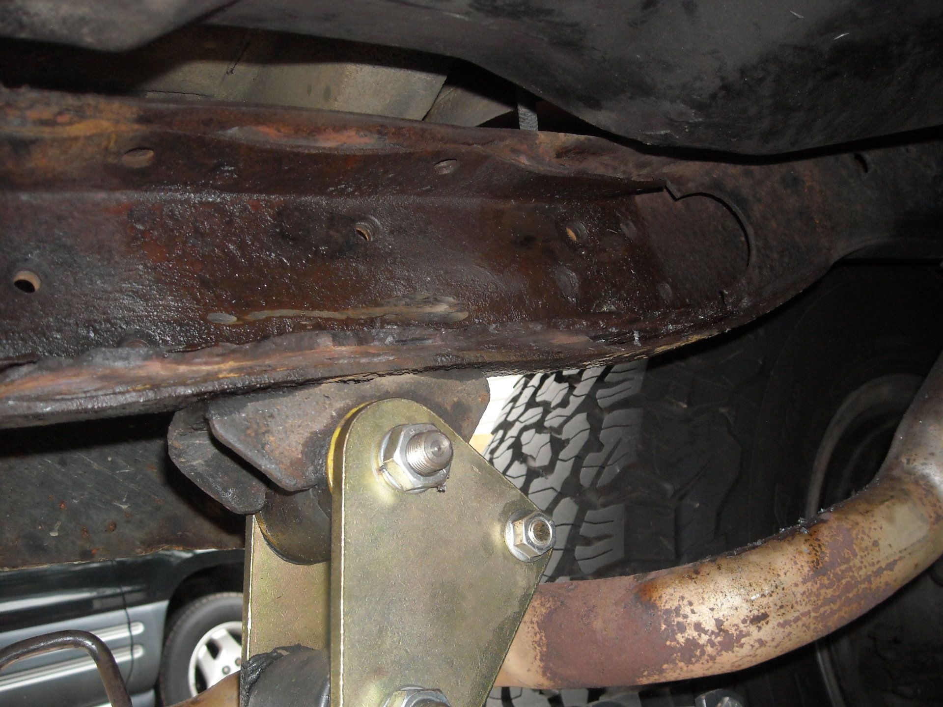

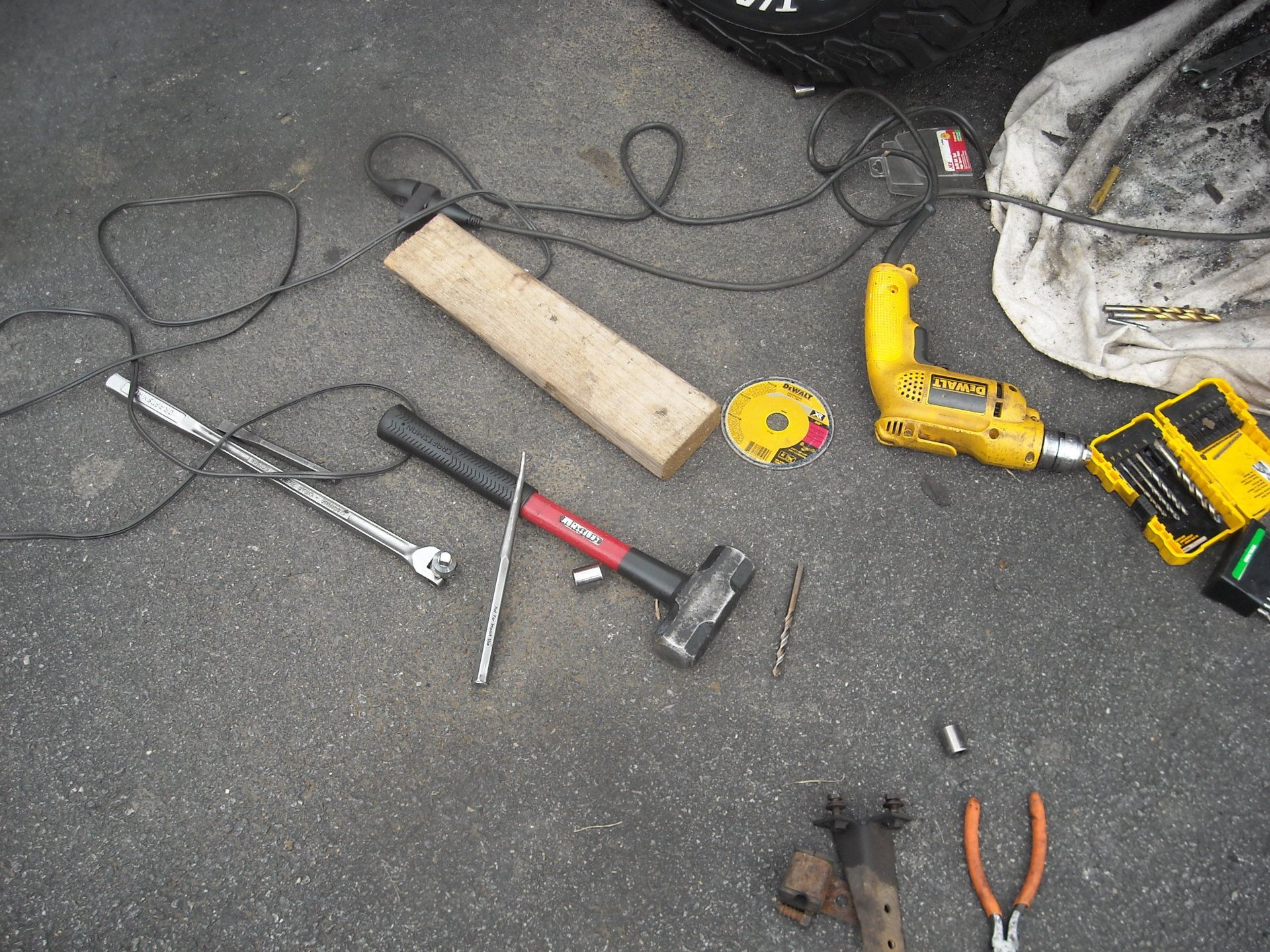

Started working on this. Drilled out some useless rivets on day one. The ones that were not holding anything but my rusted away old C channel to the outer frame. Day 2 I removed the spare and drilled out a couple more. Day 3 is today and I unbolted and removed the cross member (that holds the spare) and unbolted and removed the exhaust bracket.

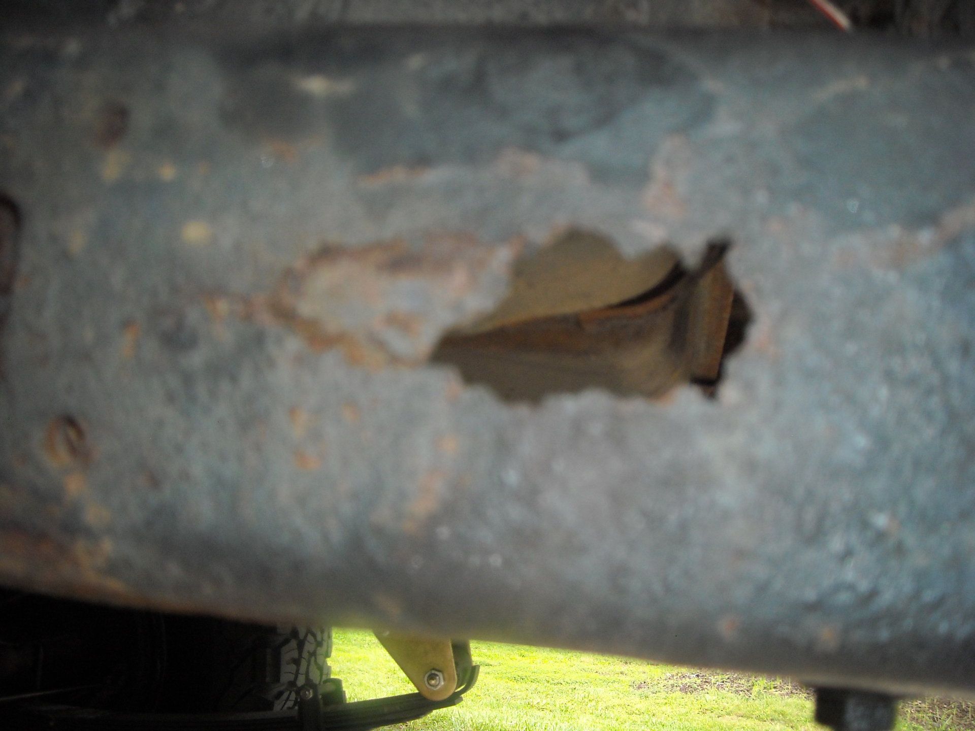

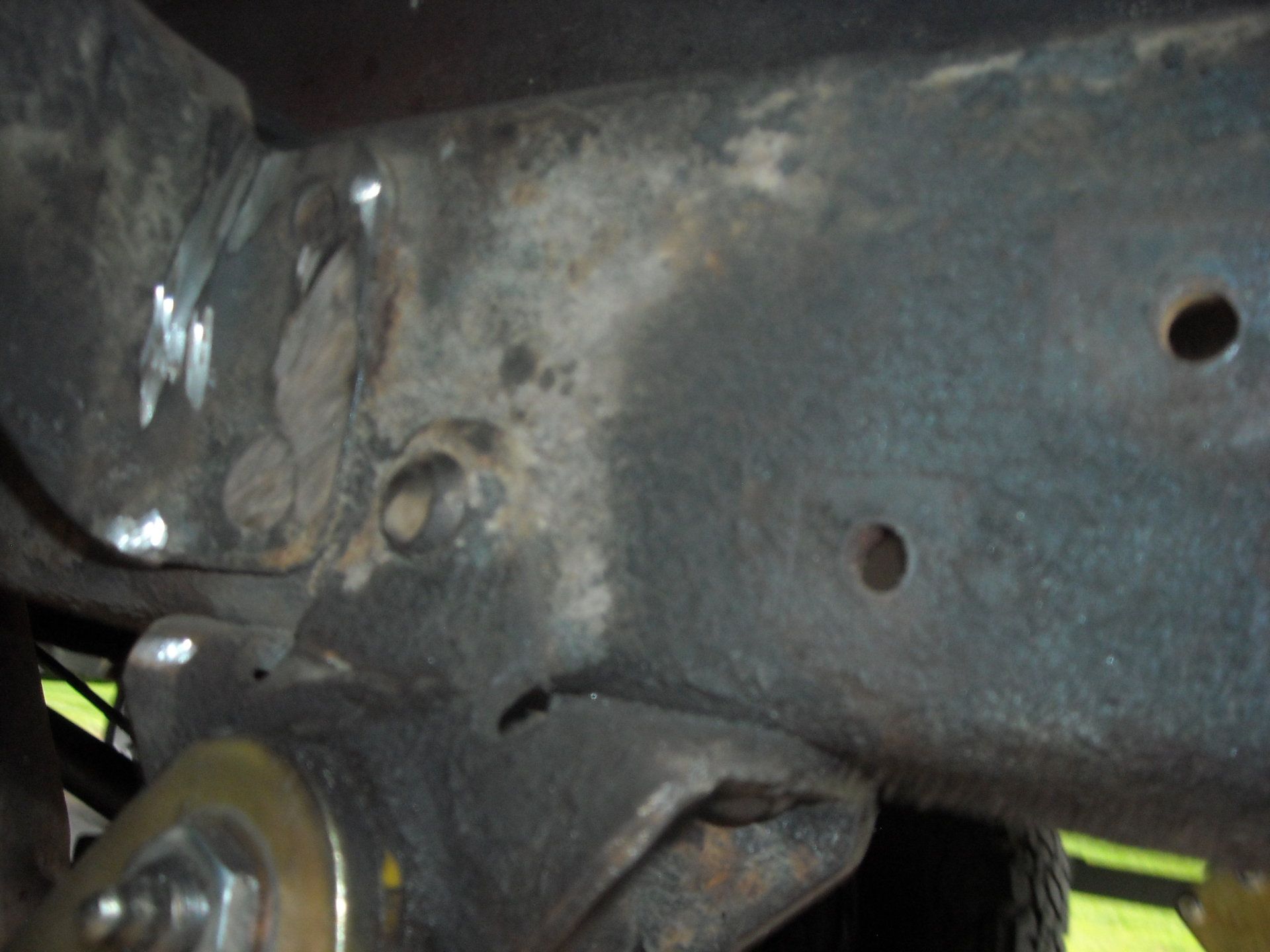

I studied the body mounts more today and I realize there is one rearward of the c channel and just before the bumper. So with that holding the body I feel safe removing the rivets from the body mount where it's riveted to the C channel (edit: while the body is unsupported, but of course not driving it anywhere) . So I did one side today. Lots of drilling, grinding and beating. I put a tarp down to catch the rust shingles and metal shavings.
As you can see I have some patch welding to do on the outer frame after I get the C channel out. here are more pics of the mess.
I'll head to the store tomorrow for more drill bits and grinding pads. I'm pretty beat from working on this. I'll remove the body mount rivets from the other side tomorrow. The next day set the truck on stands and unbolt the rear springs and remove the shackles. I noticed today that the shackle mounts have 3 rivets holding them. One in the side and 2 in the bottom. So far I have not removed my gas tank but I did put a board between the grinder and the tank to avoid throwing sparks at it...esp the fuel lines. Looks like the rivets inside the shackle mount will be the hardest to reach. We'll see. I kind of like keeping as many wheels and weight on the ground while driving out the rivets. When I get up on the stands I'll have to do more drilling and less pounding. Something I learned today is don't grind the heads completely flush. Get down close then find the center and hit with a center punch. drill the rivet to make a good impression in the center. Go all the way through or at least a good way through then go back and grind flush. That way I don't lose the center and end up off the rivet on the other side.
