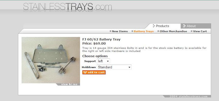

I just got my new SS tray from Noel at Stainless Steel Battery Trays for TOYOTA LANDCRUISER. Another great guy. I've been emailing him since i heard he lost access to get his trays made. Around Christmas I pinged him and got a quick response:
Hi Rob
I did stop making them but I am now seriously thinking of making more. Hopefully I can get some going.
Check my website once and a while, or just email me.
Regards,
Noel
then about a month ago he emailed me:
Hello Land Cruiser people!
I have begun to produce battery trays again. I have only a few 60s in stock right now but have 100 sets in the works.
The 40s are still in the works.
55s are in stock. No Optima 31s for the 55s.
I have had to raise the price a bit because of this wonderful economy.
They are $69 plus shipping. As before you have a choice of left or right and hold downs for standard, 34 series Optima, and Optima 31 batteries.
Sorry I have taken so long!
Regards,
Noel Brodzinski
DK Enterprises
stainlesstrays.com
I spoke with him that day, and the tray was on it's way the next day.:clap:
So i've been sitting on this GORGEOUS SS tray waiting for him to finally have them available online.

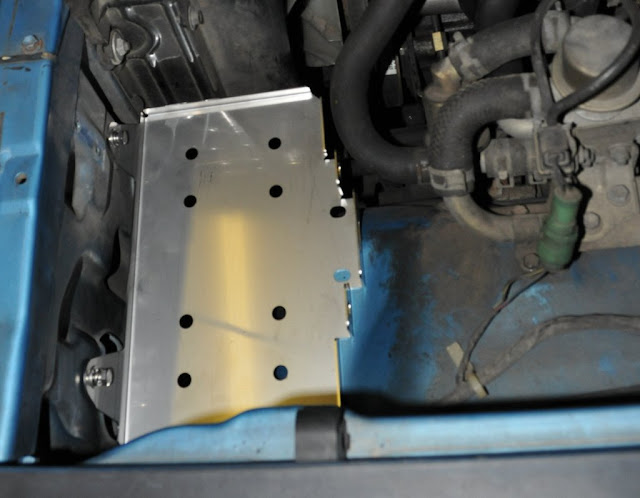

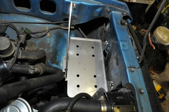

Tray set in
Missing one hole to bolt to fender:
Easy fix - hole and washer/nut.

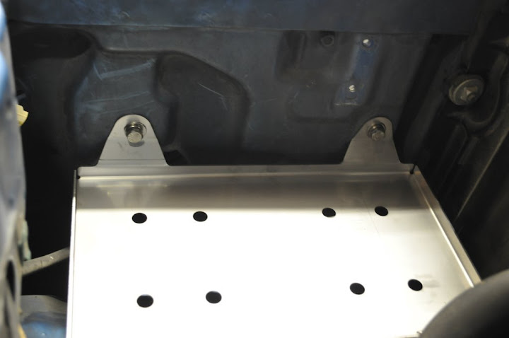

With the brace (man this is a good looking tray! almost a shame to put a battery on it and block the view!):
OK - got the battery in, with a group 34 specific hold down.

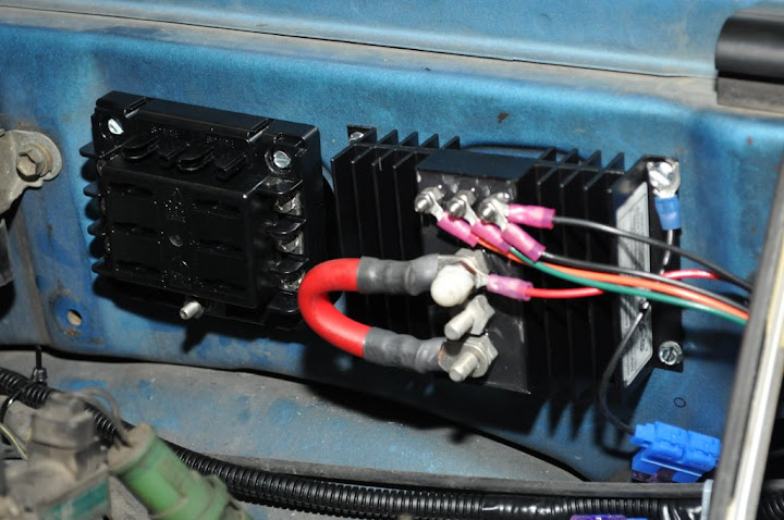

Additionally i don't have headlight washers or the bottle. (useless in my mind). That made room for the BIC-95300 from Hellroaring Battery Isolator/Combiner BIC-75300. I paired it with a fuse panel for accessories (still in the works), which also acts as a PDU for clean installs w/ standard fuses (same blade type as interior fuse panel). 100A max from Del City - Wiring Products and Professional Electrical Supplies (item 70365):

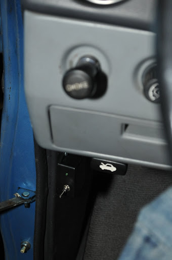

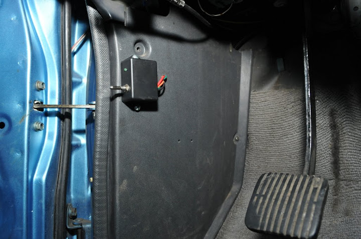

The BIC remote installed here - i think this turned out very clean w/ a bit of loom not shown:
i like that i can see it easily and reach it, but it's out of the way. I'm a big guy (6'8" - 260lbs) and don't want anything hanging in the way that restricts even more leg room.

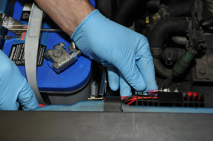

I need to grab some more shots of the final install. Here's brandon finishing up the wiring, and new military terminals (like these a lot!):
