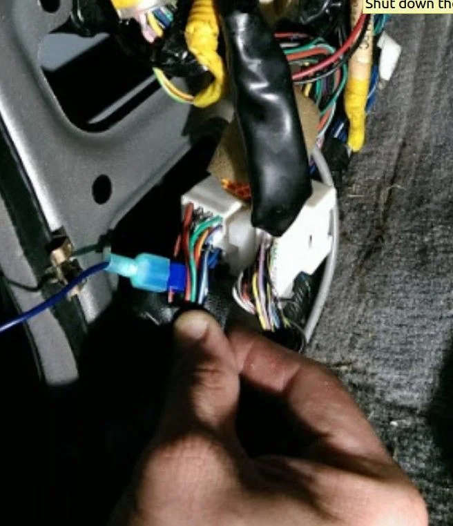

Is this the photo? Copied from you build thread:
Yep that's it, there is a better pic of it later in the thread, someone said my first pic was not good enough, and for some other part of the build I had to re-open that kick panel and took a better pic.
Savirc, How did you get the video wire under the head liner?
Fished it thru the headliner trim, takes a bit of patience and you will have to un-clip them some but not remove.
Savirc, thanks again for pointing out a better picture.
I found it. BTW, I am relative new with wiring - what it that
connector you are using in this picture?
Is it two connectors?
I think I'll purchase some for when I start wiring my backup camera. Here is
your photo:
your photo:
Its a single tap in male connector combined with a regular female connector, you should be able to find it at an auto store.
