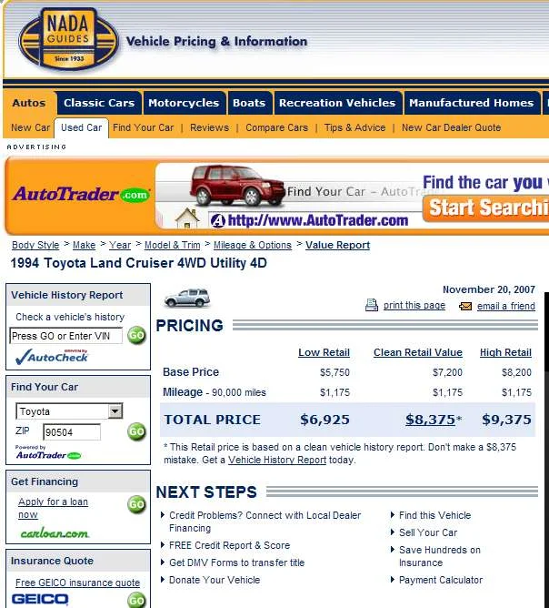

That truck is nice but I kind of doubt its worth 10k. I would negotiate down from that price minus the repairs noted and see how it goes? Hope it works out, either way $ well spent on the inspection.
Hey Brian,
Just to get an idea of what you're thinking, what price would you be comfortable at if you were going to buy it?
I'm kind of cheaper than most so I went to NADA.com for a estimate value, considering the condition, work that’s needed and market I would offer what’s listed; $8,375 initially. Think its would rate clean retail rather than high all things considered including the window short on the passenger side. If the inspection came back cleaner than I would have maybe moved it up to high.
Brian
