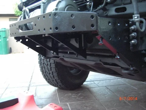

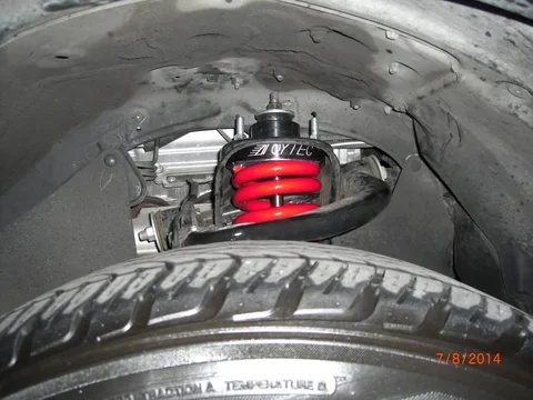

CIMG0174.webp CIMG0136.webp I built my own winch mount for 9000 pound winch so I install 3" toyteck suspension front and rear for $1100.00 to be able to carry the weight of winch and the bracket and it works perfect .awesome ride very smooth actually it ride 10 times better than my friend M5 bmw . and I haul trailer with 4000 pounds of weight in it and stayed level .
I have seen your winch mount in another post, I like it. Was it the same company in AZ that built your sliders that built the winch mount?
