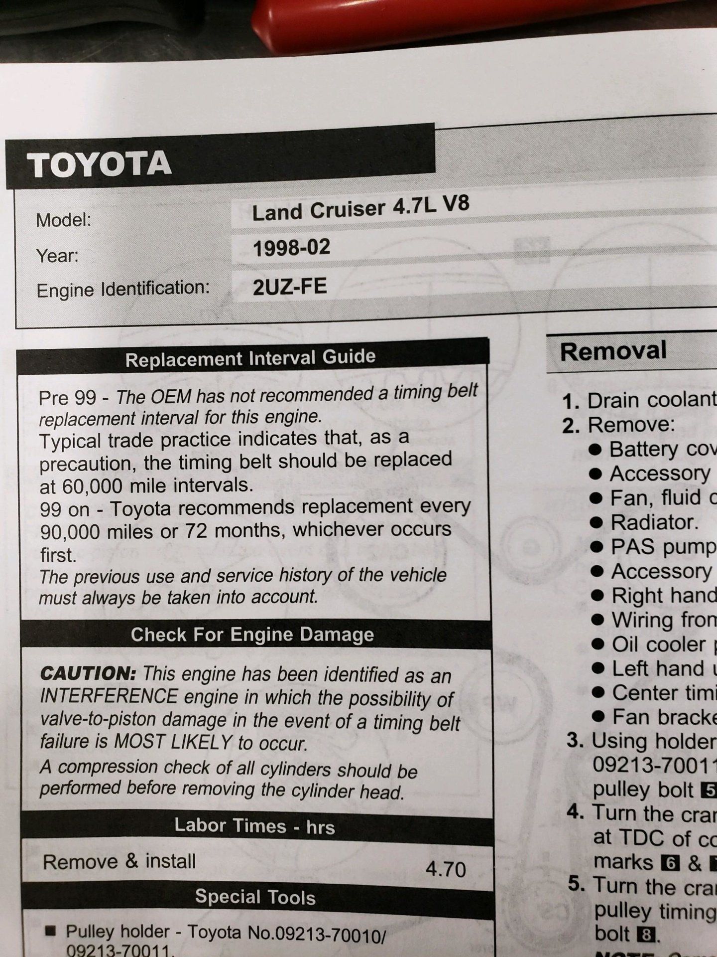

Are all 4.7s not interference engines?

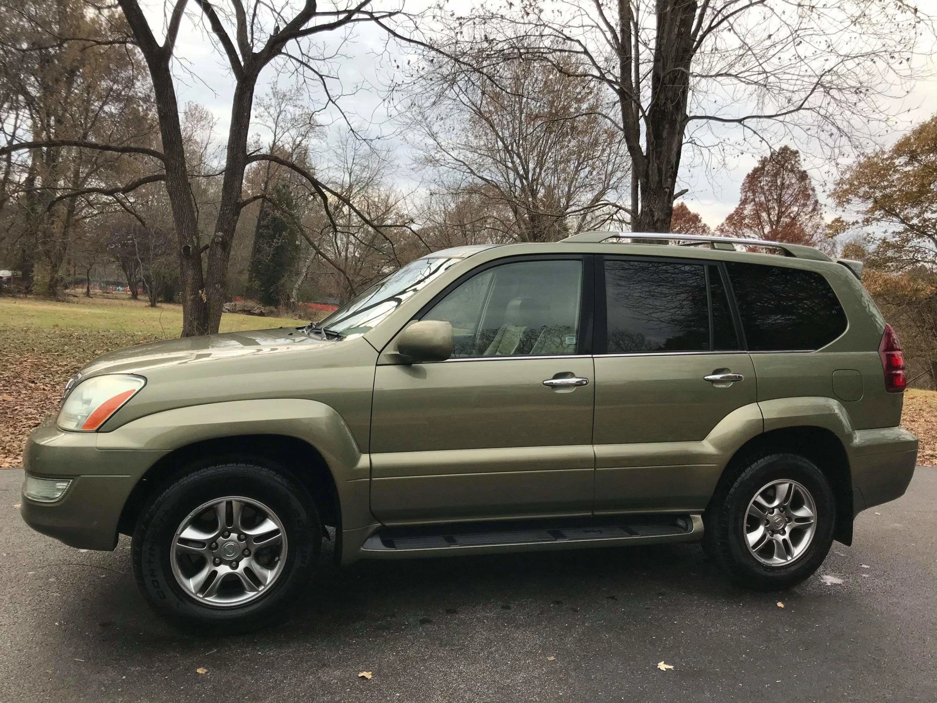

I talked to owner of 08 and got a bit more info. Brakes, tires are new. Last year he replaced the rear airbags. He sent me pics of the undercarriage and it's clean, no rust. He bought the car with 102k on it and it's now at 200k. Seems like he's been great at maintenance except for replacing timing belt and water pump. Lexus website shows water pump was changed last at 96k. The ONLY issues with truck are minimal wear on driver's seat and driver's arm rest.
No, the '03-04 engines are not interference motors. All have a timing belt, but the VVTi motors '05+ are interference motors hence the power gain. As long as the TB is taken care of, no worries.
Pic of the 08
08 seems like a great buy, IMO.

They are all interference. The non vvti just have wider tolerances
