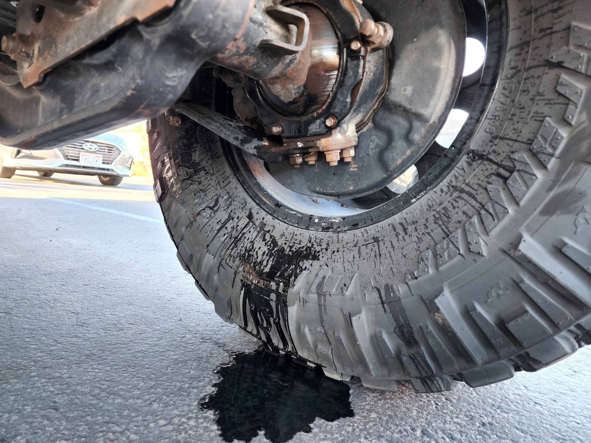

Found this in the parking lot today.
Fluid is the new lucas red gear oil I just put in last month.
I am guessing inner axle seal..
What else could cause a leak like thus? I am assuming a full rebuild is in order or can I just replace the inner seal and clean/re-pack everything else?
Looks to me like there's no GREASE in that knuckle, just fluid, as the ball is "dry" other than the obvious fluid on it.
Is it possible the ARB seals are leaking and pressurizing the axle housing pushing out the gear oil? The ball seals are the weakest point in the system if the housing vent is clogged or not able to allow that much air pressure release.
That is an INSANE amount of fluid to leak out while in a store. Something must be pressurized?!? Or is the seal even in there at all? A normal leak just gives you BIRF soup.
I haven't had luck with Toyota OEM seals on my Nitro birfs, switched to the Marlin's and they've held up great for me.
It could definitely be low on grease, I don't have any idea of the service history on these knuckles.
I just had the ARB's out a month ago and replaced all the seals because it used to puke a bunch of oil out of the compressor. I have used the lockers a few times sense re sealing them with zero problems so I am leaning towards a botched up seal from putting everything back together last month.
It was in my work parking lot for 11 hours when I took that photo. I don't think it was pressurized, the front locker was definitely disengaged and the conpressor turned off.
Before I went to work I noticed the leak but the puddle at home was a lot smaller. I am not sure why it leaked so bad at work. Maybe sitting for 11hrs in 90 degree temps through the heat of the day let it warm up and really flow.
Welp, I just ordered full rebuild kits from @cruiseroutfit with the OEM seals. The seals in it now are Japanese aftermarket. If I have this problem again I will try the marlin seals.
I am going to take it to my friends shop on Tuesday to get the knuckles rebuilt along with an AC service and a drain and fill on the tranny while it's in the shop.
Worst part is I just sold my motorcycle so I am currently daily driving the cruiser. I can certainly keep her topped off the next few days but shouldn't I be fine to drive it with low fluid in the front dif in rear wheel drive/2wd around town? There shouldn't be anything turning in front axle right?
Nothing should rotate. But you may be on dry bearings... Maybe not. Replacing the bearings then .....just don't push it too far to ruin spindles.
I am just going to keep an eye on it. If I get a few more large puddles like the one in the photo I will just top it off. But I am guessing I can milk it along until Tuesday. My commute to work is only 4.5 miles one way.
