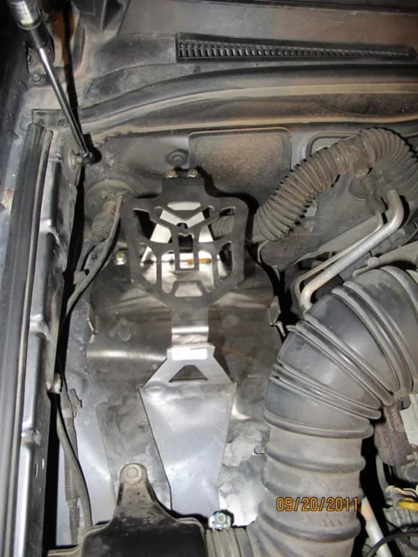

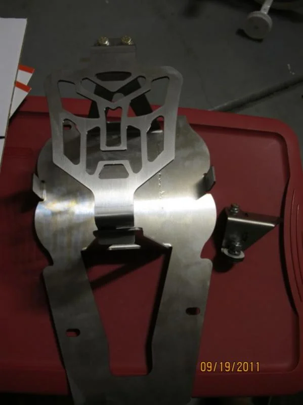

I think there are several options for the V6 version... Here's one someone made:
http://www.rme4x4.com/showthread.php?85895-4th-gen-V6-4Runner-Dual-Battery-Trays
http://www.toyota120.com/forum/showthread.php?t=21496
I'm working on making one for our V8, which is much harder to find! Grrrr...
