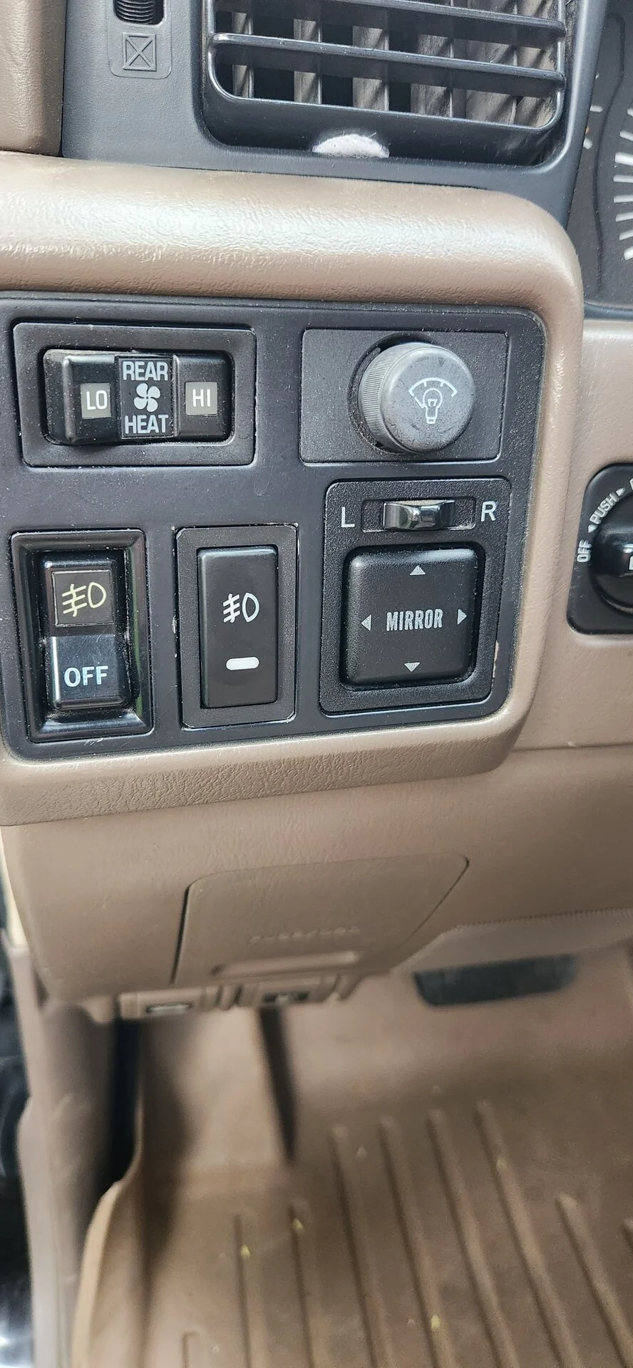

This may or may not be tech, but I was looking for an OEM switch for my OBA system. My plan was to relocate the existing switch to the dash to avoid me leaving the compressor engaged and draining my battery overnight. And, yes, I did that twice, thank you very much.
OEM switches run about $45 or so depending on what you get, but thanks to Jeffery, I found this for about $12. While it doesn't specifically mention fitting an 80 Series, it is an exact fit. It does not have the same gloss finish as the OEM product, but it's close enough that it doesn't offend me. I just need to change the icon.
Switch closure is BLU/YEL with BLU as the load and YEL as +12
RED is dash illumination and BLK is GND.
Amazon product ASIN B094K2LW36
Quick update. I had to slighty round the corners of the switch for a flush fit. Took about 30 seconds with a piece of emery cloth.

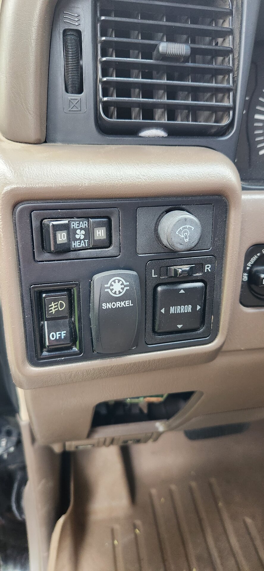

Is it going to be possible to change the symbol?
I like it.
Been looking to get rid of my carling switch's. That might be the ticket.
Not sure yet. I have 3 switches to do so far, just wanted to get the wiring done first.

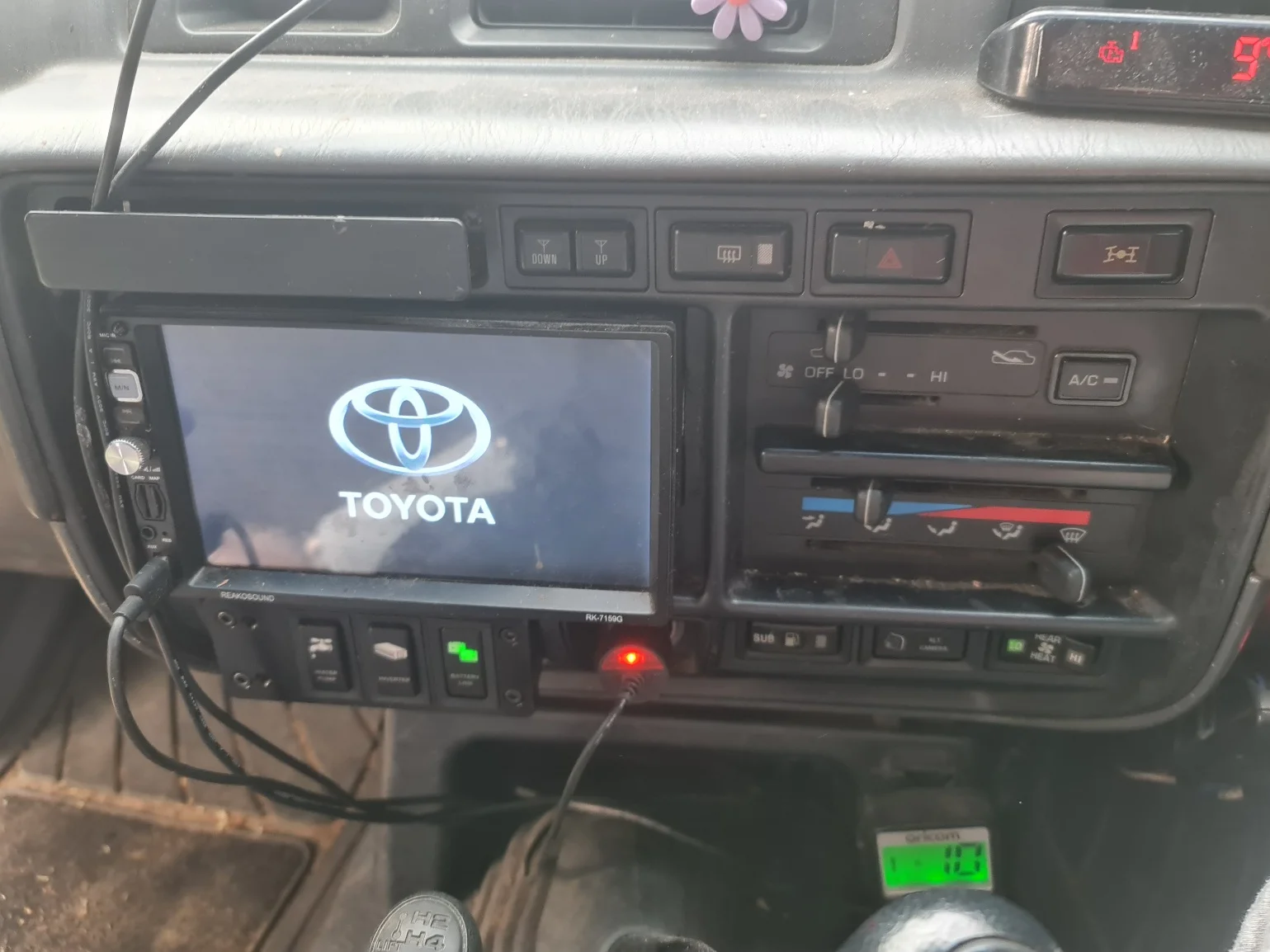

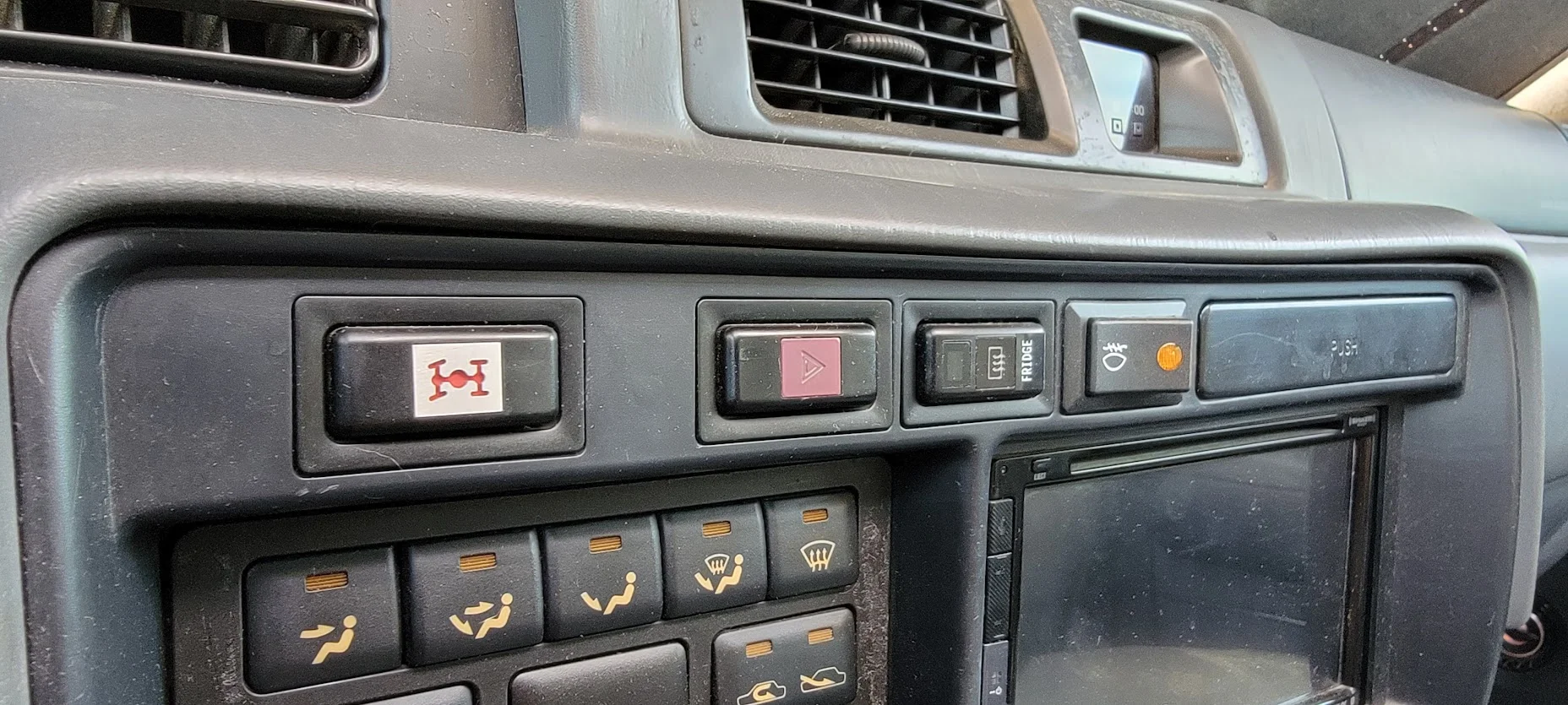

I love the look and feel of the OEM switches. I'm currently using a hazard switch for my CDL and a defrost switch with a label to turn my fridge on/off in the rear. My 4th switch in the picture is an OEM toyota switch but it is clunky and crude and I'm not a fan. It's connected to a relay to turn on my remote controlled rock lights.

Curious what happens when you turn on your snorkel...
So I was at Cruise Moab in 2011, and a 100 Series was struggling to get up a rock face. The spotter yelled to the driver, "Turn on your snorkel!".
I couldn't stop laughing, so I made a switch.
