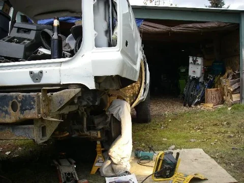

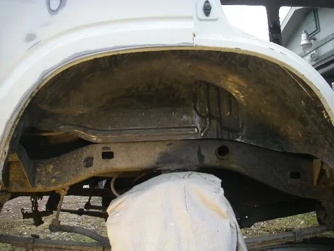

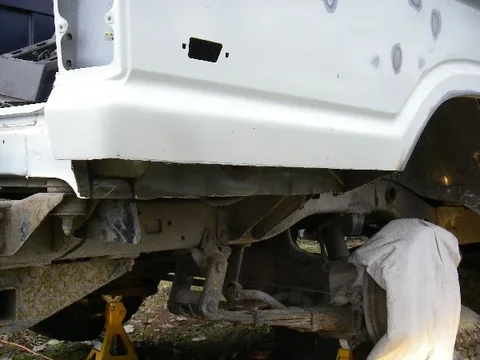

Today I got the inside ps rear fender cleaned. thought it would be a good idea to remove all the factory undercoat and make sure there was no hidden rust

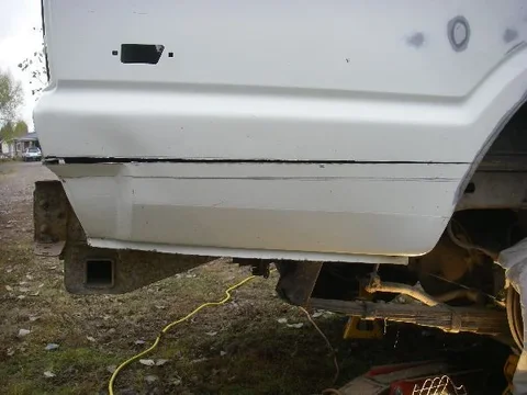

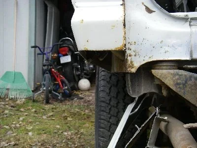

also started the rear quater chop while i was fartin around down there
my goal is to get the quarter chop buttoned up as well as cleaning up the interior and rust bullet everything. then a topcoat of durabak or something similar. Anyone used durabak? what are your thoughts?

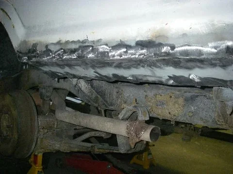

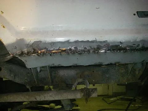

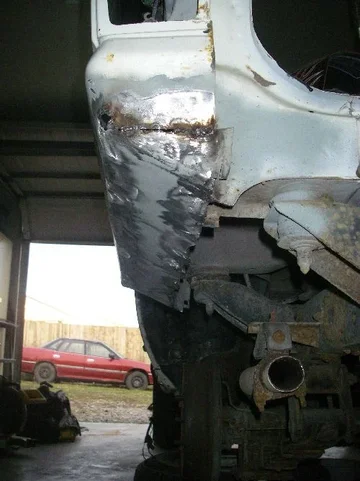

Went to patch the chopped quarters today and ended up just getting frustrated:bang:. my welds kept blowing thru and Nothing I did seemed to help:mad:.
looks like crap eh?

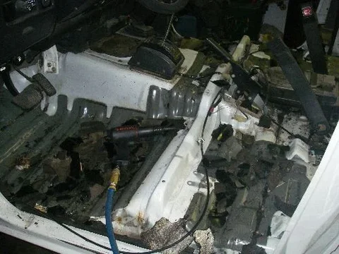

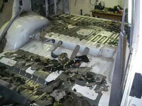

So intead of letting my piss poor welding ruin my day I broke out my new $30 husky air chisel and started blasting out the old sound dampner. YEEHAW
All cleaned up
That was fun;p:D took about 20min to chisel it all out and about 20min to clean it up. Well at least my whole day wasn't blown:clap:

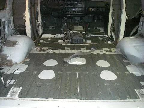

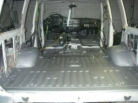

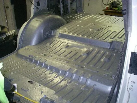

got the interior rust bulleted today:bounce::clap:. Rust bullet rocks! went on super easy.
Turned out pretty good. Next weekend I hope to durabak the interior.
I'll prolly use rust bullet under the fender wells also (if I ever get those quarters patched properly) with a coat of durabak to seal it all up.
Looks like all your hard work is paying off!:bounce:
thanks man. I still can't see the light at the end of the tunnel but I reckon if I just keep stumblin along It will show up sooner or later:D

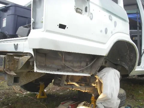

Finally got my welder/weldee adjusted right and was almost able to finish one of the quaters. Then Iran out of wire. Run to town. Run home. Start welding again. An hour later, NO GAS :doh::bang:. Geez this quarter chop is turning out to be the biggest PITA of the whole project.
this is what happens when your gas goes dry:doh:

Floor looks great, i have a piece of brass flat bar with different angles milled off, i place it behind where i'm welding to reduce blowing through.
Hurray, another Rust Bullet fan! Nice to see how it looks on the floor since that's the way I'm headed. I too will be painting my wheel wells with it. After wheeling in the mud and letting it dry for a week the mud on the area's that had any RB coating came right off with very little scrubbing when I washed it. I've always ordered it from the website but what stores (names) did you find it in?
