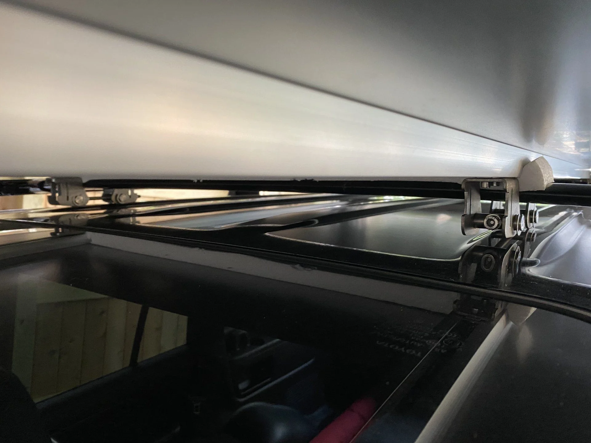

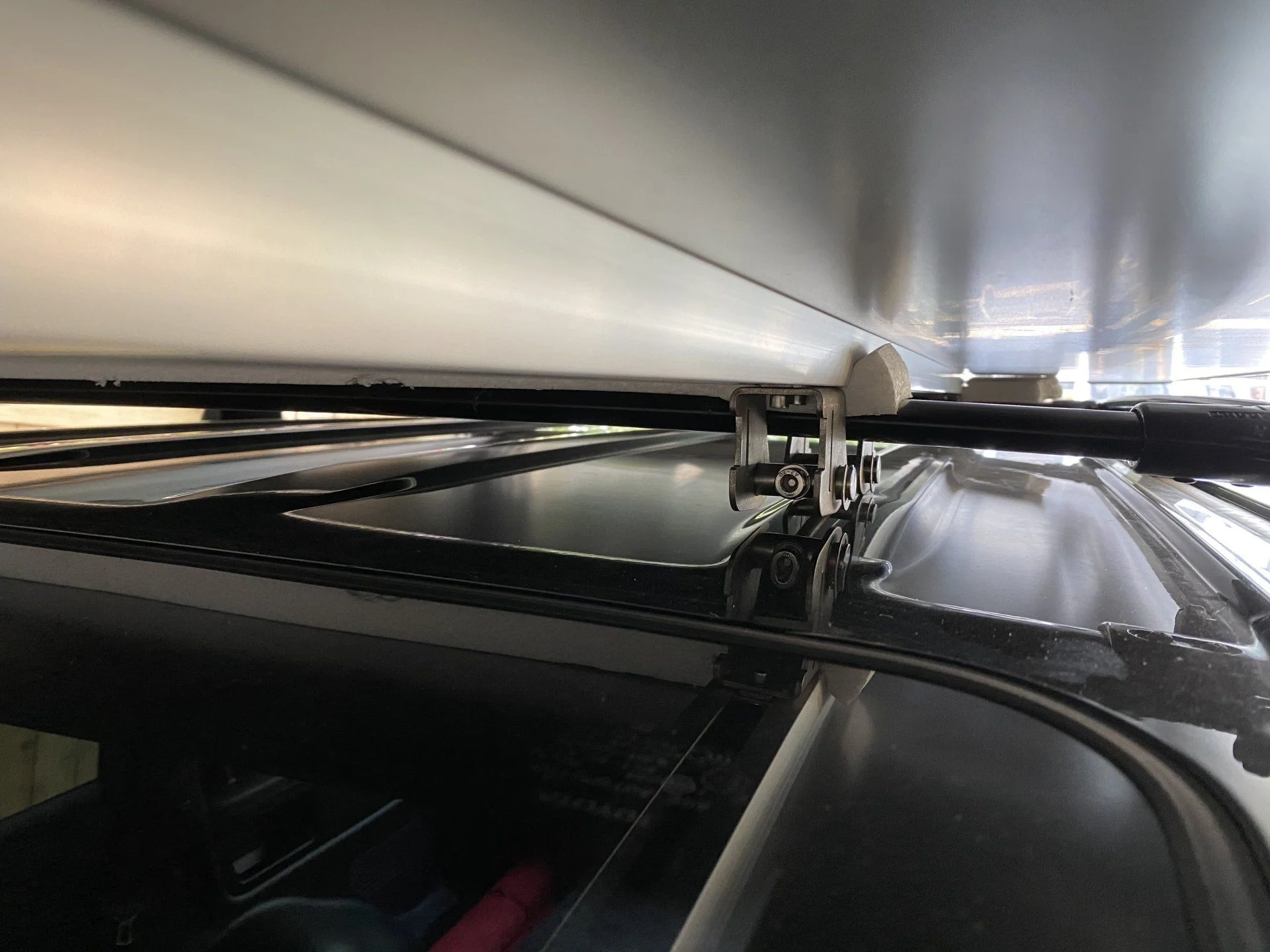

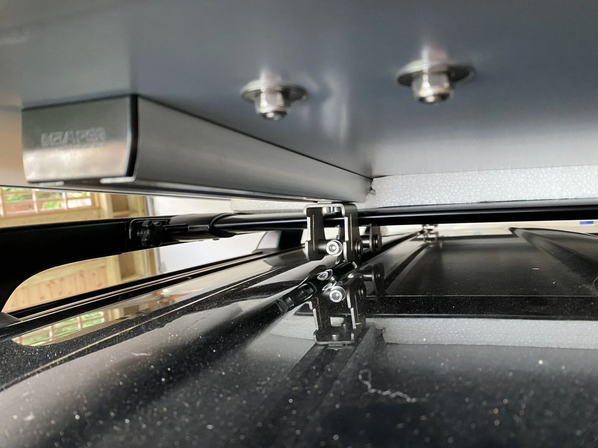

This issue isn’t only that the stock cross rails may not be up to the task of supporting a tent this large it’s really that the way the iKamper brackets work they’re basically sitting in the roof. Tent doesn’t touch the side rails at all even. Tents a iKamper SkyCamp 2.

Tighten them up and roll it. The tension bolt is not supposed to be engaged with the bottom of the bar. The brackets will pinch in on the crossbar and should be very secure.

If you really want to sleep in the RTT on your drive to CO, I would suggest using Thule/yakima crossbar mount on existing roof rail. This will elevate the roof rail height to support the thick bracket from the RTT.
Not sure if one of the pic show the RTT bracket actually denting your roof, or just pics reflection.
