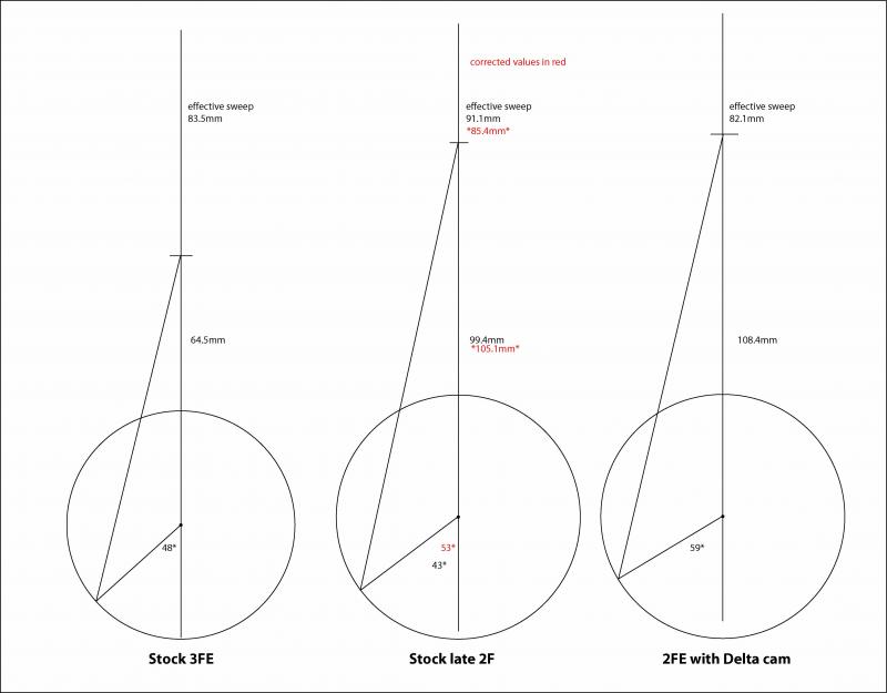

Some geometry fun from early this morning.
I've been playing around with the dynamic compression ratio, which is the idea that a true measure of the compression in the engine takes in the timing of intake valve closure. If the cam timing is changed (i.e. longer duration), you change the effective compression ratio (i.e. drop), and that's why engines that use long duration can run higher static compression ratios. This is detailed in Dalton's book, and is used to help decide a safe compression ratio to run with an "upped" cam. By keeping the dynamic compression in line with what is seen with the stock chamber volume and cam timing, you stay in a safe zone despite monkeying with both of these parameters.
So looking at the Fs, here are three diagrams that I used to figure out the swept volume of each configuration from the point of intake valve closure on the compression stroke. All is done to scale, with the 3FE having a stroke of 95 mm and a center to center connecting rod length of 148 mm, and the 2F having a stroke of 101.6 mm and a rod length of 190.5 mm. Intake valve closure is 48* ABDC for the 3FE, 43*(53*) ABDC for the stock 2F, and 59* ABDC for the Delta regrind posted up by Dave-T in the first camshaft link in post 1.
So, from the effective sweep for each configuration, the following has been put together. I've assumed that the late 2F (2F with world market 3F head) has a stock compression ratio of 8.3:1 (posted by Jim elsewhere). You might notice I am calculating for the 2FE now. ;)

Stock effective sweep: [STRIKE]91.1mm[/STRIKE] (85.4mm)
Effective swept vol: [STRIKE]632.2 cc[/STRIKE] (592.7cc)
Dynamic compression: [STRIKE]7.55:1[/STRIKE] (7.14:1)
2FE with Delta cam (59* ABDC intake close)
effective sweep: 82.1
effective swept vol: 569.8
for effective compression of [STRIKE]7.55, squish vol: 87.0 cc[/STRIKE]
for dynamic compression of 7.14, squish vol: 92.8 cc, 77 cc chamber volume, 8.6:1 static compression
for dynamic compression of 7.24, squish vol: 91.3 cc, 75.5 cc chamber volume, 8.7:1 static compression
[STRIKE]CC vol: 71.2 cc
static compression: 9.1:1[/STRIKE]
So it looks like with a longer duration cam, [STRIKE]9.1:1[/STRIKE] 8.6:1 should be pretty safe on the 2FE. If someone can let me know what is a safe static compression to run with the stock cam, I can push the numbers a bit further (although static compression of [STRIKE]9.1:1[/STRIKE] 8.6:1 sounds pretty high already).
