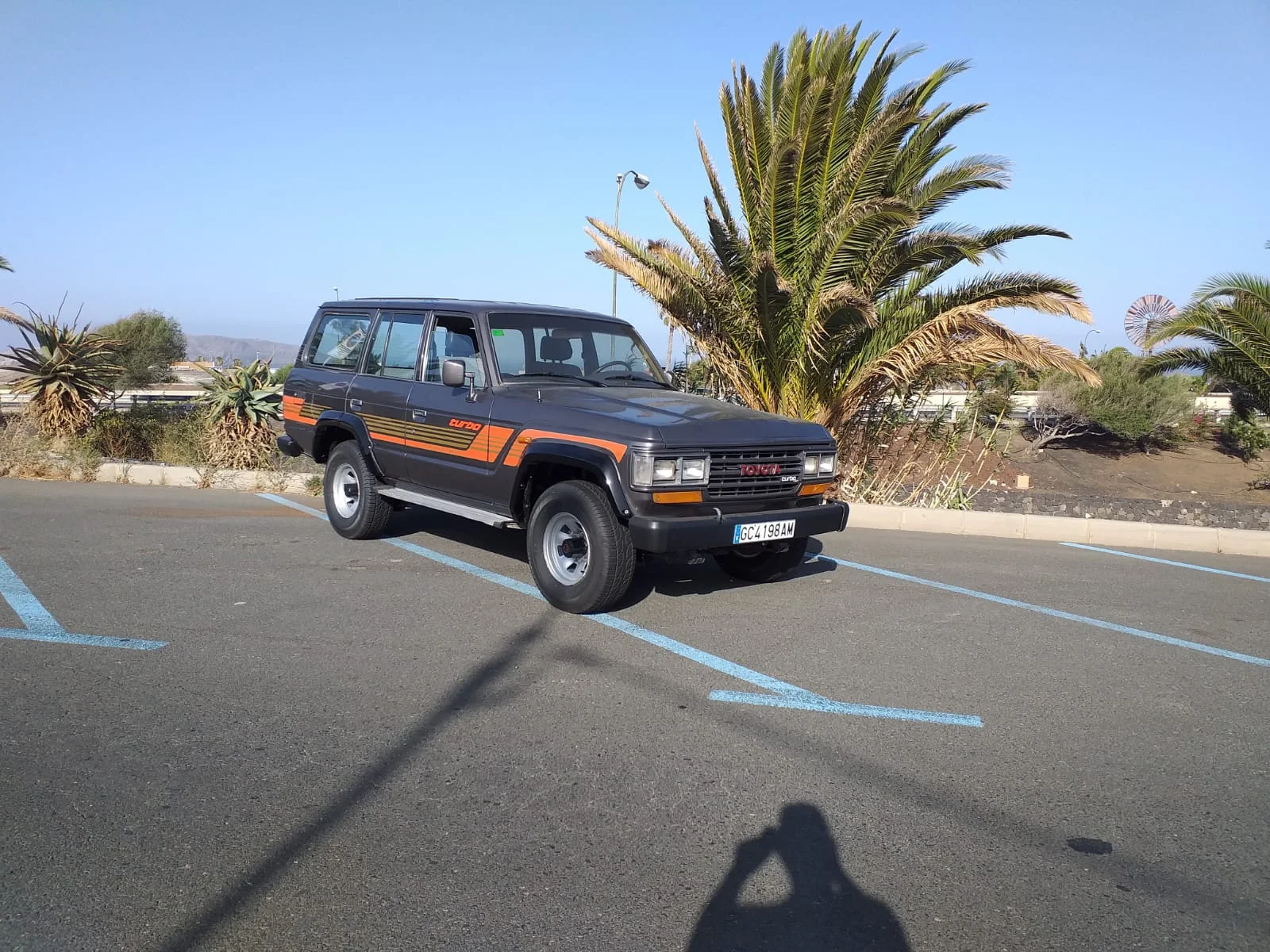

I just picked up my 61 at the port today and saw it for the first time. The transaction and shipping happened just as Anthony from Canarian Landcruiser Exports said it would. He seems very knowledgeable about all of the logistics, and really came through quickly to troubleshoot a few things. A couple things that I wish were different...I wish I were copied on all the emails with the shipper, rather than getting a few screenshots here and there. Also, now that I see my 61, I see Anthony’s role differently than before. For me he was simply a broker...connecting a buyer and seller. I thought he was vouching for the condition of the vehicle, but I now realize that wasn’t true for my case. I wish I would’ve had more inspections done to assess the condition of the vehicle. It’s not as good as I had hoped. To be fair, I could’ve asked for more. I think I misunderstood his role. I was so excited about getting the 61, I don’t think I really did my due diligence and ended up making an emotional decision. There’s always another car, but at the time I really wanted this one!! And I’m honestly a little disappointed with it’s condition.
I like it. What was the unexpected?
So far...
-headliner different color than rest of interior
-Tachometer doesn’t work
-4wd slow (minutes) to disengage
-Fuel gauge doesn’t work
-No rear seat belts
-Leaky rear diff
-Leaky front seal around pulleys
-Leaky transfer case
-Rust colored antifreeze
-Fuel tank vent issue (crazy slow to fill)
-Front left suspension clunks over by bumps (haven’t sorted through what this really is yet)
Power locks don’t work
-driver side mirror falls off
-a/c doesn’t work
-missing rear washer spray nozzle
-rear lift gate hydraulic inoperable
-who knows what else
I’m sure a lot of these won’t be difficult to sort through. And it’s more than 30 years old. I’m thrilled to have an hj61 with a 12h-t!
my point is more that, I didn’t really do a good job assessing the condition in advance. I relied on Shane for that, not recognizing that he was brokering only. My rookie mistake, and I’m owning up to it. He was awesome at logistics.

Sorry to hear about your troubles. It’s a damn fine looking truck.
Looking on the bright side, the body looks straight and I'd imagine it's not rusted out underneath. That's two huge pluses. The rest can be sorted out.

Mate if it makes you feel any better that colour with those pinstripes/decals is probably the coolest combination in Landcruiser history and it has a 12ht.
All that stuff that's wrong is fixable, and nearly all of it you can do yourself. There is an unlimited amount of knowledge on this forum with people who are willing to help.
I know its not a drive off the trailer weapon but once you have fixed all that stuff up your going to appreciate it a million times more.
Awesome 61! I'd have paid good money for that even in that condition.

Adding rear seat belts from a US-spec FJ62 is pretty straightforward, I had to do this on my Venezuela-spec FJ62 back in the mid-90s when I first imported it. No Venezuelan 60 came with rear seatbelts from the factory, but the dimples for the bolts were stamped into the body so it was easy to locate them. In the grand scheme of things (i.e. 30+ year old vehicle from a completely different market), that one is a minor thing. The gas shocks for the rear hatch are also super easy, you can get them on Amazon. The door locks are most likely the switch unit on the driver's door, that also a fairly common fail over the years but it could also be the actual solenoids. Not a difficult fix. Finding those Euro-spec mirrors might prove to be tougher, though.
