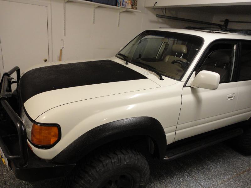

Next on the list was to apply Durabak. I really liked how the old rig was lined (on the hood and on the flares), so I wanted to do the same on this one. The old rig had been Line-X'd, which probably would be my preference, if not for the price. I ended up doing the hood, the flares, the rocker panels, and the bottom part of the doors. I'm happy with how it turned out. Gives it a unique look. Got the flares mounted back up tonight.
I used the Durabak-18, which has the UV protection.
It's not perfect, but I'm happy with how it turned out.
You're making some nice progress Adam, it's looking really good! :clap:
What kind of prep work did you do before putting the durabak on? I've been thinking about doing the same to my flares (yes, I'm in the minority that think the rig actually looks better with the flares).

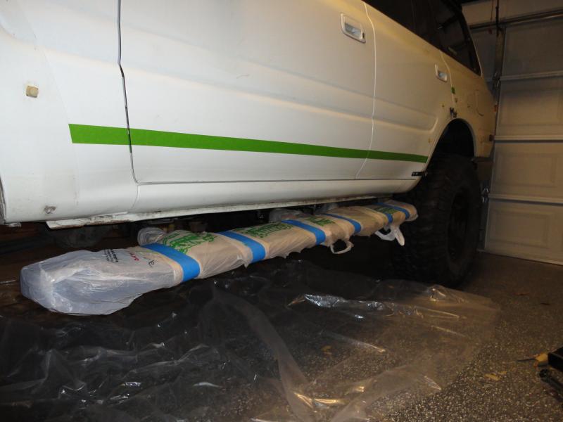

Thanks guys. As for the prep work, I removed the fender flares, sanded down the areas I wanted to paint to rough up the surface, cleaned all the surfaces I was going to paint, and let it dry overnight in the garage. Next day, masked everything off and covered up the sliders (I loosened them up and let them hang down some), rather than removing them, and started rolling it on with the special roller that it comes with. I used "frog" masking tape (available at Home Depot) since I had heard from some that it was supposed to prevent bleeding and give good straight lines. I did three coats on the hood, two coats on the flares and rocker and lower door panels. I also put one coat on my homemade cargo drawers since I had the paint.
Oh, and make sure you pull the masking tape off right after you apply the last coat. I read enough horror stories of people not pulling it off while it was still wet.

I hand sanded it. Used one of those 3M sanding pads from one of the local Kragen/O'Reilly shops. It said it was for paint prep / body work. I would guess it probably was an 80 - 100 grit. I just wanted to rough it up some so it would adhere. I'm sure the paint prep purists will weigh in on the proper way to do it, but we'll see how it holds up for me.
Definitely spring for the extra amount to get the Durabak product with UV protection.
