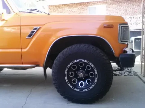

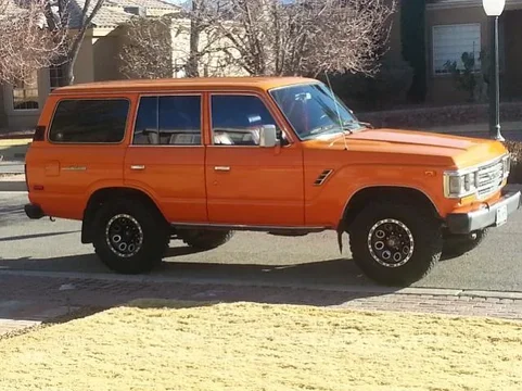

I'm running 32-11.5 on 15 in rims. 33-12.5 would rub while off roading or on hard turns. I think 33-10.5 would be alright. Here's I picture of my setup
those are h3 rims. you're gonna need huge 2" spacers to make them fit. and after all that work, they'll look terrible.
I have 32x10.5 Super Swampers on stock wheels, and a 100% stock suspension, and they only rub at absolutely full flex in back. For what it's worth, they're a 'true' 32" tire, rather than the ~31.5ish that most 32" tires measure out to.
The rubber overdrive is nice, but the SS tread is quite loud (speeding up on a freeway onramp sounds a lot like taking off in a small plane.) Mine were siped, so they're pretty good on wet/icy pavement. Great offroad, but that goes for any tires with giant lugs.
I think the H3 rims would look great painted black, spacers aren't bad just depends on the offset. Push them out too far from the hubs and you can get premature wear. That said, buying spacers woyld probably negate the "good deal" you got on H3 wheels.
Plus the hub bore is too small, they wouldn't fit up front anyhow.
