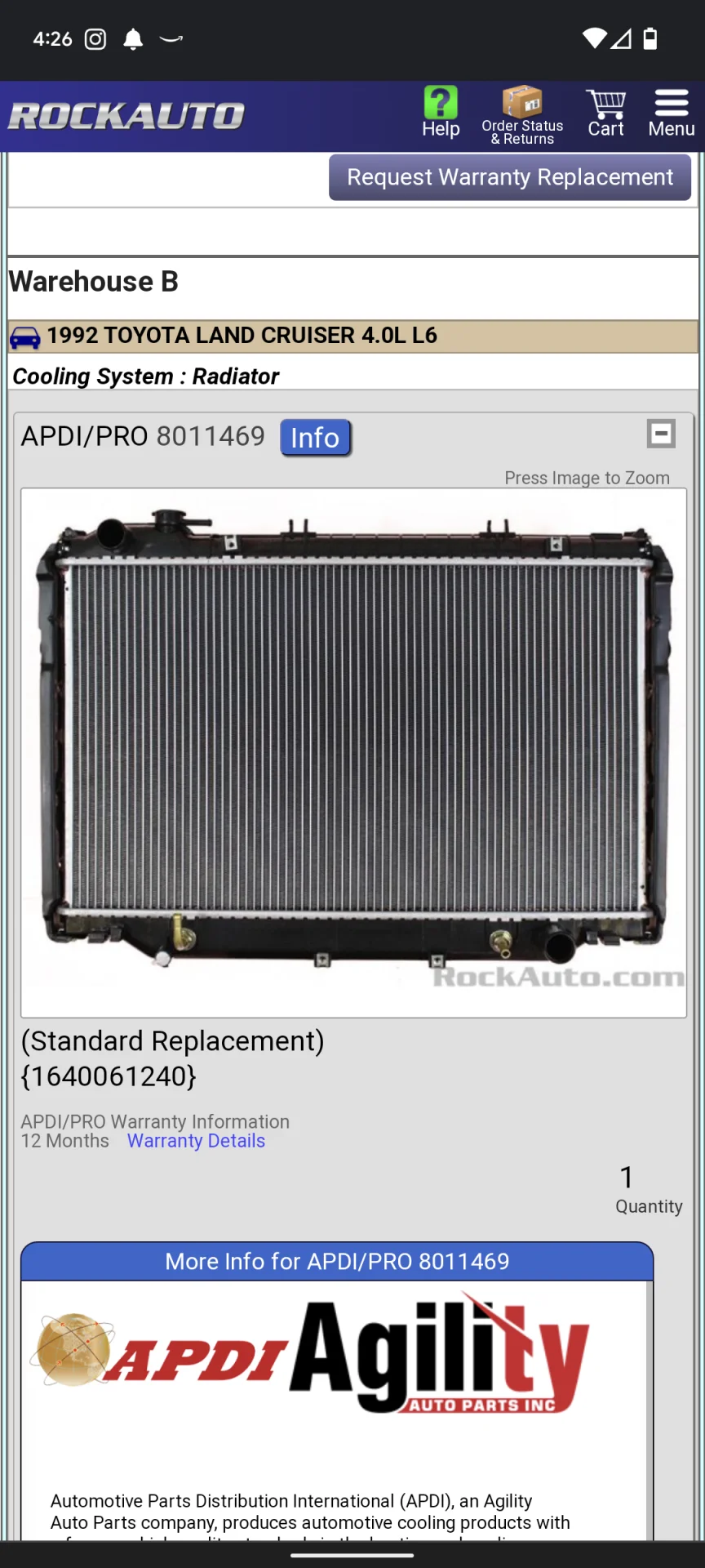

My radiator was a generic replacement from rockauto. Looking at getting an aluminum 3 core one as a replacement. I just did the clutch last night with the green hub and it is a slight improvement over my old one... By slight I mean 2 to 3 degrees cooler, but not enough.
Try adding thicker oil to the green hub and see if your temp improves? Which Rockauto radiator? I see they have a Liland Unit in stock. I would go with their 2 core alum unit. I am currently running the Liland unit, it is much cheaper than Ron Davis, and i have both and the Liland cools just as good as a $1400 unit. Avoid cooper/brass radiator. They are not adequate to cool these rigs loaded up with stuff
This is the one I got.. what oil weight do you suggest for the clutch
For the small bump in price why not the 3 core?
Try a different radiator. You could also try running 40% coolant to 60% water mix. Pretty common in warmer climates. You would still be good down to -10F.....
