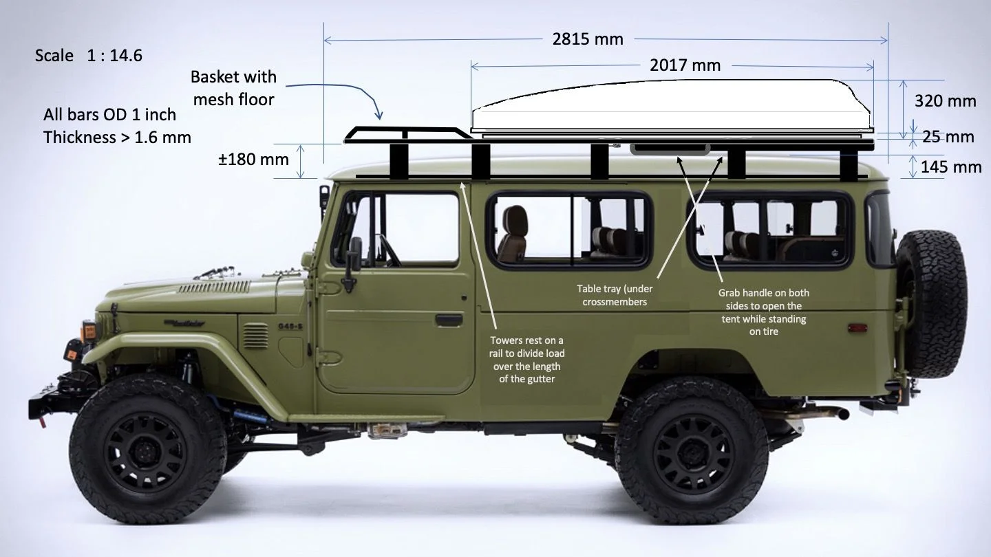

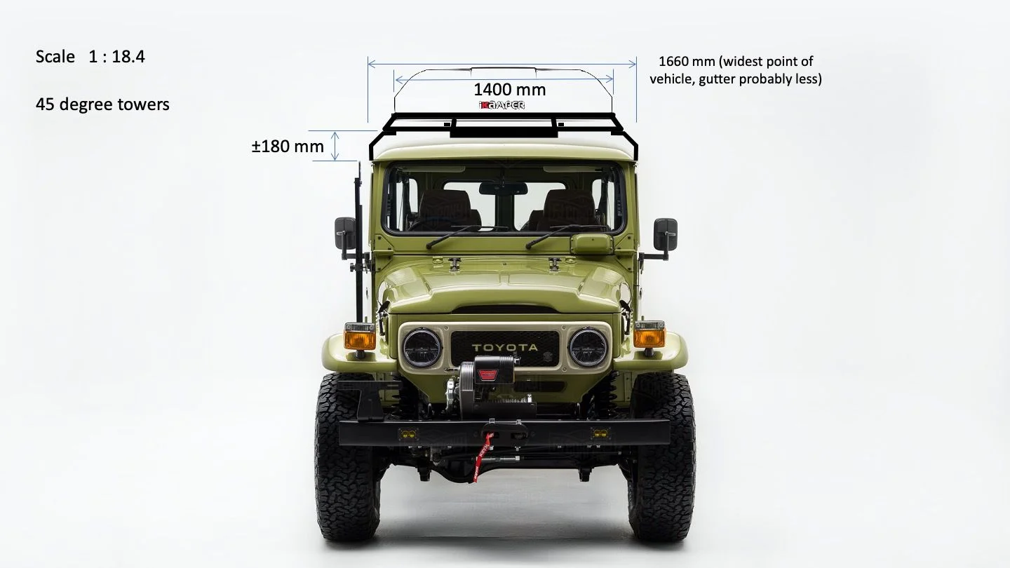

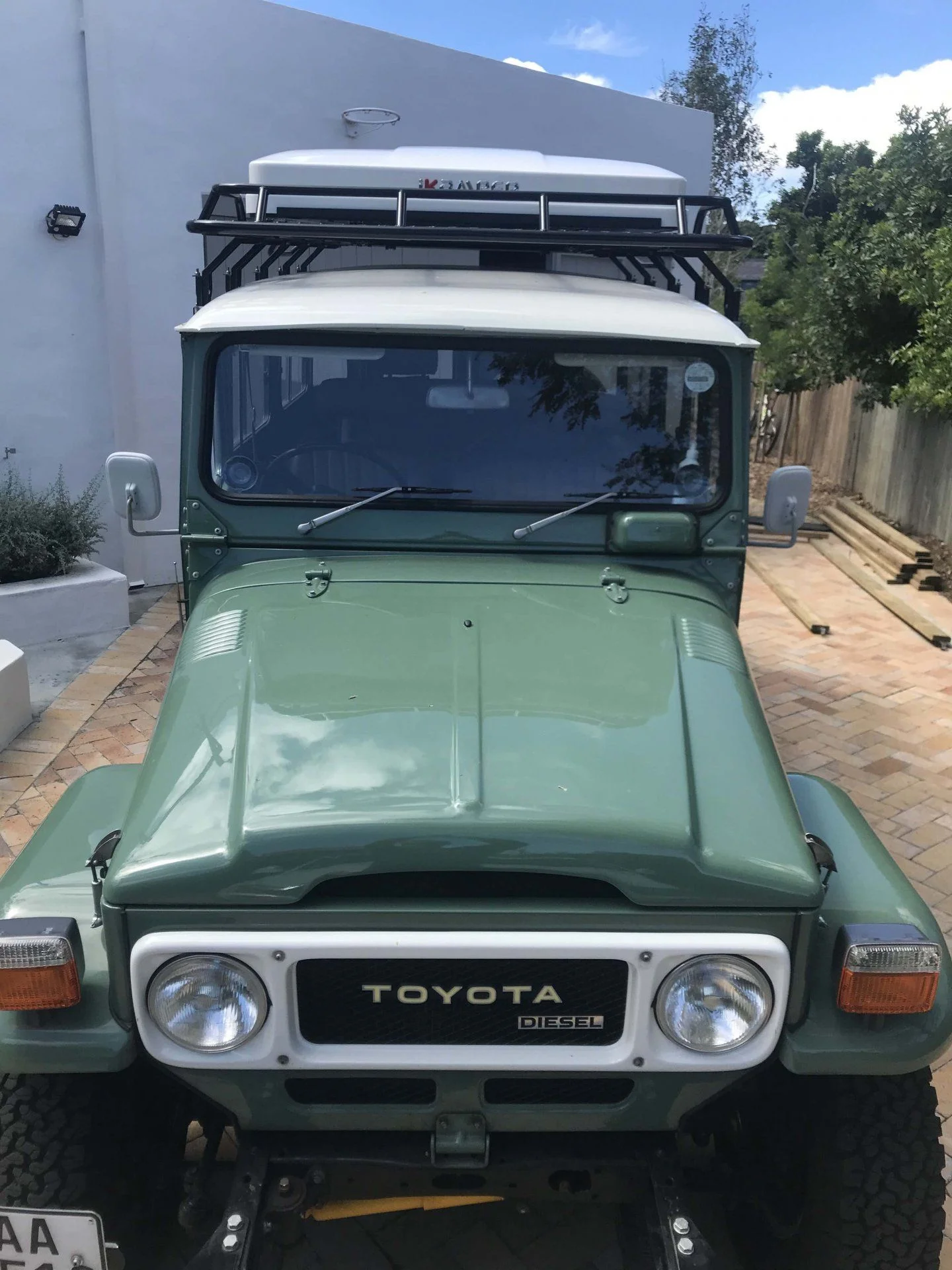

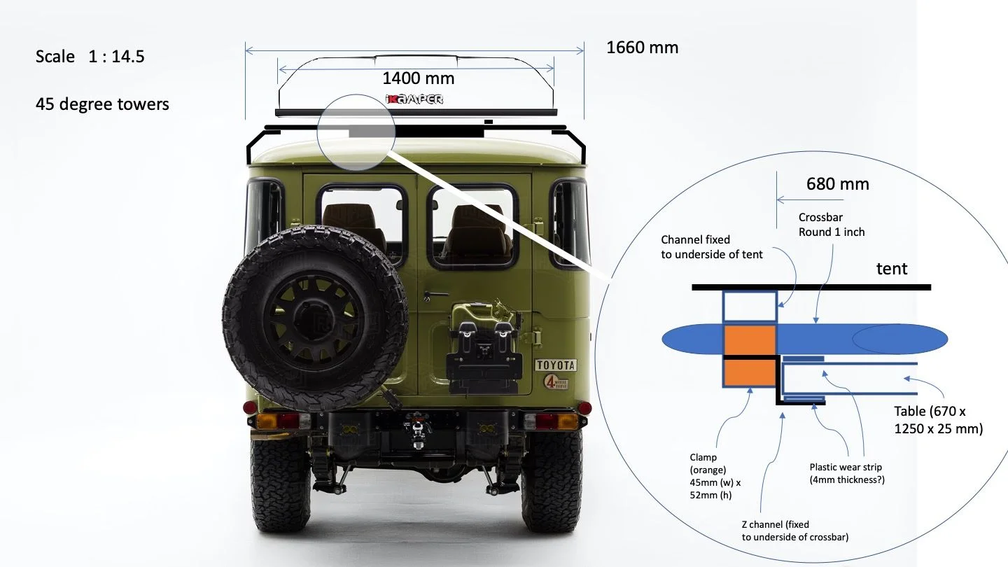

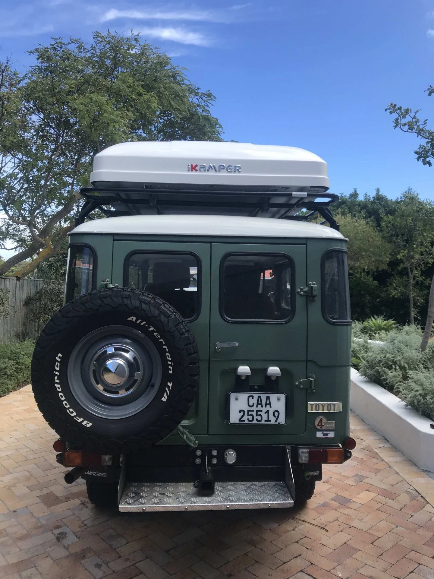

OK, so that search came up empty so I designed the rack myself with some help of FJ company (for the pictures of a HJ47), iKamper (for the RTT dimensions) and Tim from Gamiviti for his ideas. Attached is the result. Let me know what you think. Rack should be ready in a few weeks and I will post some pictures when done (with and without RTT)
Looks very clean. I like it a lot.

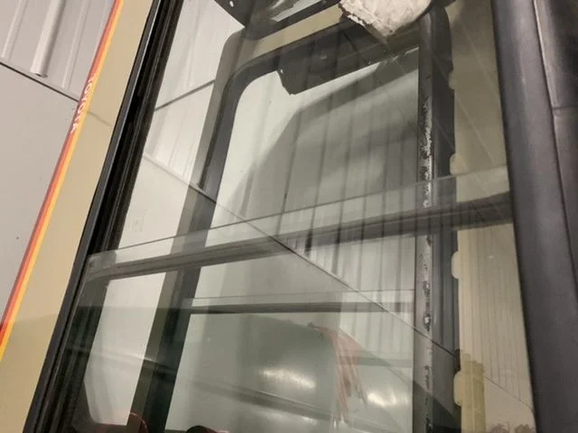

Here is a picture. It is the chrome section that is attached to the glass of one of the panes of the sliding windows. It holds the felt strip. Cheers
Glad you posted up!
Which vertical divider are you referring to?
I found some promotional material that shows that the chrome strip is mounted on the inside. Mystery solved! Nice material by the way. Pity it only shows the front and not the interior/rear etc.

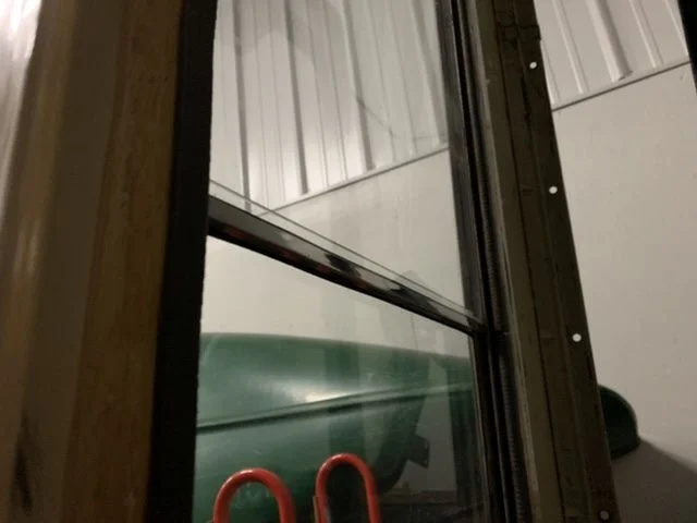

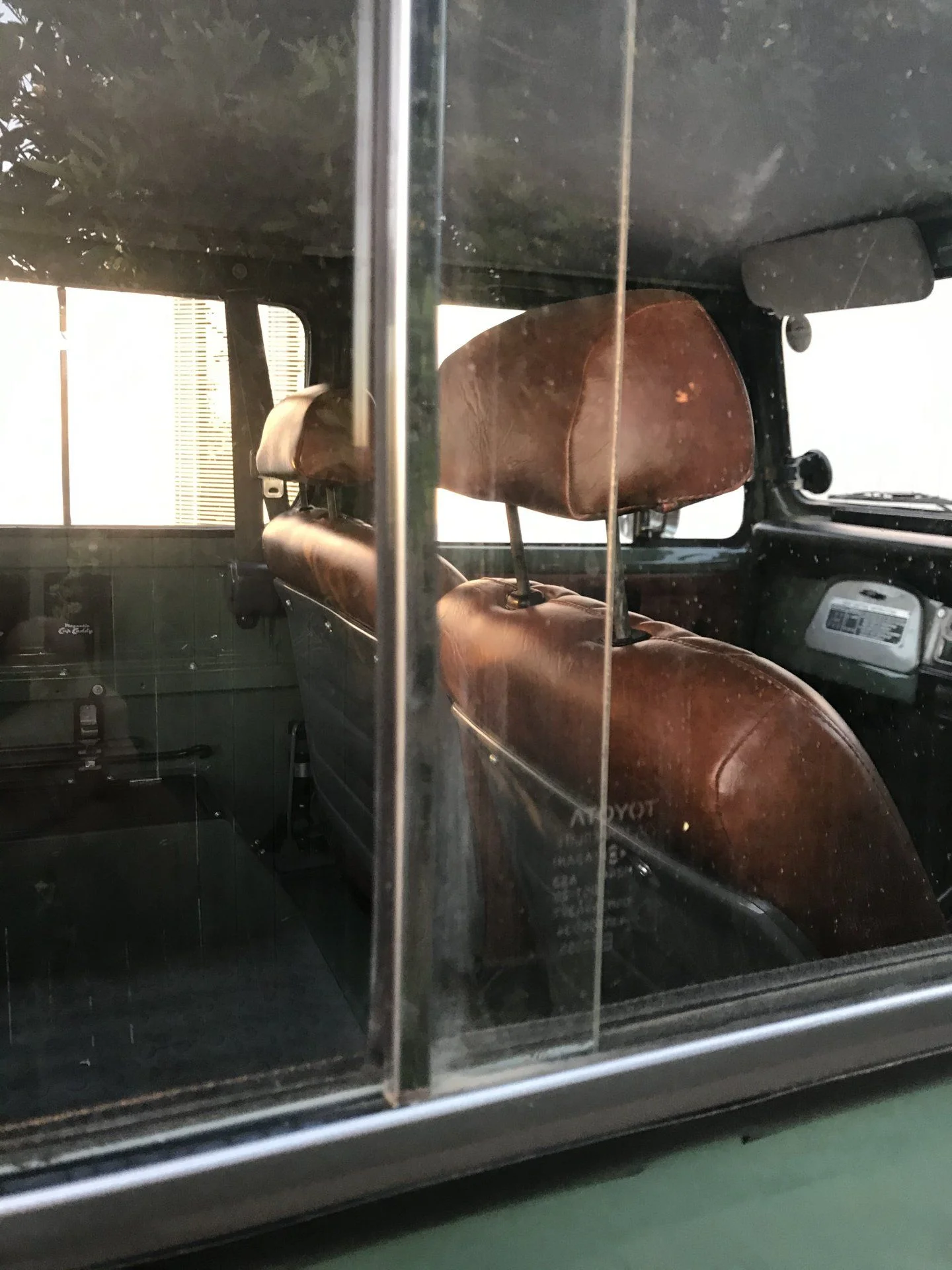

Sorry for the delay on this. Yes, the chrome strip goes on the inside (I’ve never noticed that strip before!). Here are some pics:
Outside:
Inside:

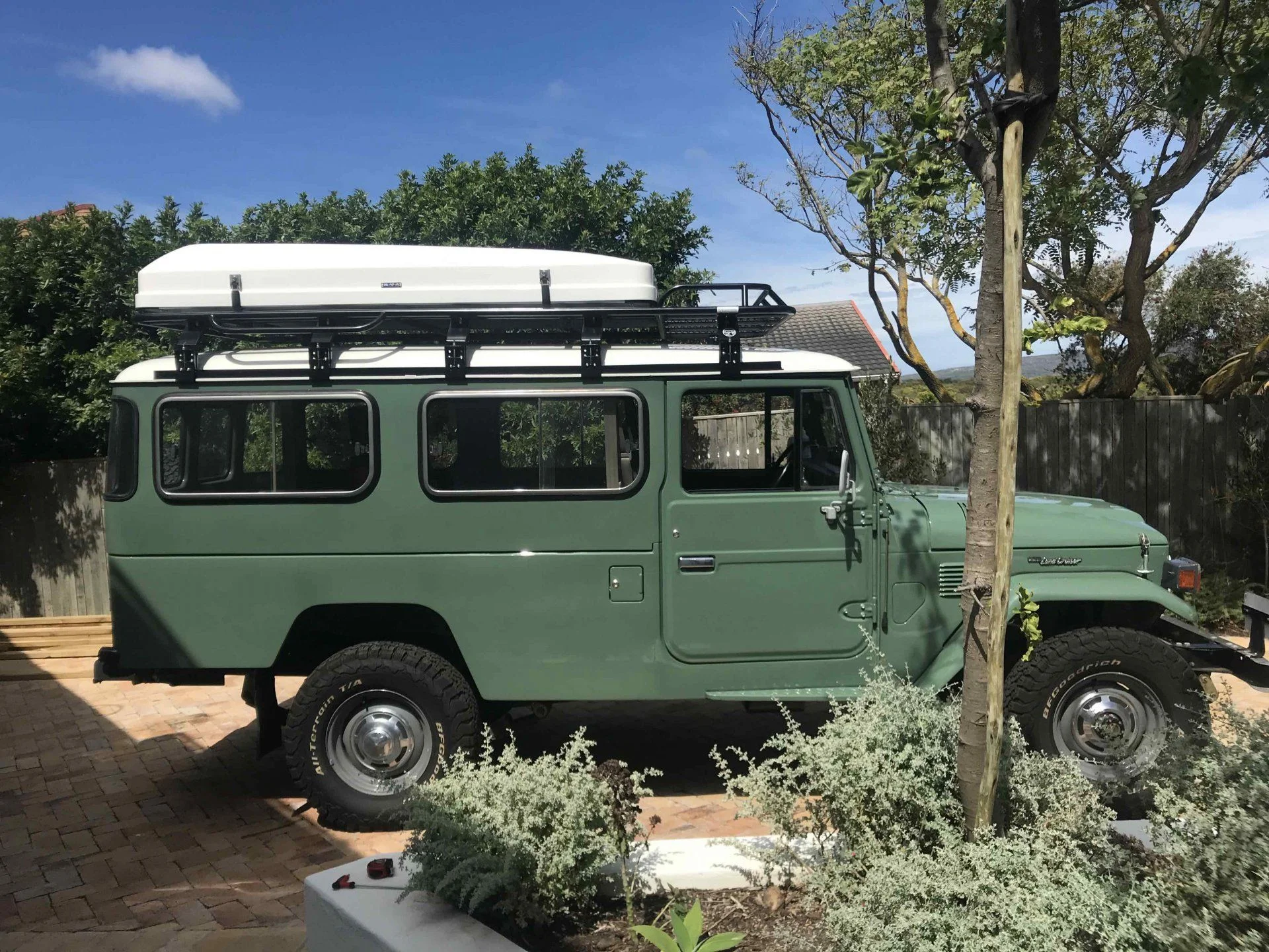

This looks really great! I'm thinking of building something with a similar design with the frontrunner system. I have two quick questions for you:
  • How tall are the towers you used and about how much clearance do they give between the roof and the rack? I'd like to be able to put the Frontrunner table under the rack. It looks like you've got plenty of clearance without the rack sitting too high.
  • And I really like the rail you used running down the gutter to distribute the weight. Is that just a steel rail, or what'd you use there?
