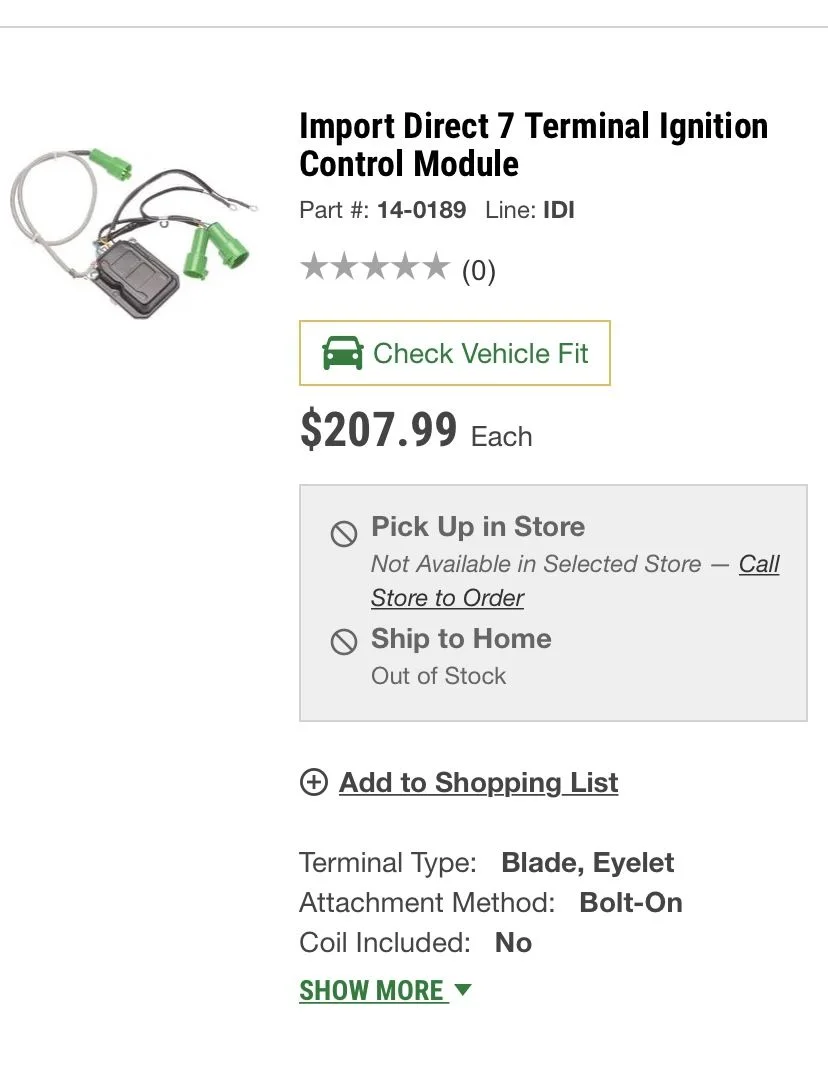

I need an igniter for 88’ model pick up. Checked o’riley, Napa, rock auto. Found a couple used on E bay but prefer new. All tell me out of stock. Attached is the one I need ...any suggestions? Thanks
The last I checked it might still be available from Toyota ... for about twice that price.

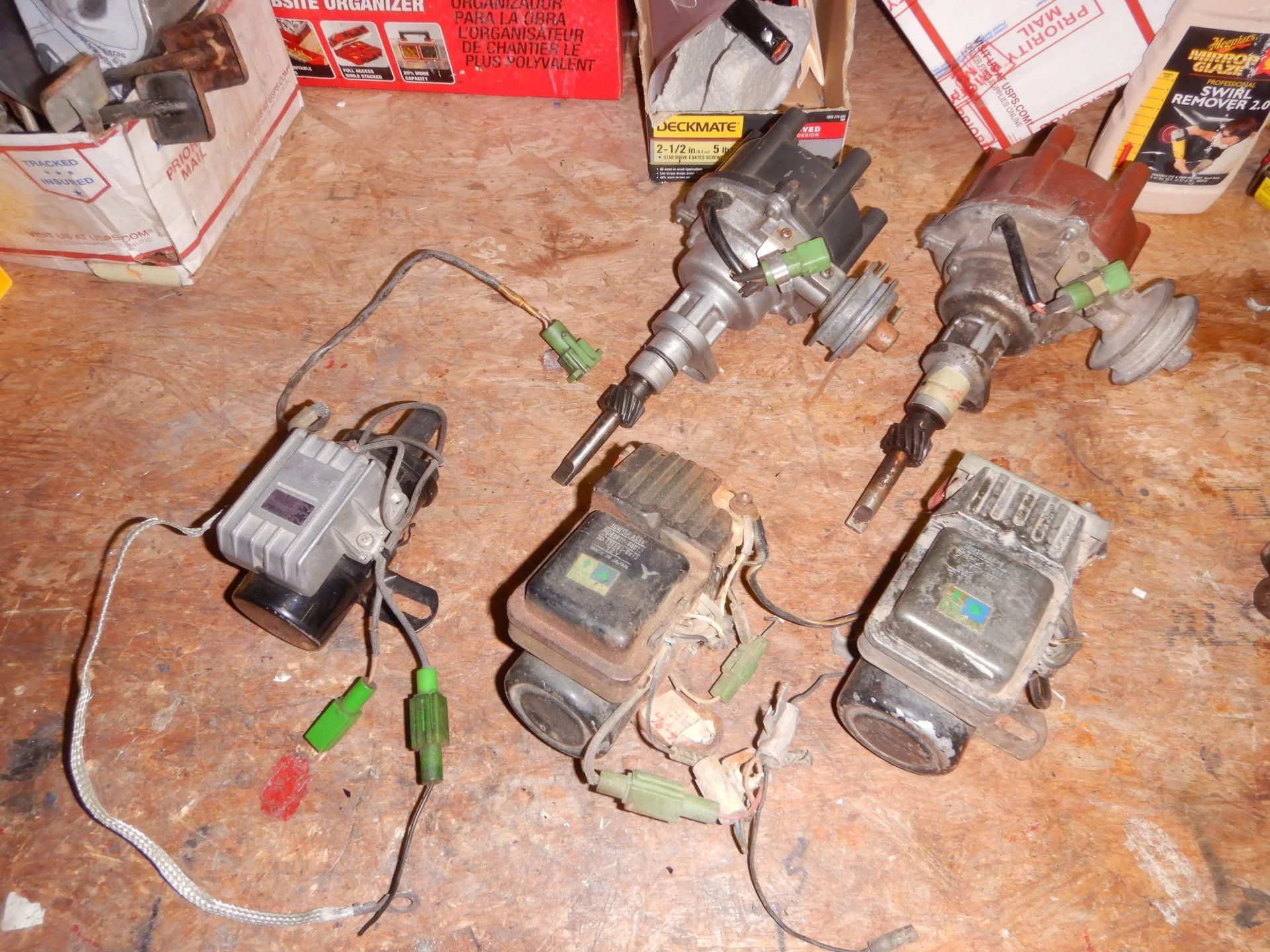

would a FJ40 or FJ60 fender mounted one work for him ?
if so i have some verified working order
No idea. I think not for the same reason I don't think a carb'd ingiter from a 22R would work. What do the connectors look like? Plus, he said he wanted new.
Im pretty sure you can use a 22r igniter on a 2f and vice versa. Be cheaper to try out that used one before sinking $200 bucks in a new one. There are also distributors with built in igniters.
1988 Toyota 22R igniter at Rock Auto is $281.79 plus shipping. Made by Standard Motor Products - Intermotor.
