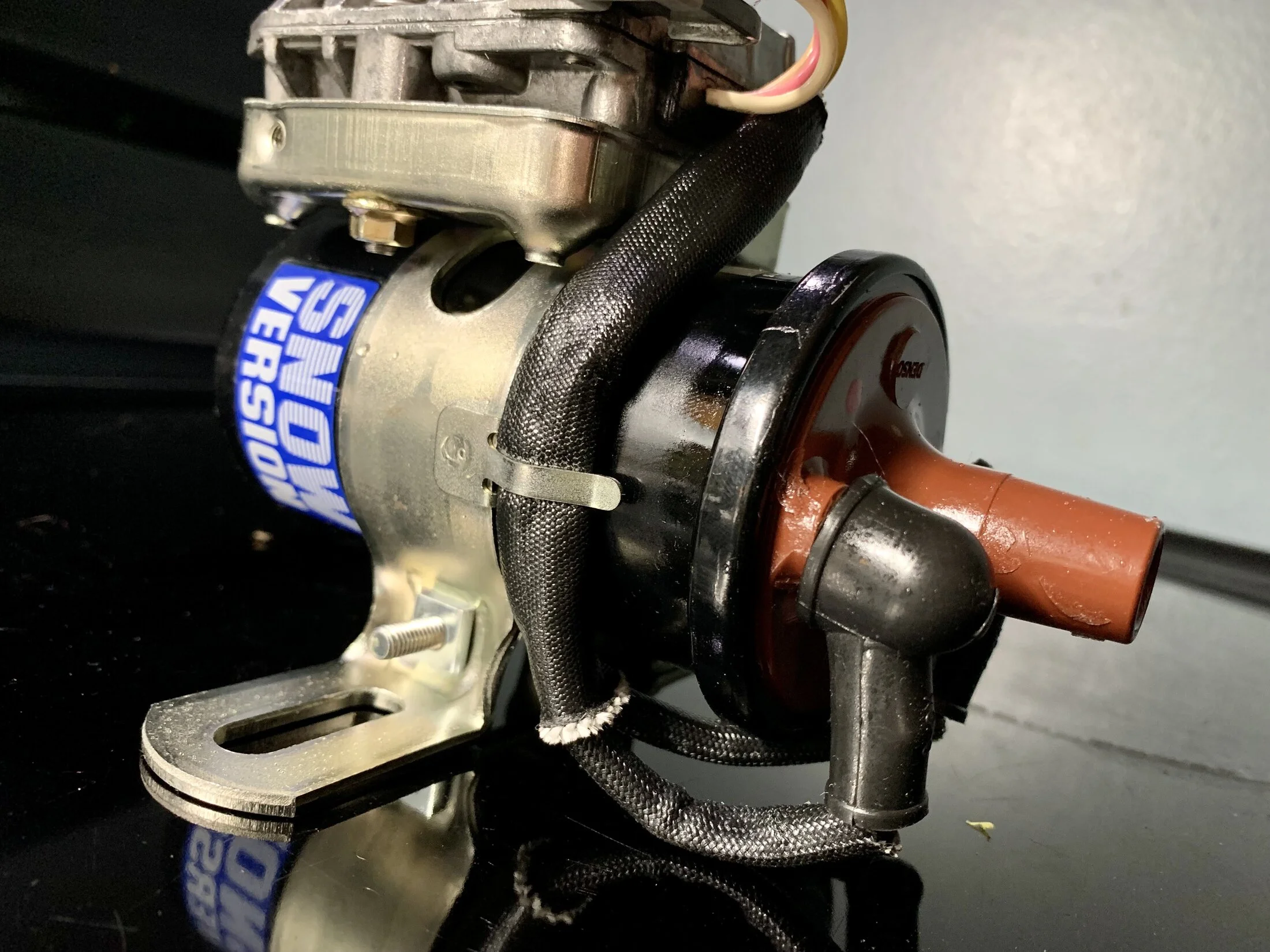

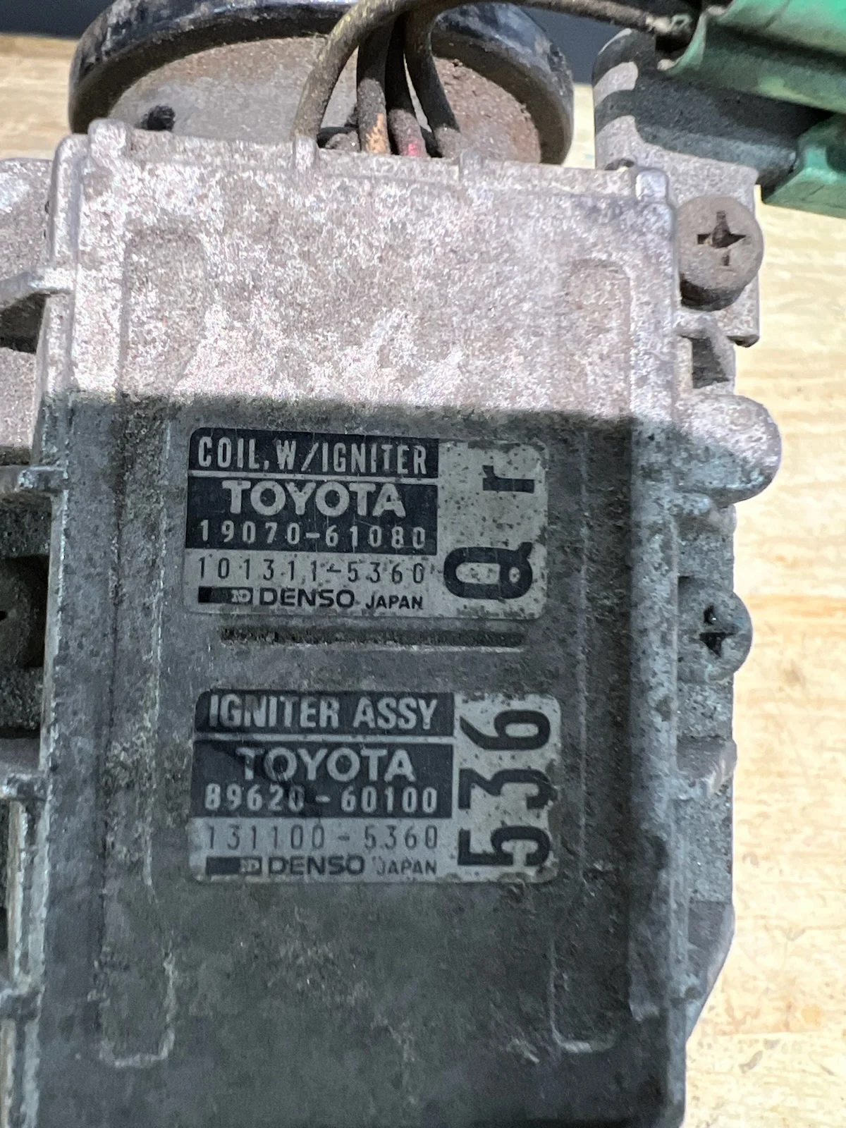

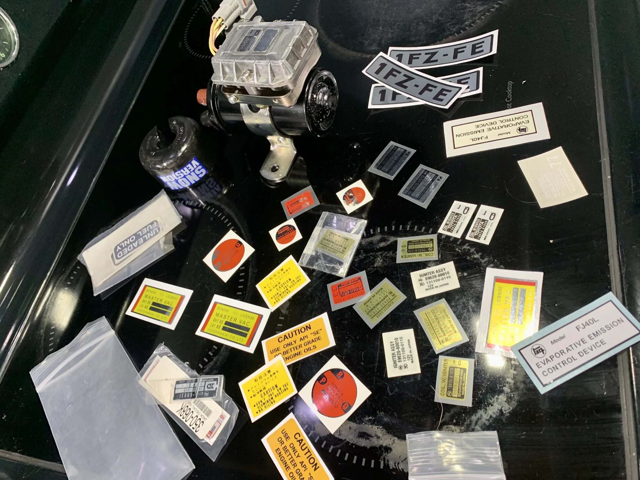

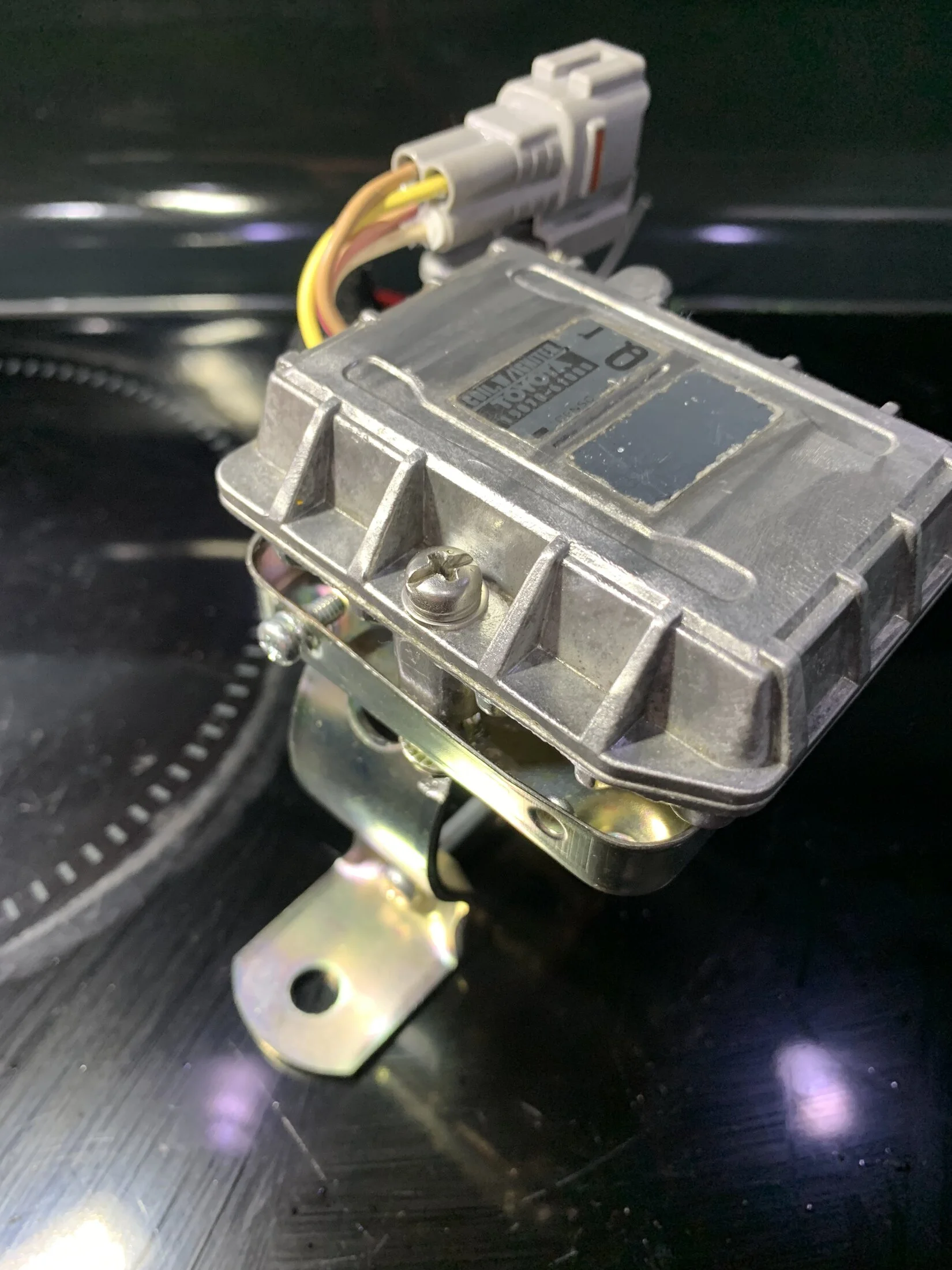

I'm looking for a replacement for my Igniter & coil. Part numbers: 19070-61080
Pic attached.
I have one and can film a video of it installed and running on a FJ62 later today.
$150 + a $200 core charge returned when you ship your coil/ignitor back to me assuming they are intact.

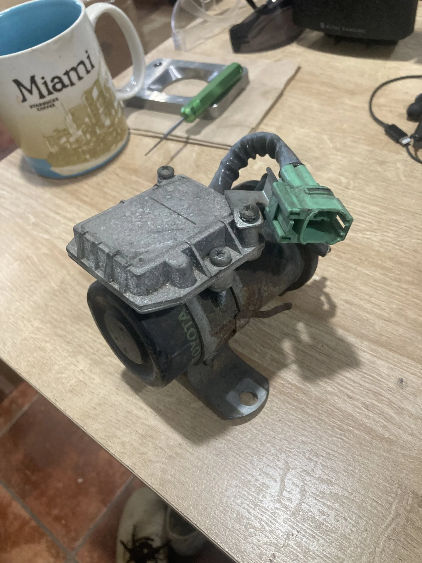

Hey BKSwim75, if you still have the igniter, I may want it. Or, maybe you could answer a question. I have no spark from my ignition coil. I replaced the igniter a couple weeks ago and the truck ran great. I took a short road trip, got back, parked it. When I went to start it, I found myself in the same situation, the truck cranks like a champ, but no spark from the ignition coil. I've checked all the voltages/ resistances to and from and everything is with in range given in the shop manual.
Any thoughts?

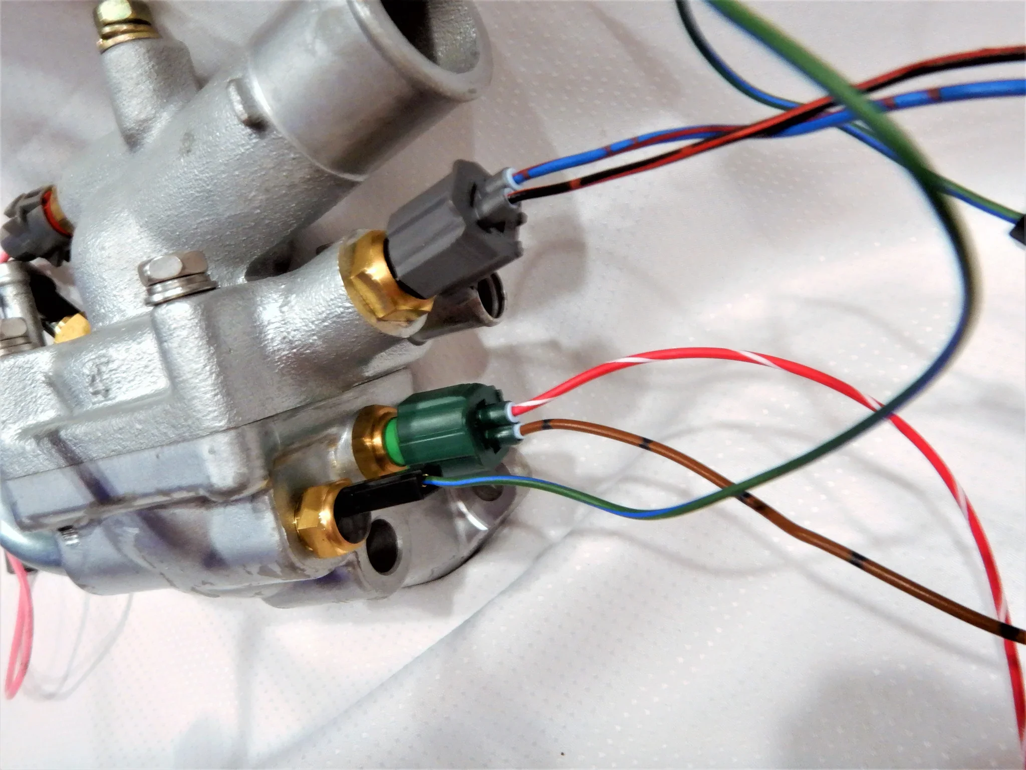

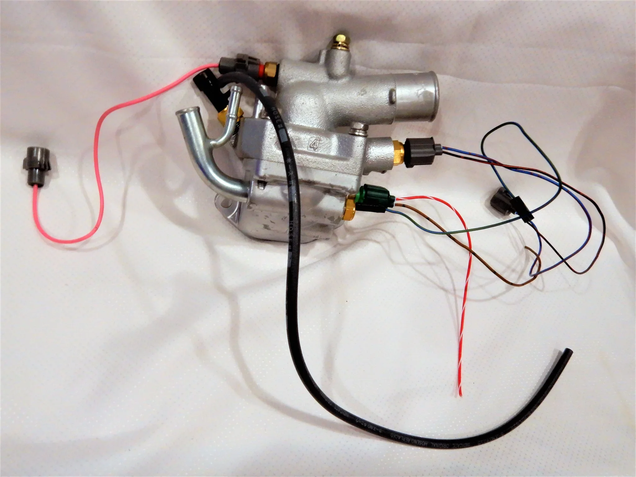

you replaced the water pump on your FJ62 3F-E and now itt will NOT start up upon engine cranking .......correct ?
so what you did and what happen is you have severed one or more of the various Upper & Lower thermostat housings Sensors and sending units , plugs , wires or broke off the crusty end of the sensor itself ....
this set up is directly above the water pump , and just like
all of us it became place to stage tools and parts , and then a place you needed too sift though because the pile got a bit big mid-job ....
see my tech example pics , start here and make DAM certain all is 100% normale and in good working order ?
this is the way ......

Thermostat connections all look good.
