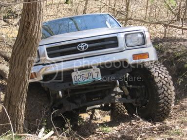

huh? works fine for me...running 33's no rub....rockcrawling and trail
