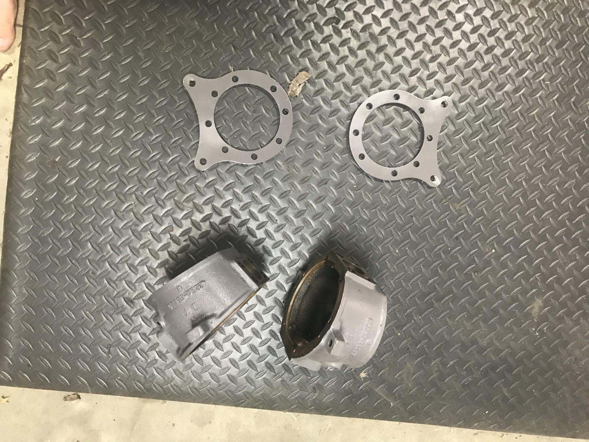

So with the Tacoma brake kit the factory brake mounts don’t work. So you use a mount a mount that bolts onto the spindle. You flip the knuckles so the factory mounts don’t interfere with the caliper. With this you get A bigger brakes. And B 8 bolts and the hub is off of the knuckle without taking the whole hub apart.

Before
After
