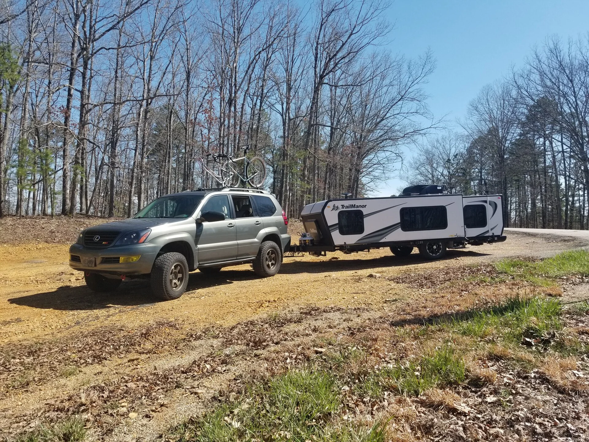

I watched your video yesterday. I could have predicted your experiences, although I haven't towed a camper that big. The GX is an adequate tow vehicle, but not an enthusiastic one. It's only a 281 cid engine, after all.
Nice video! We went through this exercise too and settled on a 3,100# dry TrailManor. After watching I'm glad we didn't go with a larger and heavier camper!
Another great vid Jake, thanks for your 'real world' review of towing with the GX!
nice video. man i can't believe you pulled all that weight! don't think i'd wanna pull more than 4k lbs max with this thing.

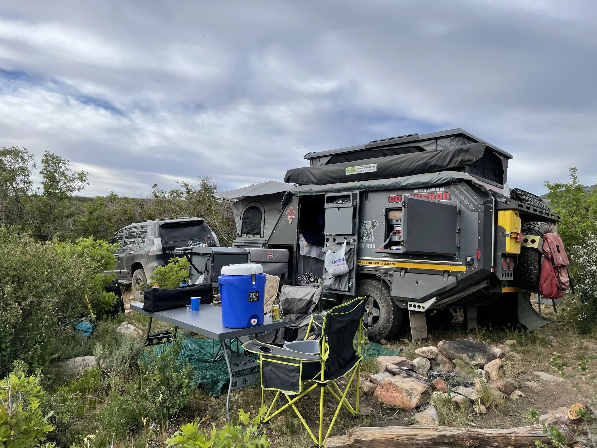

I echo all the sentiments about the GX towing - it *will* do it, but not with any authority. It is heavy enough that it never feels twitchy, but somewhat underpowered for real towing.
I pulled one of those "Aussie off road trailers" (weighing ~4200 loaded) from Dallas TX to SLC UT and back - averaging around 9mpg. At altitude it struggled - there were inclines in CO where I was floored doing 45 or 50 mph.
And @jakemccurdy - the slide out kitchen is a MUST HAVE.
I think the frontal area makes a BIG difference. When driving 55-65 mph, 13-14 mpg is not a problem to hit with our 4K# loaded TraiManor. It just sticks up maybe an inch above the GX, but is wider. 70-75 mph on the interstate is also no problem, although the gas mileage drops to 11 or so.
It seems like folks with tall campers rarely exceed 10 mpg.

That has been a bit different than my experiences with my 470. I have a chain-style WDH with sway control, after getting it dialed (which took some trial and error), the GX tows remarkably stable and is not really affected by wind. We have narrow, steep/curvy roads around here, plus higher-speed interstates. We've towed our camper as far as 700 miles in one day (from MI to MO, all interstate/4-lane at 70+ mph), and it's overall a comfortable experience for our family of 4 (outside of foot fatigue from not using cruiser control due to the gearing/power). With the WDH putting tongue weight on the rear and front axles, it actually rides a bit better than stock and feels very planted to the road. Perhaps some of the MPG issues are a 1UR vs. 2UZ thing, but the chassis is similar between both vehicles.
Regardless of engine/platform, towing either without a WDH or a WDH that isn't dialed properly can make for a miserable experience (bad ride and lots of trailer sway).

A half-ton or larger will of course always tow better than a GX due to the longer wheelbase, usually having more power, etc. However, even those trucks are susceptible to towing issues when the hitch is not set up correctly. On the way home from buying our camper I remember passing a newer F150 who was struggling to tow a small camper (maybe 4K pounds) at 55 mph on the interstate. He had the hitch set way too high relative to the camper (limited tongue weight) and no sway control. His little camper was swaying like crazy on a flat road and pushing the F150 around. I blew by him at 70 mph with my little GX and a dialed WDH.
These tow very well when the WDH is dialed and you don't creep up too close to the 5,000 pound zone (I've driven and towed with 3/4 ton trucks as well). A half-ton truck becomes "D" league when you start getting close to the max tow ratings (and/or don't set the hitch up correctly), so does a 3/4-ton, etc. I'd say my experience is a solid "B" (with the cruise issue and foot fatigue dropping it).
