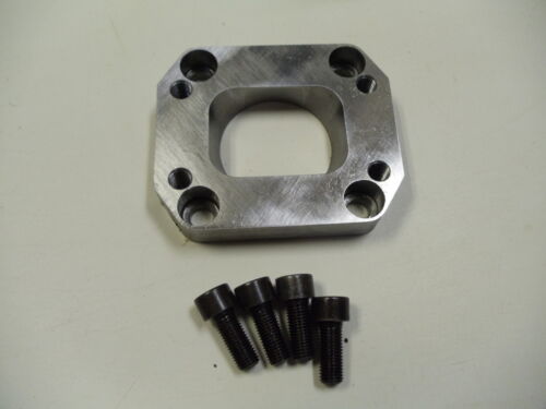

By my senses, my stock turbo starts boosting about 2200rpm, and the engine's max power is about 3000rpm, so it's a very short interval of a pleasurable drive, it would be great to start boosting from 1800rpm.
As I see, ct20 has a big square hole on the of hot part intake, but ct12 or TD04L-13T-6, has a round hole, so it leads to producing an adapter plate or something like that.
With intercooler/exhaust and tune up, I have 17psi at 2150rpm with the CT20. But yes, the TD04L would be earlier still. I think it would make a big difference.
You will have to make an adapter something similar to this to go from square to round:
