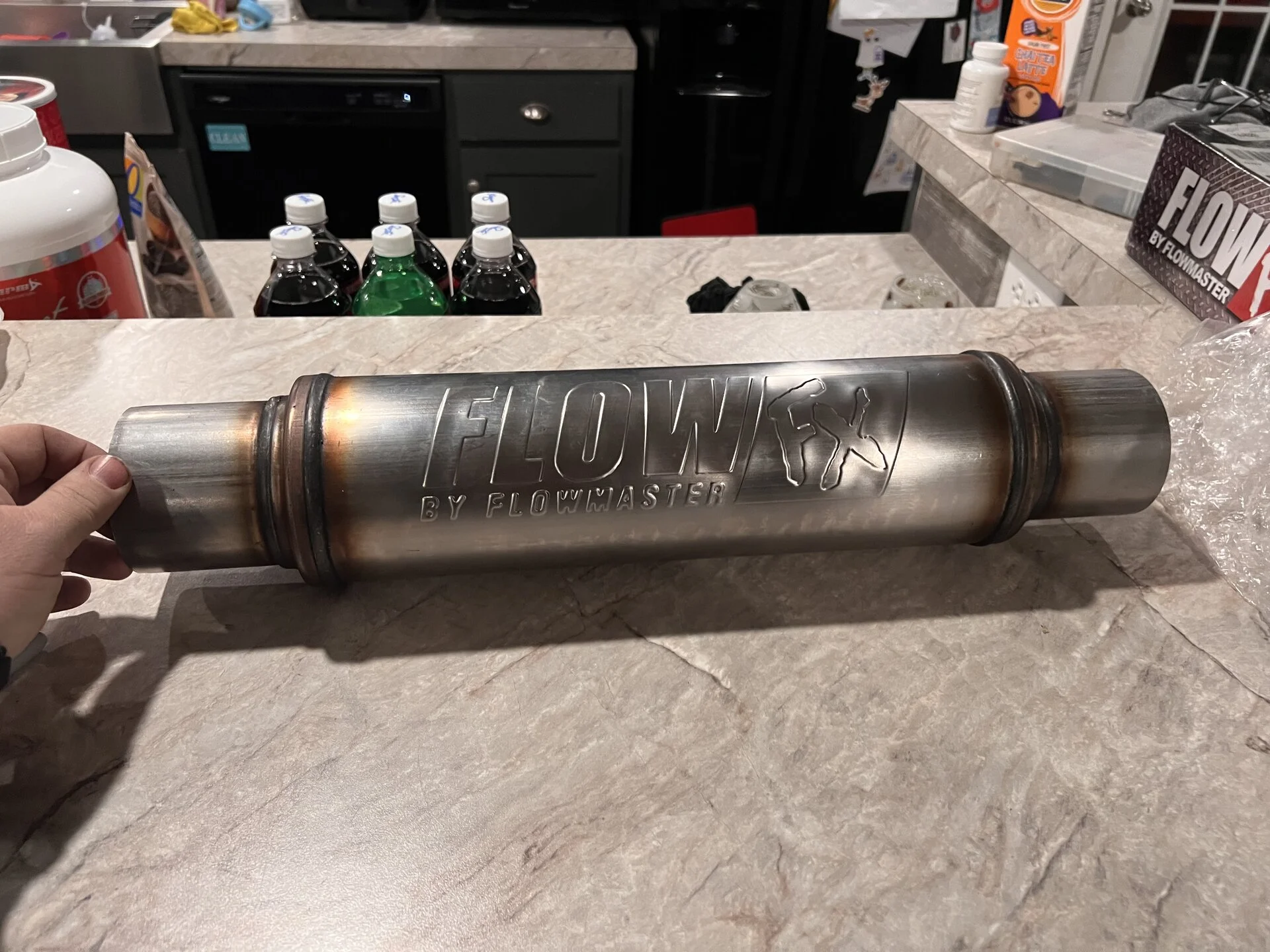

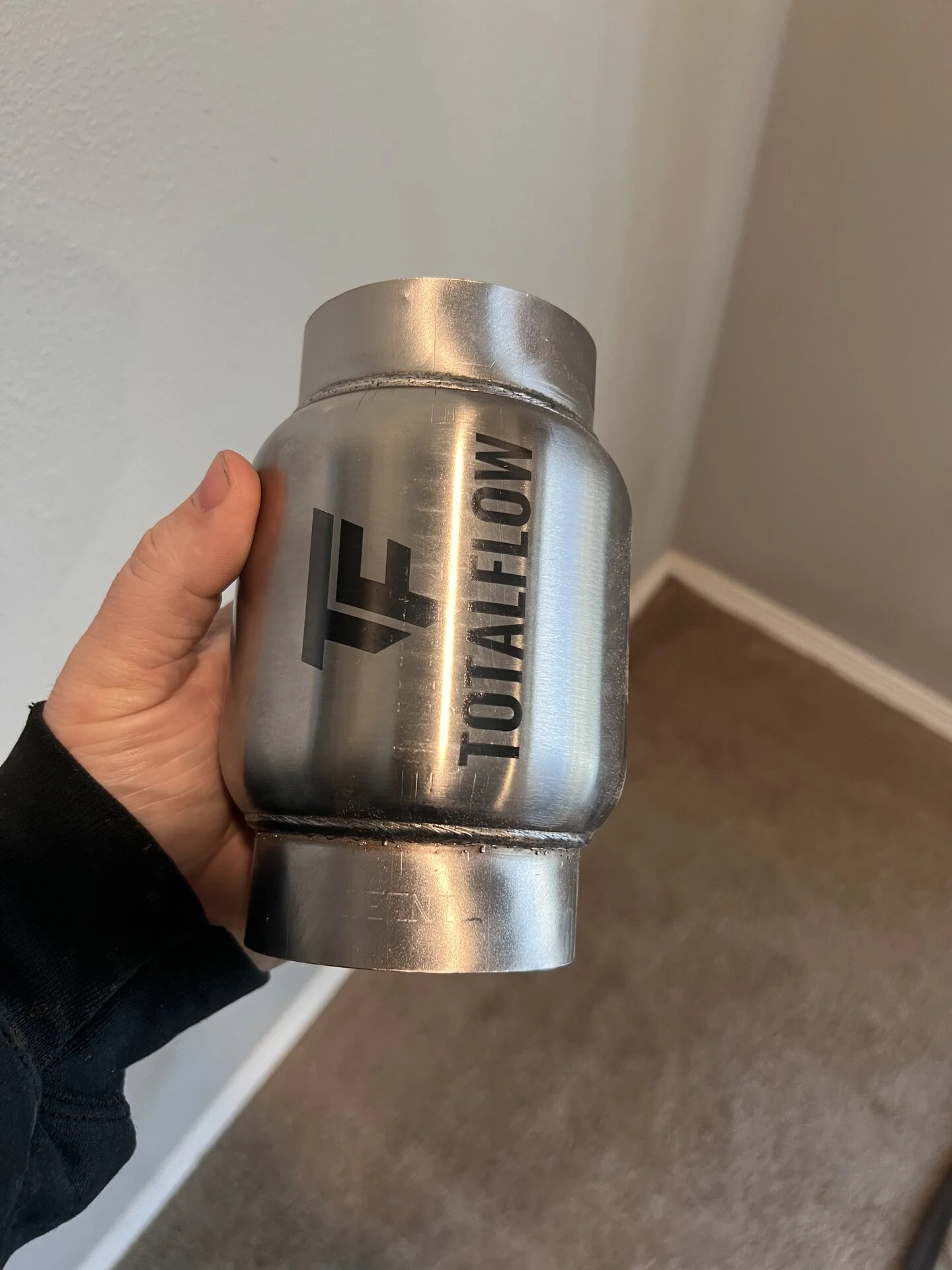

Exhaust

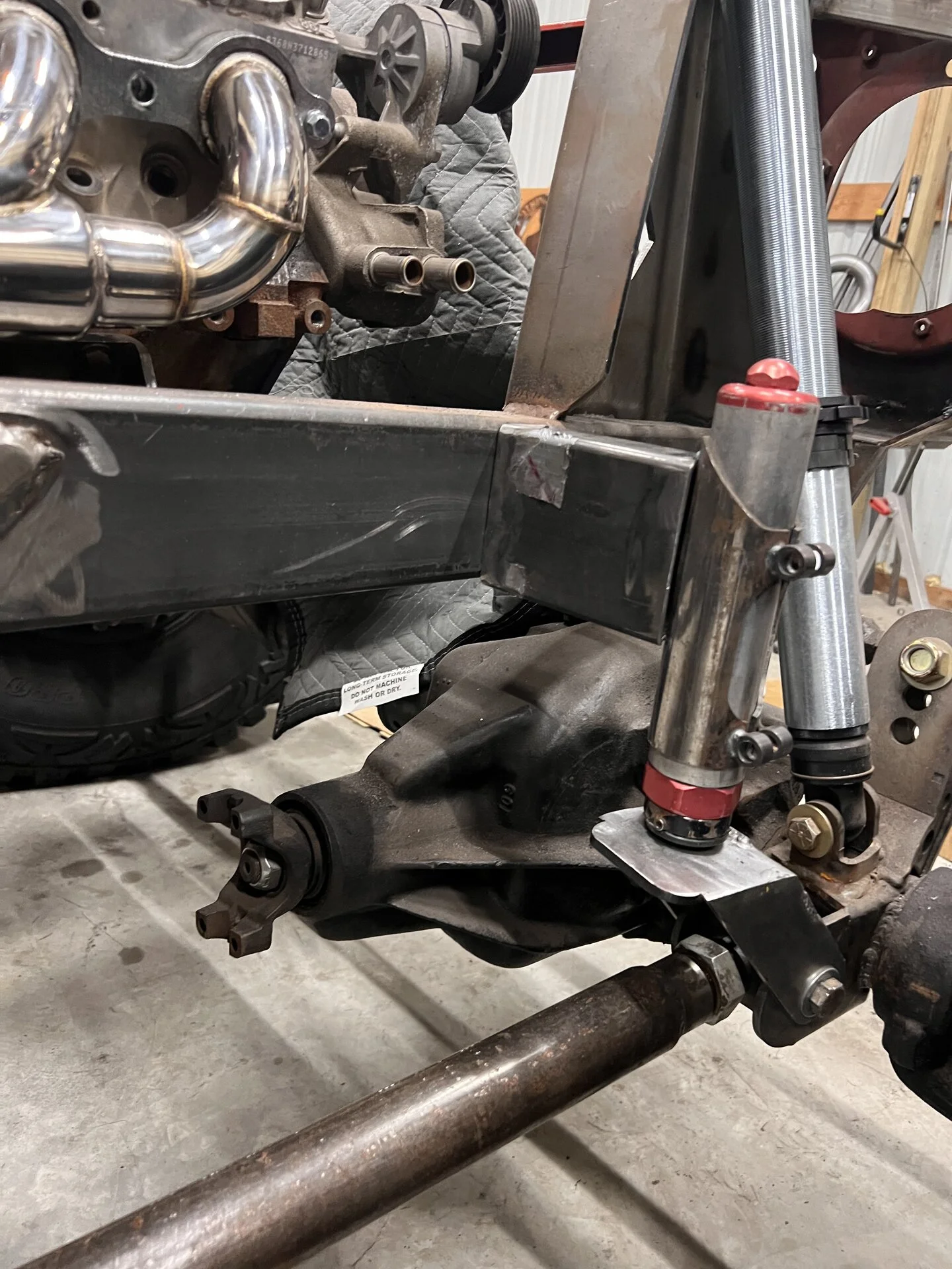

Id love to check out the four link set up one of these days. I’m just over in Teton Valley

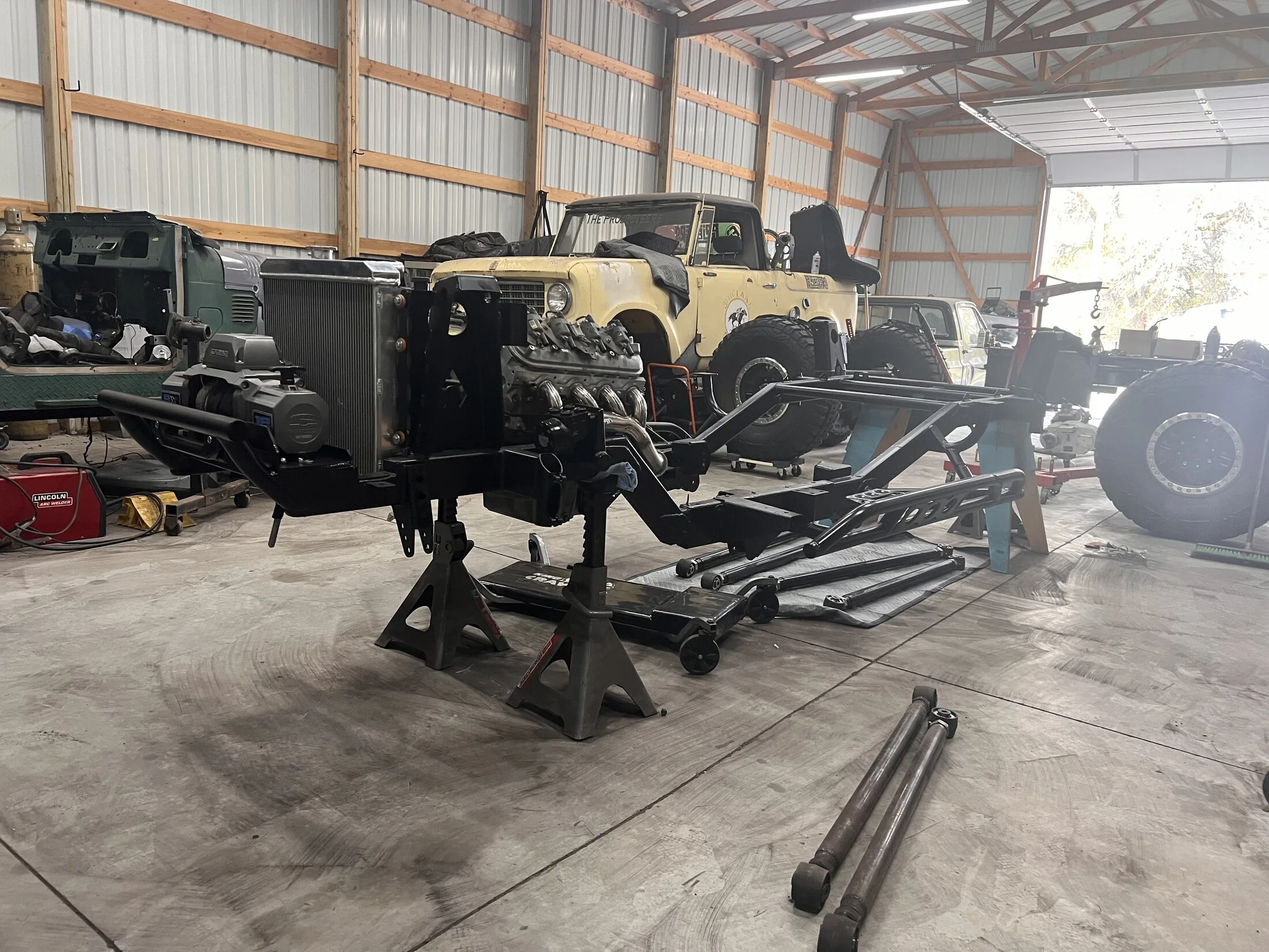

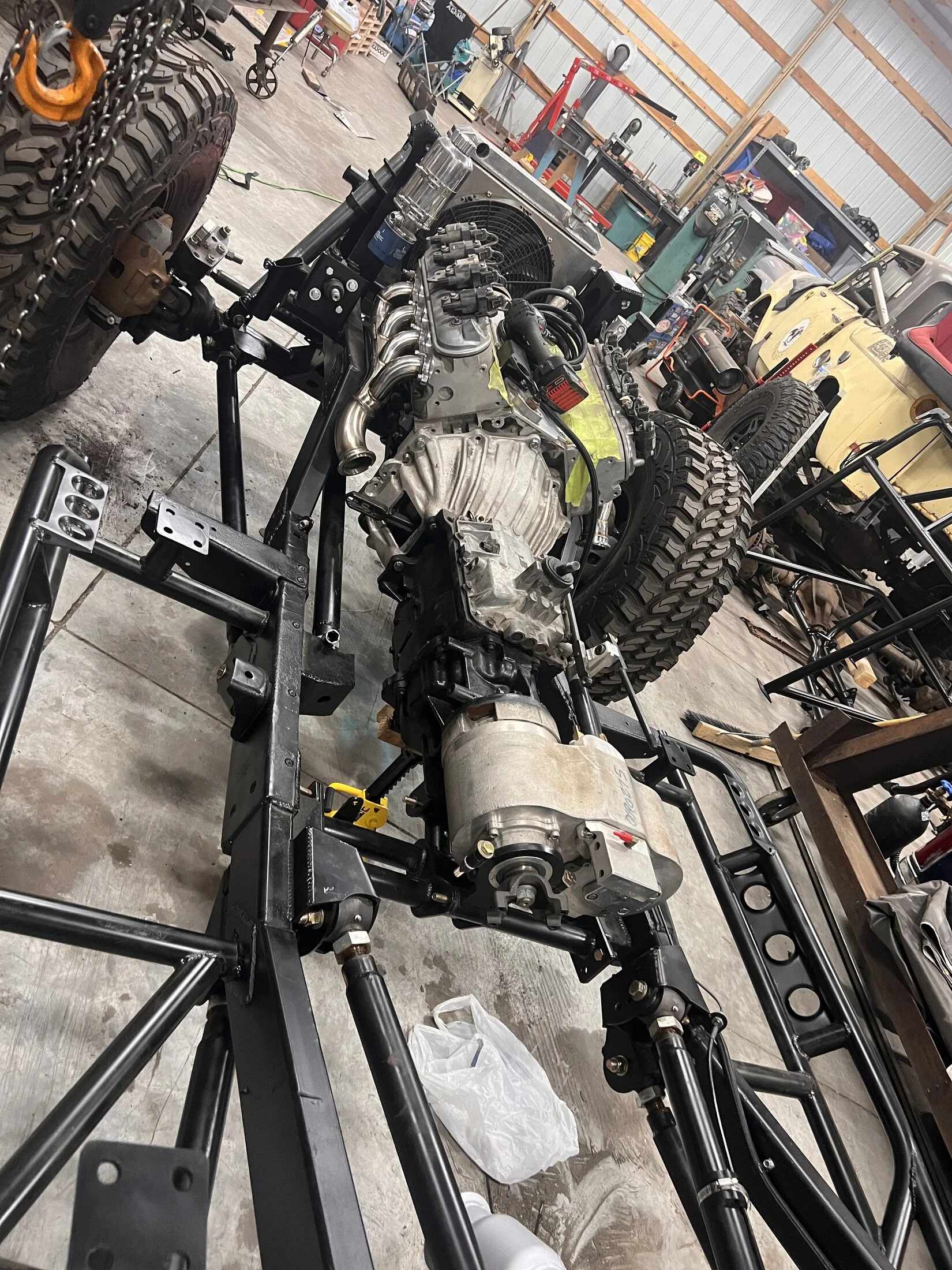

Got it back into a roller and pulled the trans about 6 times cause I’m an idiot. Was originally going to run an internal slave cylinder but really wasn’t happy so pulled it then set it of for external slave cylinder then the throw out bearing wouldn’t work because of the LS flywheel I was using. So found a bearing that would work and jammed it in. All good now

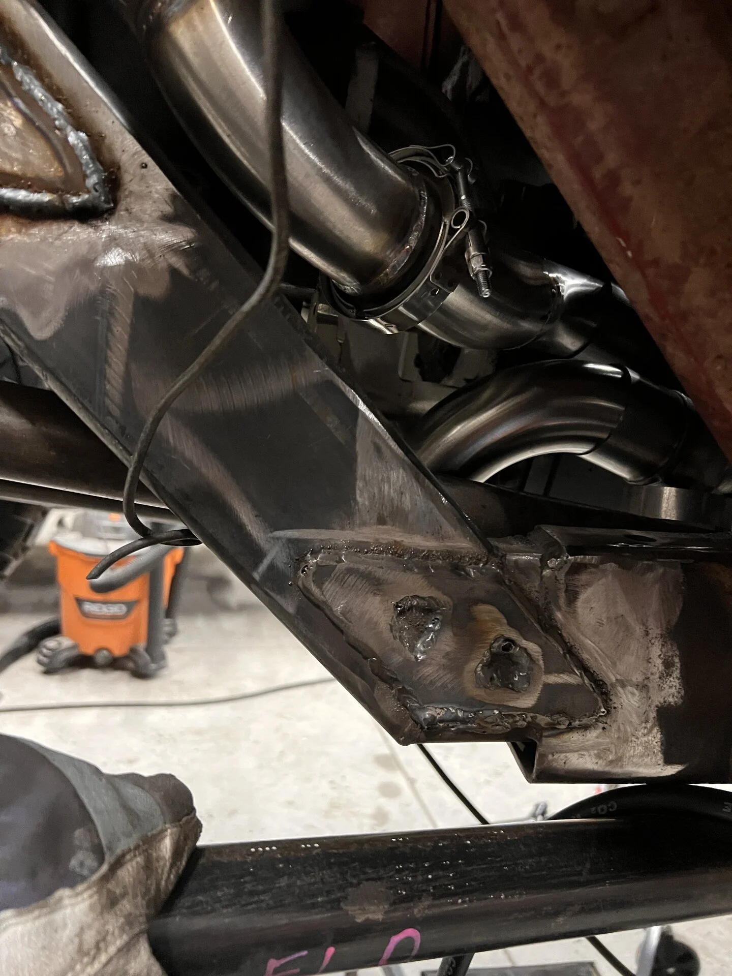

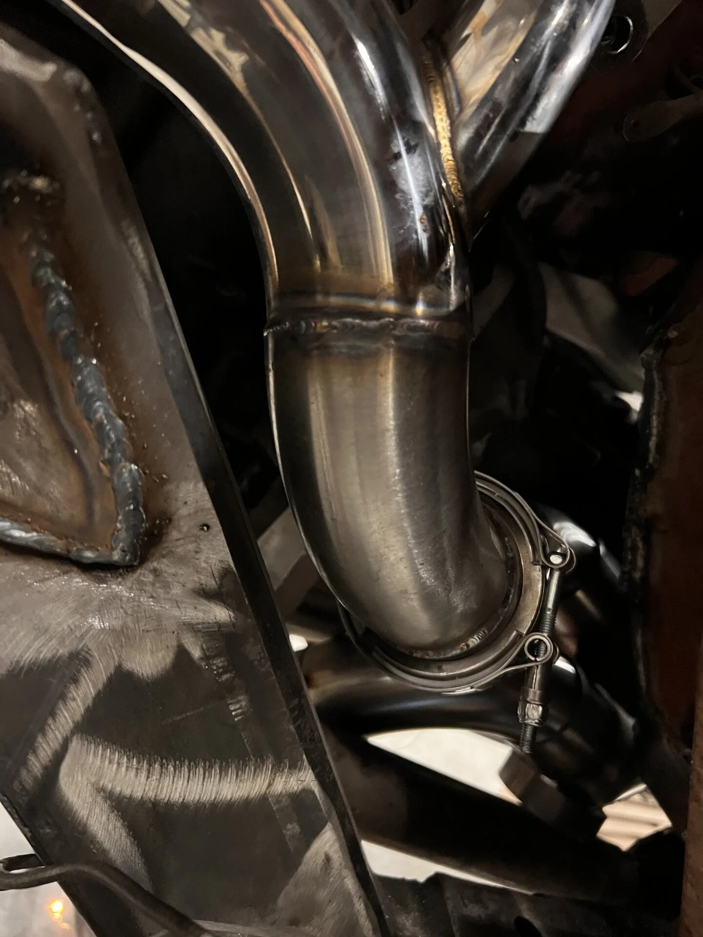

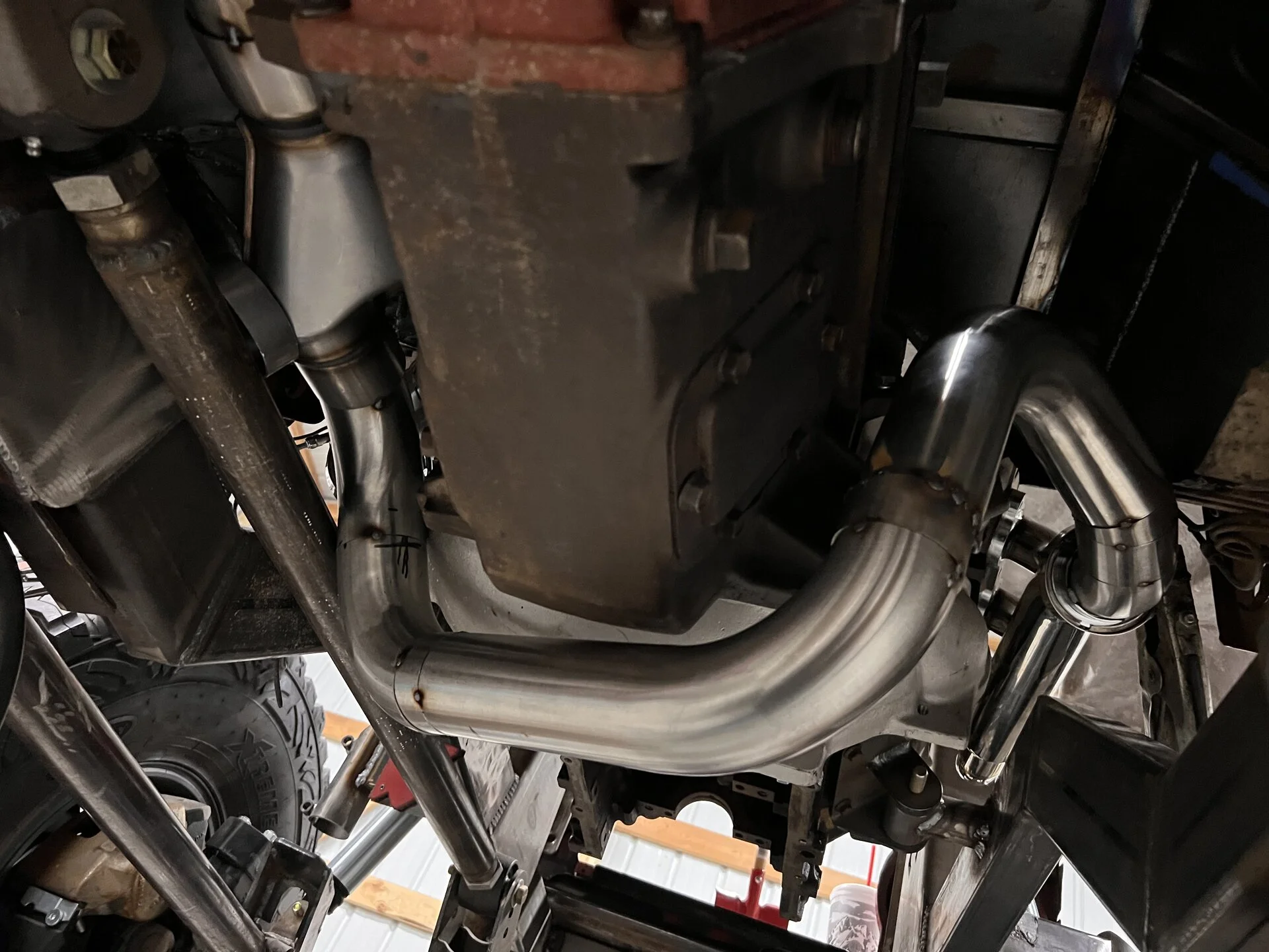

It looks like one of the track bars is REALLY close to the exhaust. Say it aint so.
