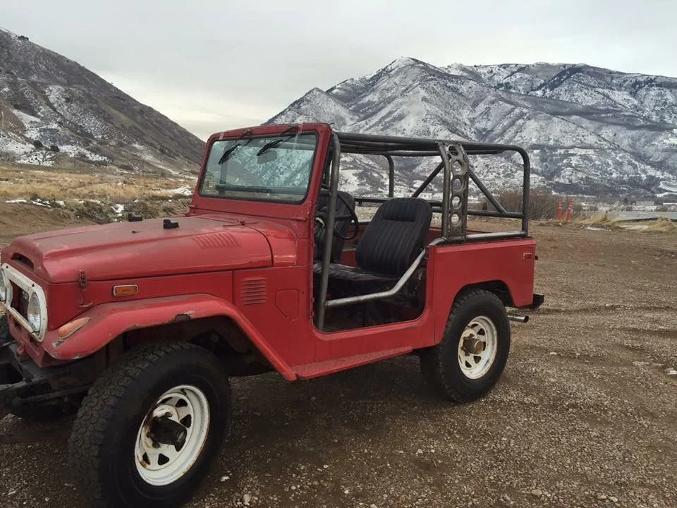

Hey folks, new guy here. I have been stealing info off this site for years thought I might as well try to contribute a bit and ask a few questions.
But to start here is what I’m working with:

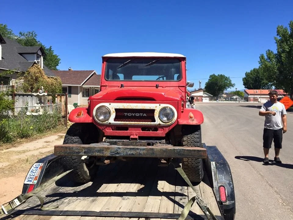

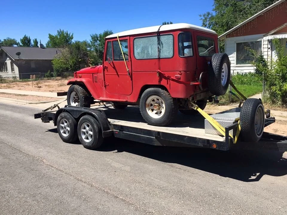

73 fj40 my uncle bought new and drove very hard up until about 10 years ago then he parked it in a field behind his house in Utah, it sat for 7 years then I called me to come get it and I’ve been playing with it for the last 3 years

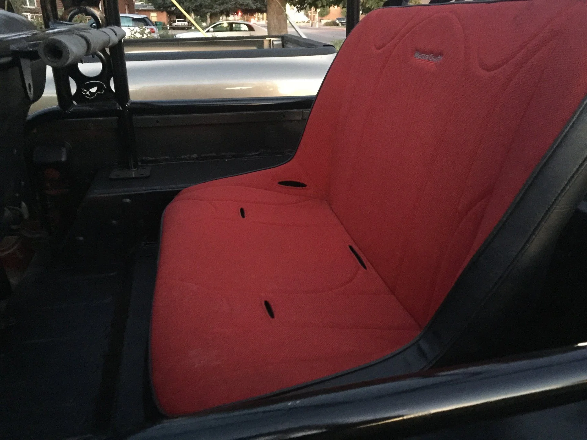

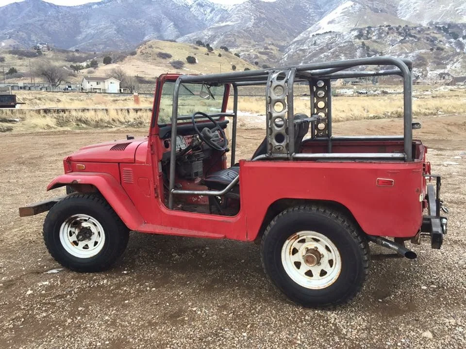

Interior is full of holes! Lol lots of rust no back seat. I’ll add some more pics in a few minutes. The fuel tank got cleaned out it’s and aftermarket between the frame rails for now

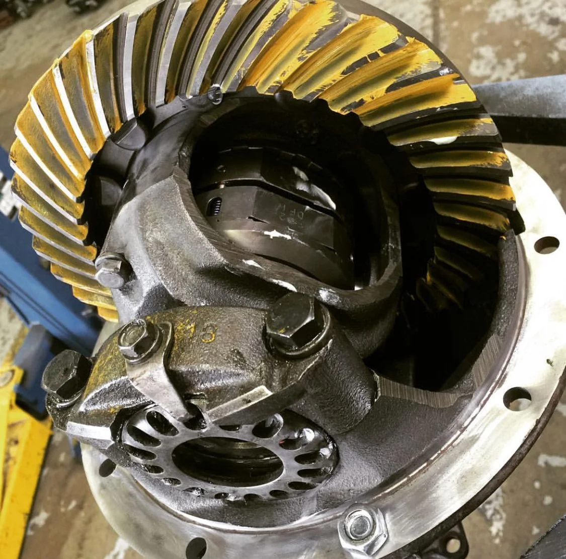

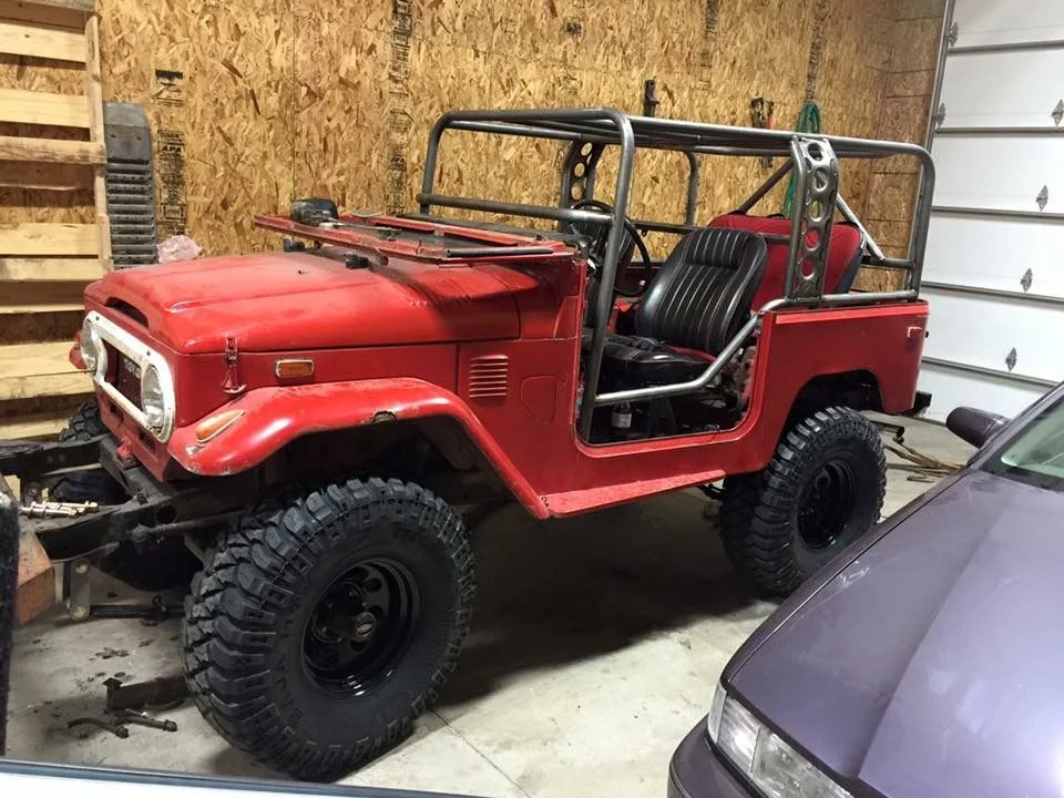

Then I got 5.29s chromolys and a lockrite in the front topped off with brand new hubs from Kurt at cruiser outfitters with the chromoly job gears. The rear got 5.29s and mini spool then I just started driving it as much as I could

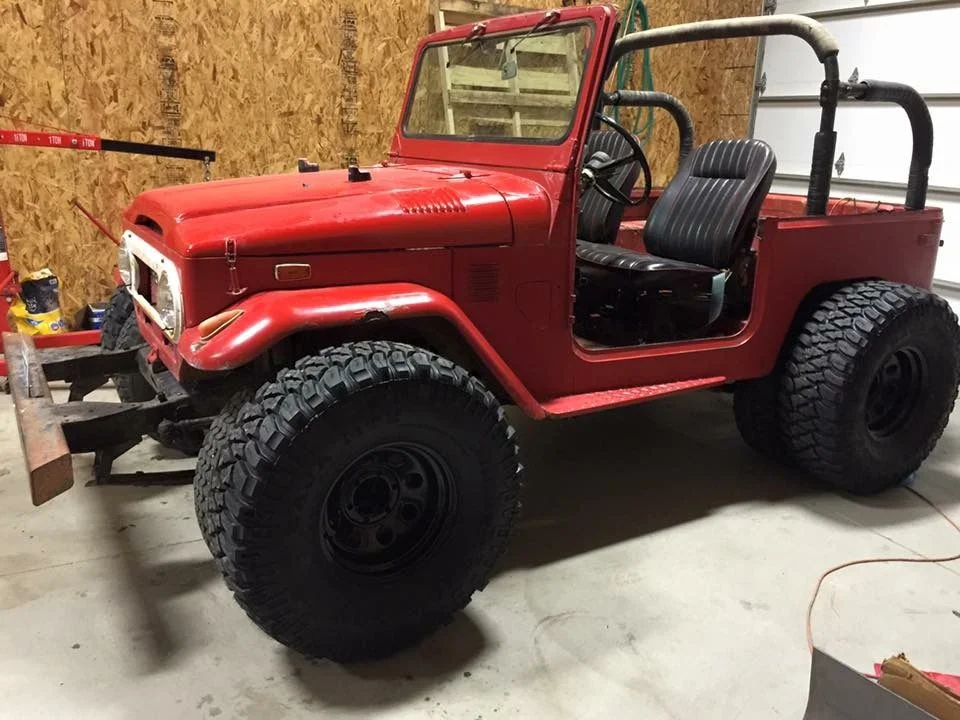

The motor runs “ok” but leaks like crazy, trans and transfer case also leak so that leads we to where I am now. I love my cruiser but with the stock style steering, these skyjacker springs and too tall of shackles it drives like sh#t. So I’m looking for knowledge and advice. I’m planning on pulling the LS6 out of my daily driver to go in my cruiser with a 4L60 adapted to the stock case but my concern my drive shaft. I’m gathering parts to do a spring over on stock fj60 springs and flipping the springs for longer wheel base.

Is it titled a 73 or 74? That is a 74 model. Front heater, TOYOTA emblem in the grill, roll bar and tail lights were all changes for 74.

So you have a plastic not metal front grill emblem and front heater with the vent at the top? Heater and emblem were there just changed for the 74 model. Also for 74 the F155 changed to improved oiling system. Curious of your A pillar stamped build date. 9/73 was when the 74 model year started. States titling them by build date verses what a manufacturer say what model year it is was common. By this time the owner's manual have the model year on them. Have a original owner's manual for my 73.
