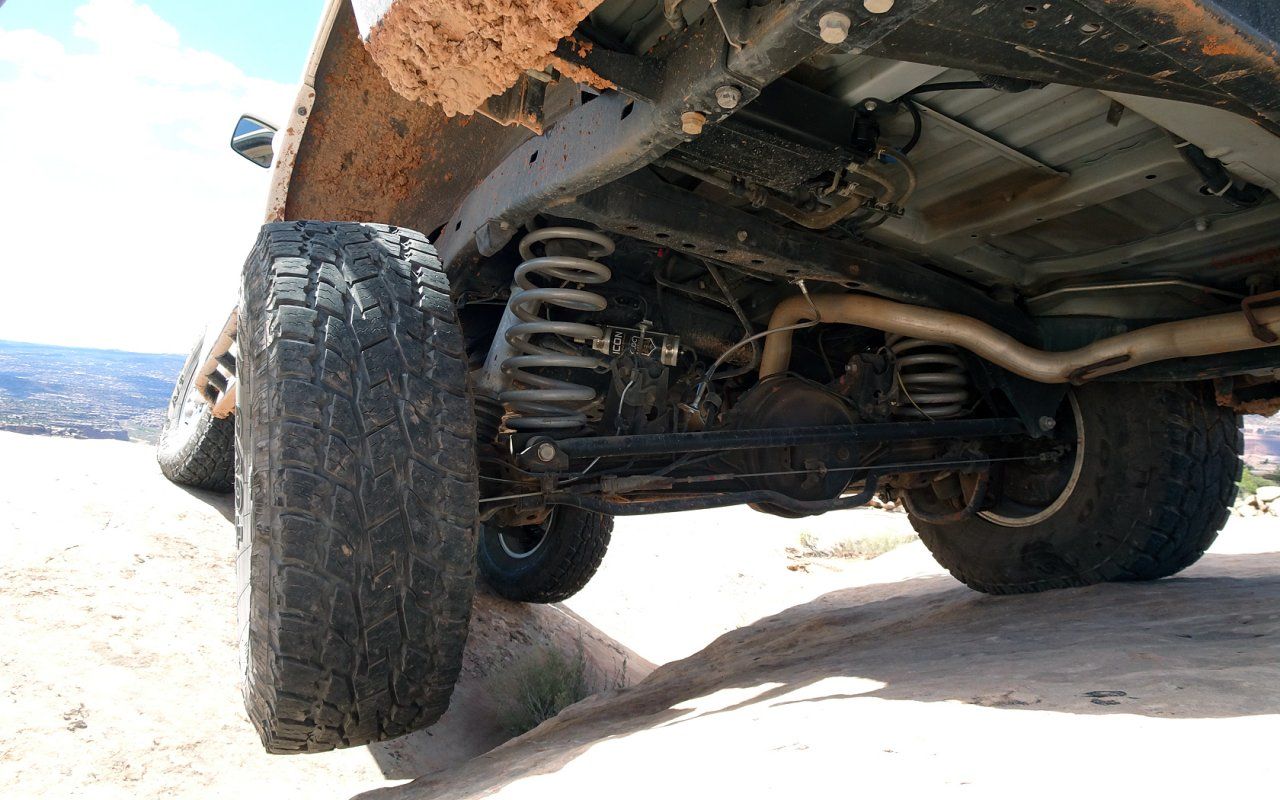

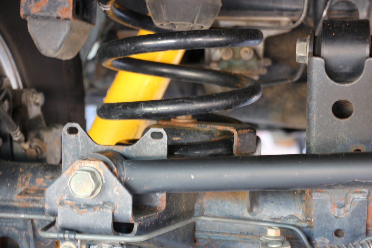

It your rear springs are that loose at full droop you will want to address it ASAP. In an emergency situation you can loose your spring and bad things can happen, I have seen it first hand. Super easy to address without need of special tools. If you go with the way I did it the hole is already in the lower perch add a bent piece of strap and you will be good to.

I'm loving the Icons. I really appreciated my Icons last weekend in Moab. Plush high speed control and nice cushy compliance on the rocks.
