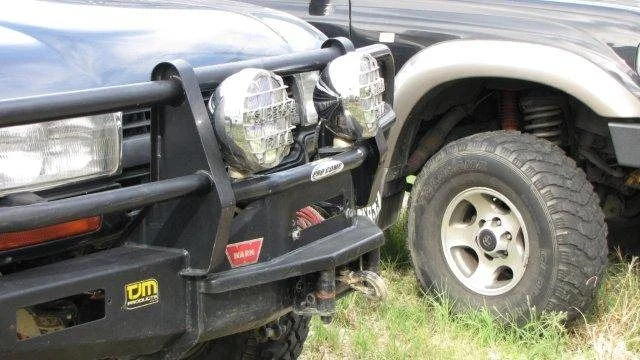

I've always thought these were neat winches, but I never knew you could modify them like that. With all of that winch line you could snatch block just about any pull and virtually never have to worry about weight. I'm keeping my eye out for a used one and I'd like to make it fit into the ARB on the 80. It blocks some of the radiator, but I've seen a few people do it.
Front & Rear Winch

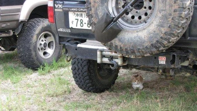

I would install a rear winch in my 80.
Mounted a Warn Military 9000 in the rear.
https://forum.ih8mud.com/winching-recovery/341179-warn-military-9000-wiring-questions.html
