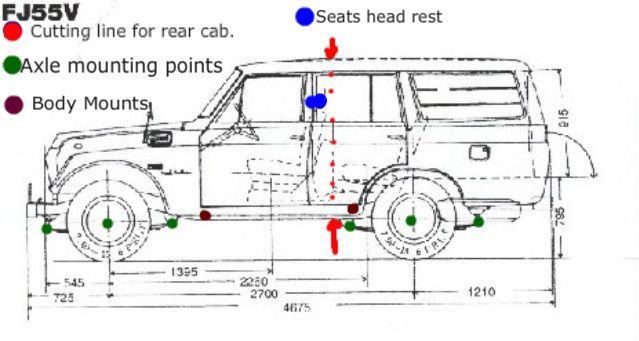

I need a truck. My 16 yo daughter wont drive a stick shift and so I would need to convert this over to an automatic transmission. If I did convert it over I need to come up with something that would work with the 6AT. Any suggestions? Because there are times she is going to have to drive me. The Ranger OD will be going away.
I will be converting this into a single cab pick up truck. I have a photo chop shop image I will try and post.
I like how you propose to keep the cabin and bed separate. NOW I have some tech for you here;) >give yourself MORE cab than I did...cut it at 15" aft of the leading edge of the Bpillar. I am 5'8" and have very little adjustability in my seats to allow big people to drive it...it is a good fit for me, but maybe not for a daddy long legs or some one whose rig will be driven by others or if there is potential for selling it in the future. you can shave it down a teensy bit more for more of a bed, but don't cut yourself short to start with;) ALSO importante* find the bulkhead location at both rear door rockers, figure out the vertical lines you want the rear to take, mark the bulkhead location at the gutter rails of both back door frames(back doors removed, all glass removed or cover with something that won't let welding berries thru...) burn in a lower and an upper and at least one diagonal brace at the bulkhead cut spots; use sacraficial angle iron, preferably straight to also use as straight edges for cutting. brace the rig at the floors and the gutter and then from floor to opposite gutter. figure out what kind of material you will use as Cpillars rear floor support/body mount channel, upper and depending on your design, a middle cross beam. fab the pillars first and provide for them to have enough leg to get thru to tie directly to the rocker beams you will install BEFORE any cutting happens. after you have your pillar somewhat figured out, you can extrapulate for the cross members and floor support. My floor support is a Z channel on the bottom of the pan and a piece of 2X on top of the pan, all clamped and welded together. I recommend getting the uprights and horizontals somewhat engineered so that once cutting starts, things can be test fit to fine tune placement. I recommend installing the rockers first AFTER bracing, then install floor support, THEN cut. then fit uprights and cross beams. then fill in the blanks;)
I think an FJ45 pick up rear non slider window is better than what I did(custom tempered and universal gasket) the 45 window is flat and can be cut but the best thing is the somewhat factory gasket that is available aftermarket weld in supports for fj60 retracting seat belts before you paint:doh: Doing a "style side bed" like you have shown is cool(aussie for factory as opposed to a tray or backie as I have;)) If you are really good and determined, you can fab it so the bulkhead is comprised mostly of a "hatch" that can be removed for when you have the camper shell on;). for this, build your supports around the perimeter and omit the middle cross beam. If you have seen my pics of the chop yet, you should check them out.

I do have another photo chop of the cabin cut at where the rear seat cushion starts.Thats about where the rear floor still remains somewhat flat but then rises up at an angle. Also I had to adjust the wheel base on that one another six inches for cosmetics but then again I can post both photo's after I find them.

not sure about the foreign transmission:D but I'd say be carefull moving the wheel in...my fingers have come in contact with the windshield under hard steering conditions, I opted to NOT attempt for this reason. but YMMV;) If I were to do it again, I would remove the windows complete from the back doors. gut the back doors, modify the window frame to omit the roll-up section completley, leaving the fixed glass with a frame on all 4 sides of it. weld the new skinny window to the leading edge of the back doors, butt up against the trailing edge of the Bpillar, use the windows angle to dictate the upper half of the bulkheads angle, cut the doors straight down from the door top to the rocker, or maybe even at an opposing angle to the upper half(very slight incline on the bottom half) build up the Cpillars to make the corners, then skin the rear panel. Someone suggested I use the tail gate guts and rear window to have a roll-up rear glass, but I opted not to due to the cost of the weatherstripping. just some ideas...

The seat all the way back and a little room left behind it thats about where I was looking to cut the floor and make the addition to the cab. Then I would need to cut and move the second set of body mounts and move then forward a little. You can see in the photo the blue dot is about where a mans head would be with the seat all the way back but not on the actual head rest. Well depending on how tall you are but its just for reference anyway. I will experiment on the length of the cab and see what it looks like. The axle can be moved back by relocation of the spring pin and having new main leafs made that are longer. Front hanger can stay and just relocate the rear hanger. You can see where the only body bushings are located for the cab of the truck.

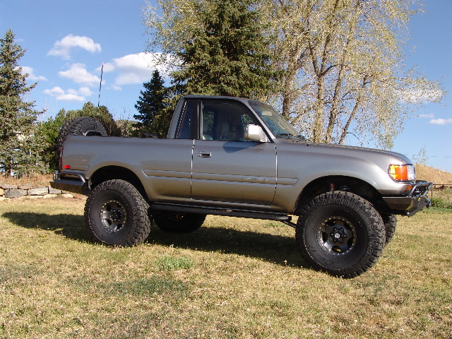

I always liked the way Christo did the cab on the 80 series he made a pickup, essentially using the rear door fixed window to give the cab more room. I think this is what Lambcrusher was suggesting, I do like the separated bed you are considering rather than fixed.

I think I have it measured about right. The bench seat is all the way back and then you have a little wiggle room. But not so much it looks goofy. I mean I want it to look like it came from the factory this way but also be functional. Lucky for me Im actually 5'8.5" and just weighed myself today at 198. The new medication mixtures they have me on has dropped my weight by fifty pounds since July. Im due for an increase in my dosage so hey maybe I will a wafer by years end. Reminds me of the Stephen King movie Thinner. :)
Guys one thing I was thinking about was modifying the steering column into a telescopic and maybe title steering. Also the rear axle is an easy adjustment so its not difficult to move back to make room for the cab. I like the tire on the side of the bed thats nice. There are earlier trucks that also have the tire up against the beds front bulkhead and receded somewhat into the bed so it sits facing flat against the back of the cab and shallow of the beds top.
