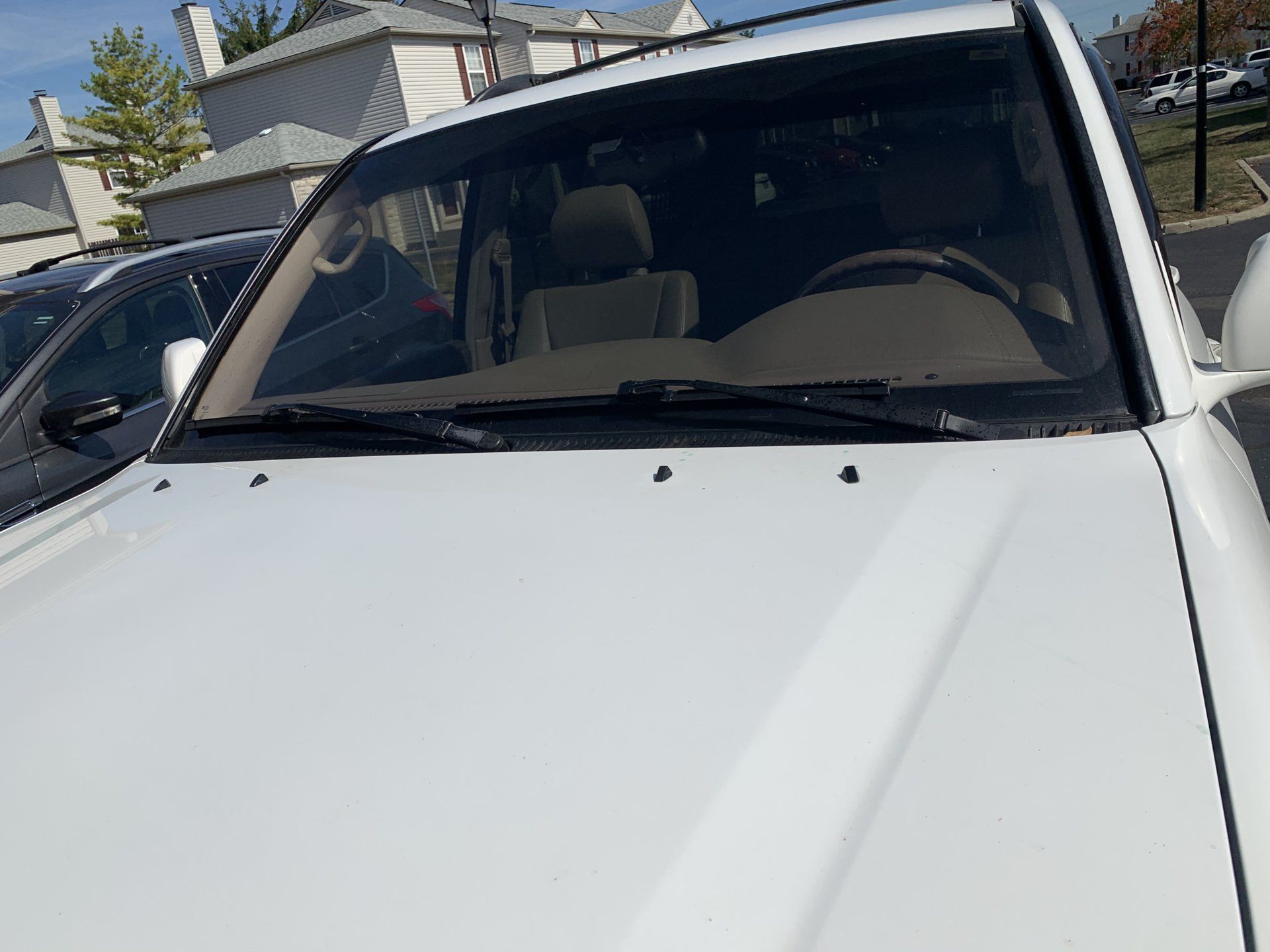

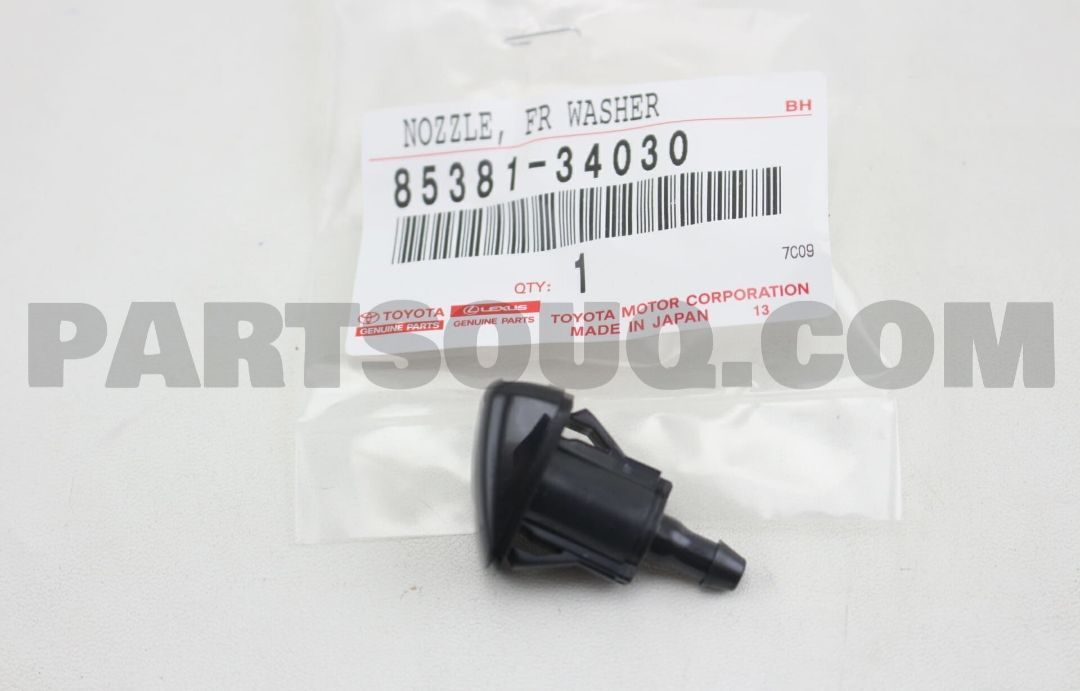

Here's a quick pic I took (it is dark outside so not the greatest picture) and a picture showing the nozzle itself from partsouq I will he changing the hoses over the weekend so I will try to take pics of this one and the original two stream type side by side so you guys can see the difference
Yeah I found those on ebay from Partsouq. Will probably place an order in the near future, think they are like $10ea with $12 shipping. But that seems pretty standard for them shipping wise.
You can find it on ebay for $11 with free shipping.
Don't think those are OEM/Genuine though... Looking at the pics of the ones that are on the OEM bag (my assumption) is that OEM have a straight tube attachment. Yours linked are 90* angled. Don't know if that is an issue with our hoods or not.
